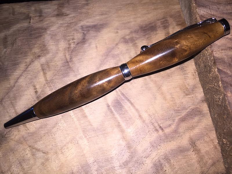

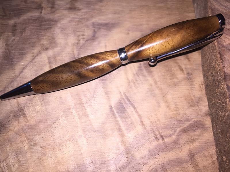

I know that slimlines are taboo around here, but I like how they put the focus on the blank instead of the pen parts. I was in Woodcraft for the first time the other day and bought a couple of pieces of figured walnut from a selection of short cutoffs. This is the first pen that I have turned from it. The background is the wood that I used.

Slimlines aren't taboo around here at all. In fact, they allow more opportunities for variation & creativity than most any other kit.
Those look really nice. Just one thing you might consider - when I want to make one with fairly meaty barrels like that, I generally use a comfort center band or make of my own about that size. To my way of thinking, that gives a little better proportions to the whole pen, but that's just me.
Did I miss something? When did Slimlines become 'taboo'??
Love Walnut, don't think it's used often enough. What did you use for a finish?
Scott ($100 kits should be taboo) B
Ok, maybe taboo was too strong of a word. I am new here and have been reading quite a bit. It seems like some people think that beautiful blanks are wasted on cheap kits. Maybe I am getting the wrong idea. It's really my only option right now and I have spent a lot of money getting into this hobby.
The finish is CA. Here's my process. Sand to 600. Clean with denatured alcohol. Then I clean again with CA accelerator. Next, I apply about ten coats of thin CA. I stopped using accelerator between coats and haven't looked back. It only takes about 10-15 seconds for each coat of thin to dry. I dribble the ca on the top of the spinning blank and spread it with a smooth viva paper towel strip. After the CA coats, I sand with 400 until there are no shiny spots. Then a quick 600 sand. Then wet sand with micro mesh to 12,000. Last, I sand the ends flush with a lathe setup and assemble.
The wood and the workmanship look good. I have to agree that the wasp-waist just does nothing for me, but that's just personal preference. I second the suggestion on going with the Comfort center band--for an extra .50 it makes a much nicer pen (again, IMHO). Keep up the good work!

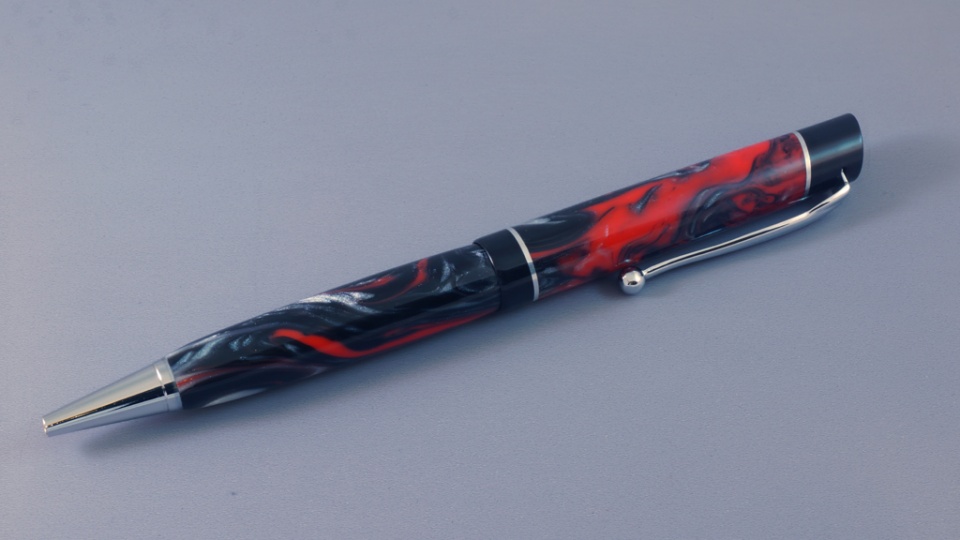

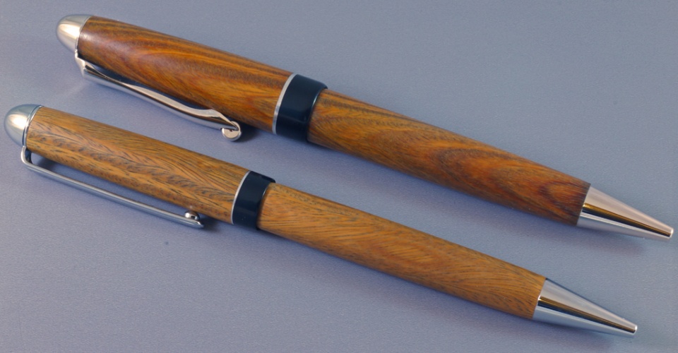

I turn mine between centers. But I make them look more like Euros with the centerband thicker than the barrel below. You don't have to use bushings except for the barrel that meets the nib. Or at least you don't have to turn all the way to the bushings.
Here are a couple favorites of mine.
The red and black one is one I did for a local PITH challenge.
The other 2 are a set made from Lignum Vitae. The smaller is a euro that I prefer over the slimline. But it can be done the same way with a slimline. It's my everyday carry pen. It has no finish at all. Just sanded to 600 or 1000 (I don't remember).

I have seen the clip "built in" to the top of the pen before, but have not seen an explanation of how to do it. Can you provide a link? It looks interesting.
The other two are sharp too. Does the center band actually fit over the bottom of the pen? Very nice.
Check out the library, there are a lot of great tutorials on modifying slimline pens. There is one on how to setup a clip with a similar look to that one. http://content.penturners.org/library/pens/challenge_pen.pdf
Yes, the centerband has a recess cut so it fits slightly over the bottom. You can do this with a drill bit, or using the point of a skew to cut the recess. Makes it much cleaner looking.
I should have looked at the tutorial mike mentions above. That's not how I did mine. I did mine similar to this one:http://content.penturners.org/library/techniques/invisibleclipforjremperor.pdf
