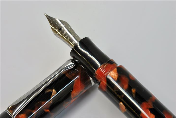

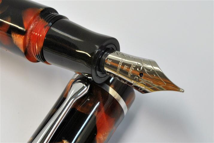

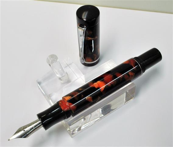

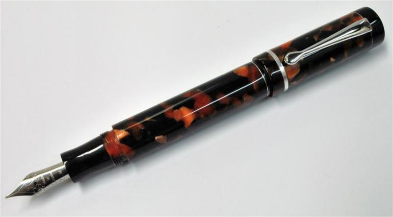

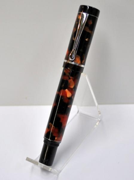

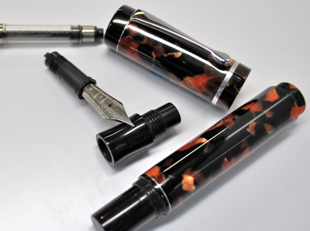

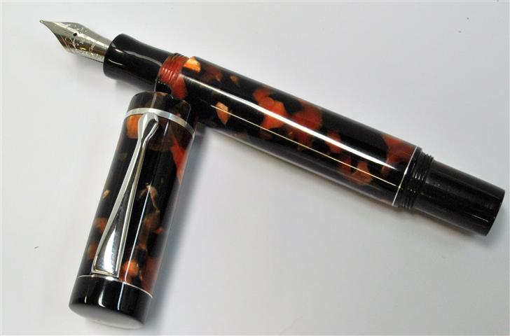

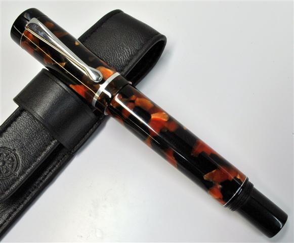

Back in the spring or early summer I made a pen with an imported acrylic called "Fiery Flows" from Exotic Blanks. I've been wanting to do another with this gorgeous material. I think you'll agree, it's well named--reminds me of a lava flow at night. So here's one of my favorite acrylics on one of my favorite styles, the Duofold.
The bands are aluminum. I now have silver, but I'm procrastinating for a number of reasons. Silver is much more difficult to punch with the die cutters, and if course it's expensive. My feeling is that silver will tarnish as readily as aluminum and both can be quickly shined up with a jewelry polishing cloth. And of course there's a weight savings with aluminum.
Overall length 5 1/4" (134 mm)
Cap posted 6 1/4" (158 mm)
Without cap 5" (126 mm)
Cap diameter 17 mm
Barrel diameter 15.5 mm
Section diameter 12.8 mm
Weight 27 gm

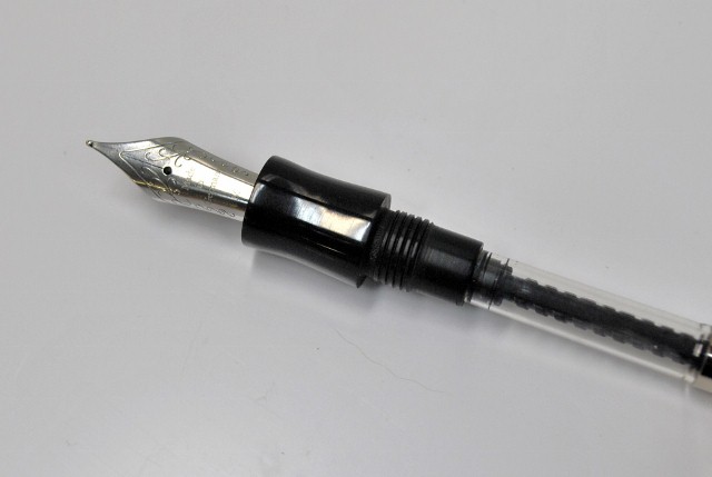

Cartridge/converter filling
#6 polished steel Meisternib
Thanks for looking.
