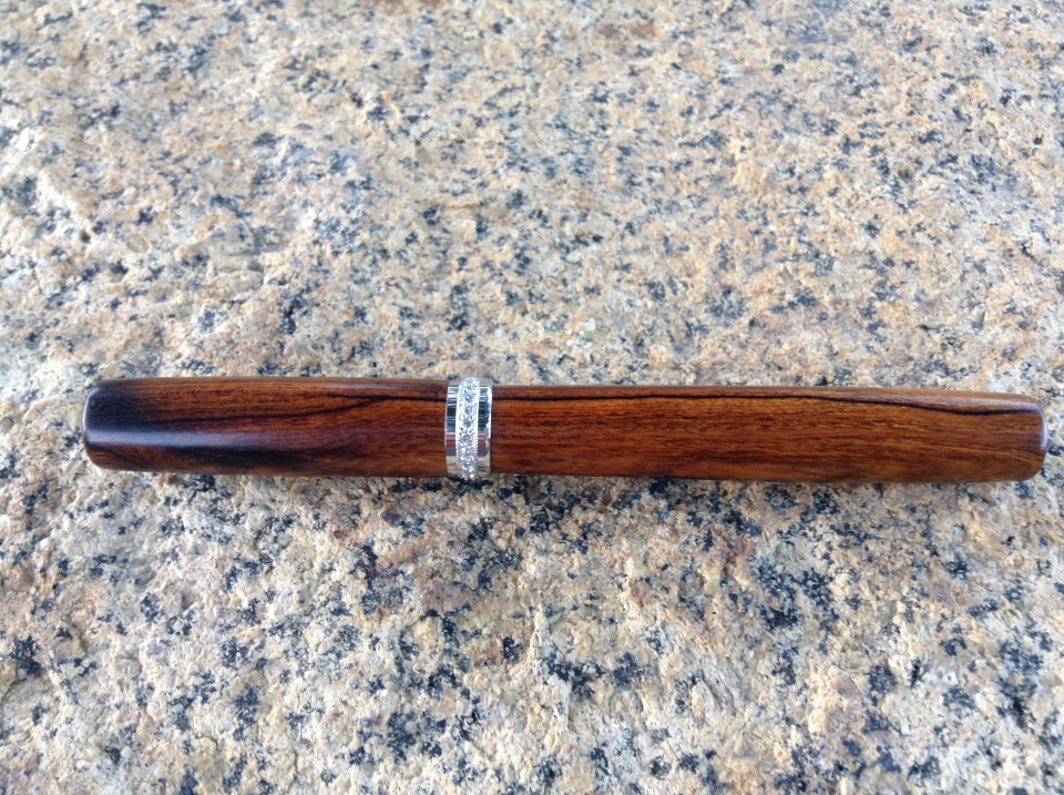

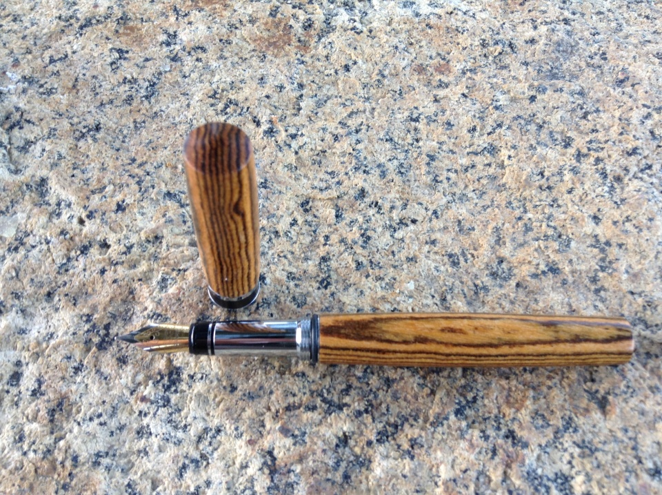

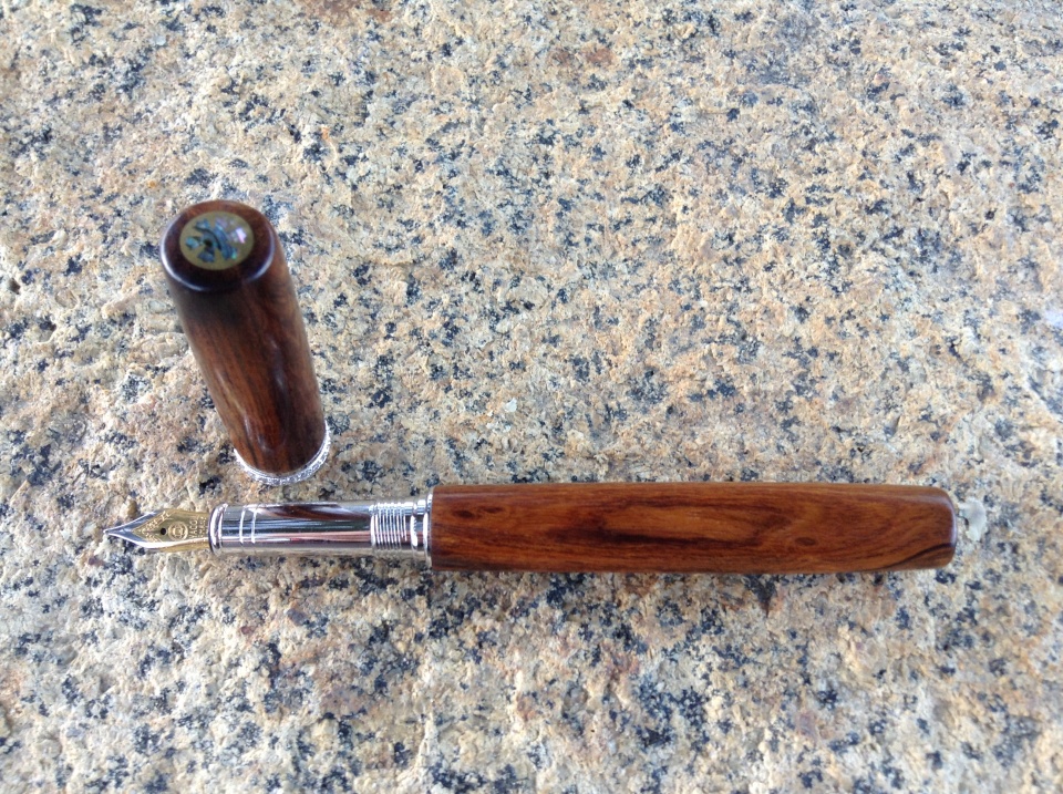

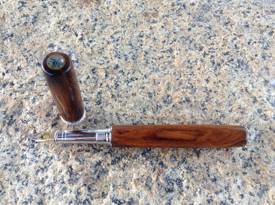

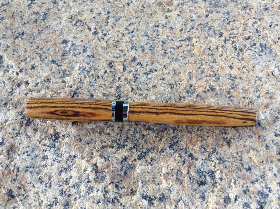

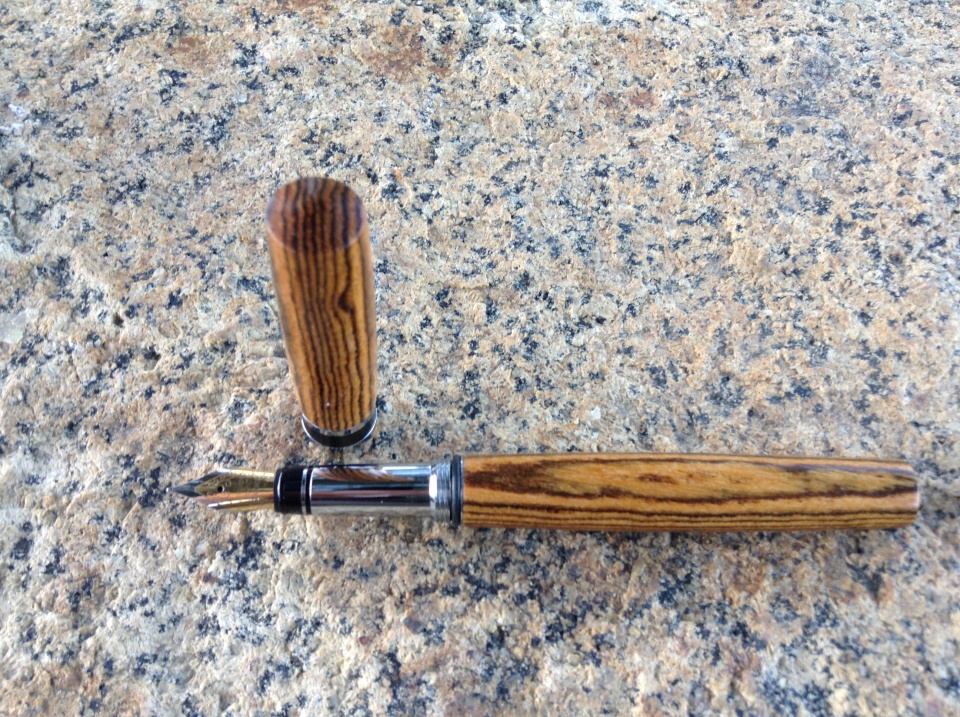

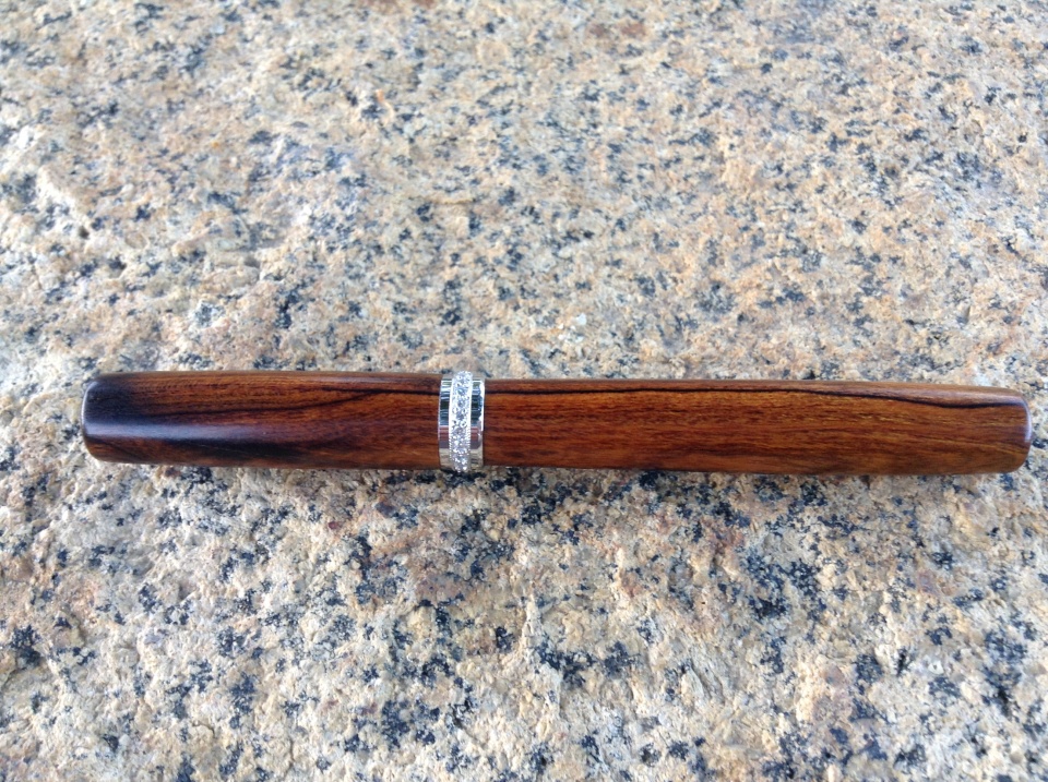

A few double closed end pens from the last two weeks.

Beautiful work !!!! . What did you use to make the cabochon on the cap end of the first ?
The finishes are very nice !!
Inlay is abalone, purchased on Ebay. Drilled out a hole a little bigger than the inlay, and filled the gaps with brass powder. The pens were turned .010 over the required size, soaked with CA and the sanded down to the right size. After that they were sanded to 1500 grit and buffed.
