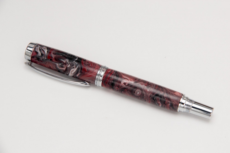

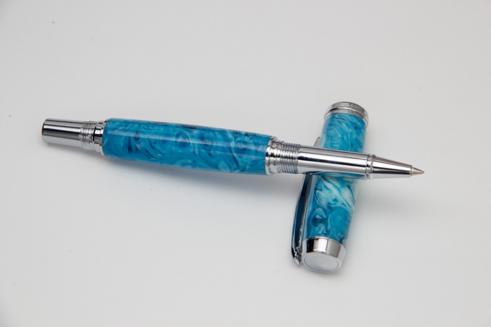

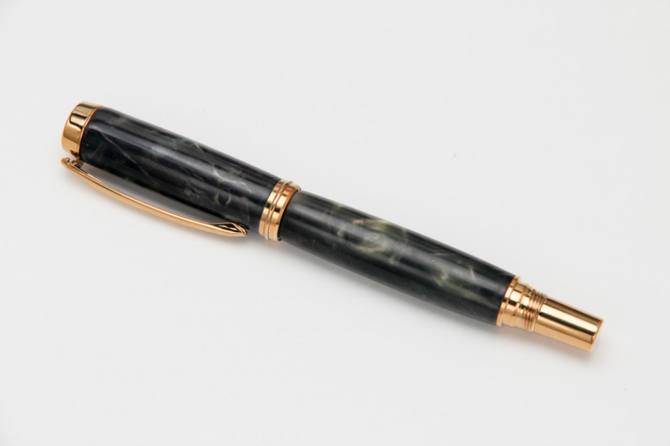

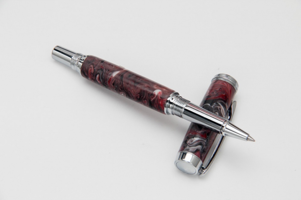

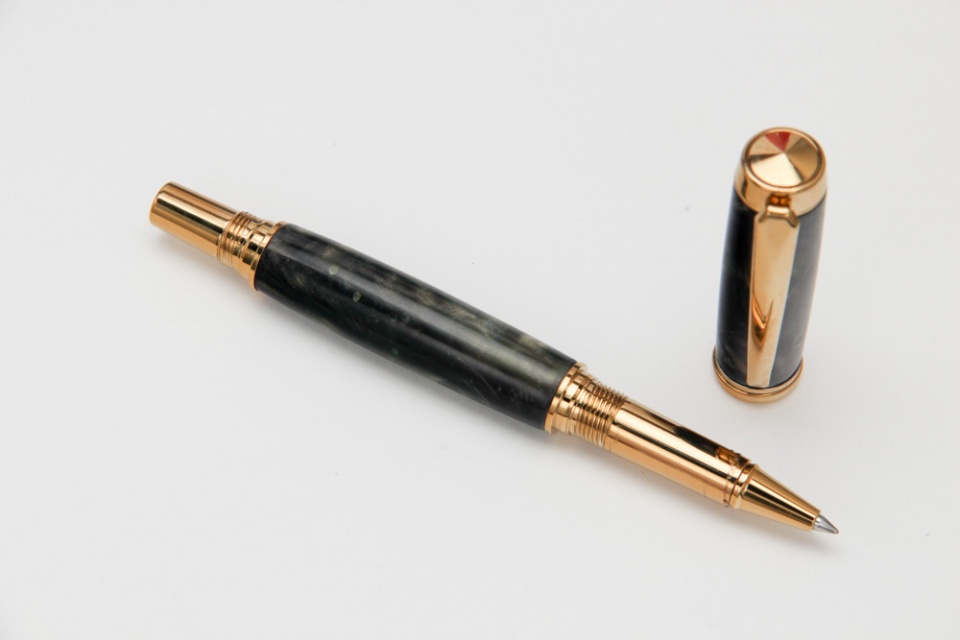

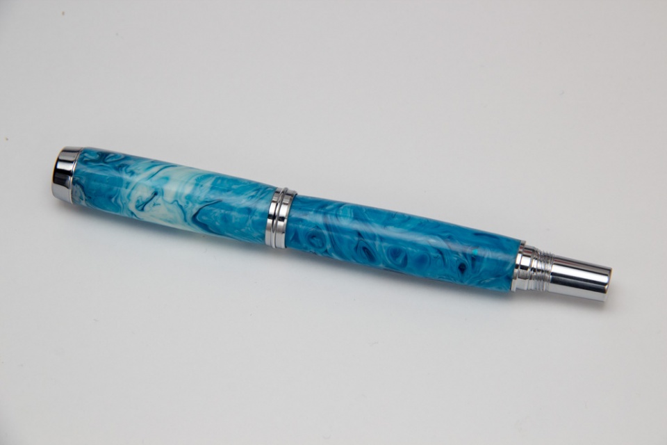

First blanks to come out of some melamine molds. It's nice having 5 blanks instead of the 1-2 I make when I use PVC. (don't want to deal with 20 pvc tubes...)

I poured the red one a bit too soon, so between that and trying to create the swirls in the mold I lost some of the color separation.

They are the same as the flat cutting board molds, but with melamine boards instead of HDPE. Think of cheap white cabinets / shelves with the "plastic" coating to them. I had an old shelf laying around that I cut up.
The pigments the Casting Craft dyes that I picked up at Michael's. The green one is pearl-ex powder, and I think i added some green alumilite dye because I didn't have enough pearlex to get it right.
