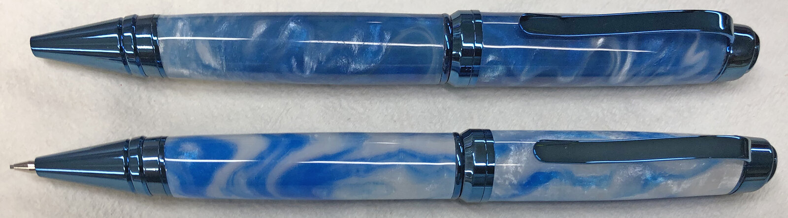

I have made several pencils, usually as part of a pen and pencil set. My preference is a good quality pen with a click (first preference) or twist (second preference) that uses a standard Parker style ink refill. For the pencil, I simply replace the ink refill with a Schmidt DSM 2006 (plastic) or Schmidt DSM 2007 (metal) Pen/Pencil refill in the 0.7 lead size. That way I am not limited to a dedicated pencil kit and can match up a pen and pencil style without being limited to only those that have a matching dedicated pencil kit. They usually cost about $5 (Ed and Dawn carry them on Exotic Blanks).
Although the twist style works OK, I find the click mechanism to be more intuitive for pencil use. The other benefit is that I can quickly change an existing pen into a pencil for someone if I need to. (For Cigar kits I also prefer the "single twist" transmission over the "double action twist" when it comes to pencils as the double action makes the pencil operation a little more cumbersome - in my opinion that is).
For example, here are a couple of Cigar kits that I made into a Pen and Pencil set using a Rhino "Blue Sky" blank and a Blue Titanium kit.
