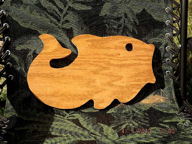

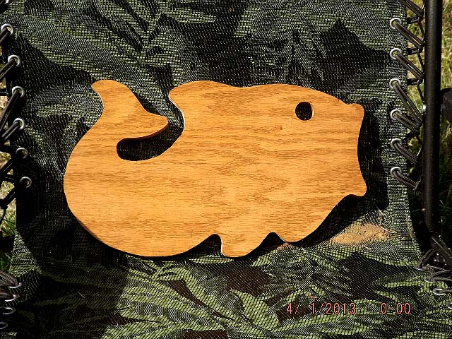

I cut out a fish shaped one on the scroll saw. I like it. It was a pattern I found in Ward's old shop in the house we were staying at in Sequim. I also have a couple I found at yard sales and refinished them. One of them I use here in the apartment for my casting and the other one I haven't used in a while. Here is a picture of the fish one I cut out. Enjoy.. Fay

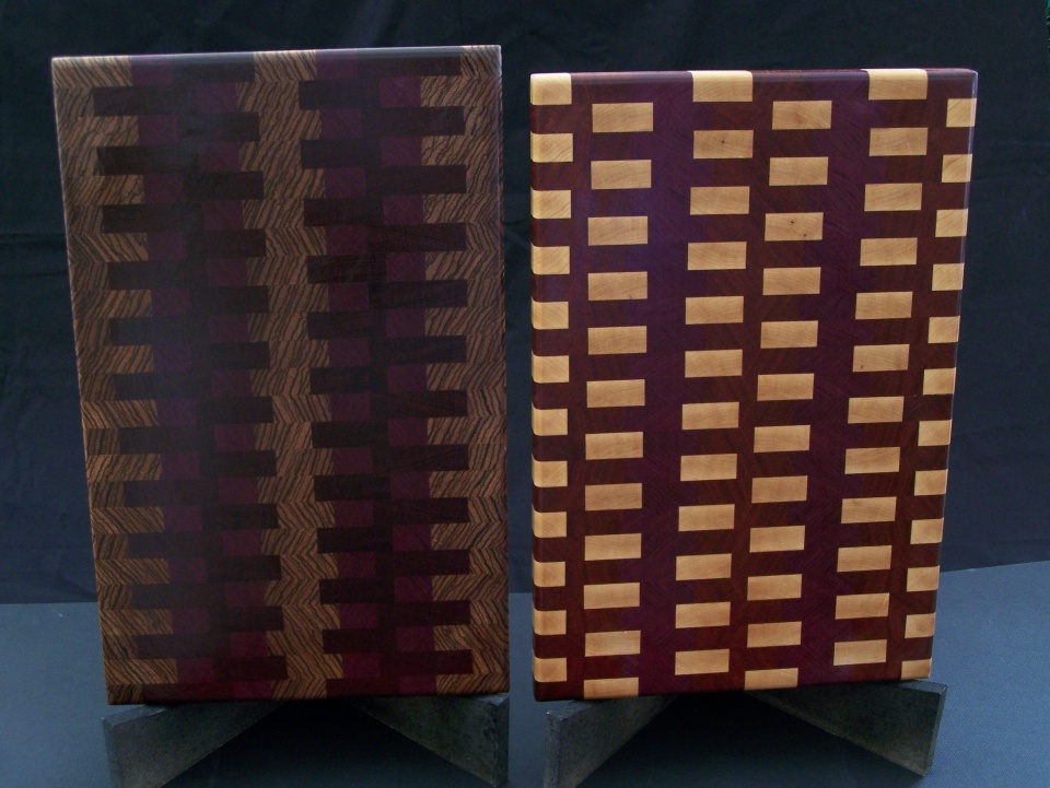

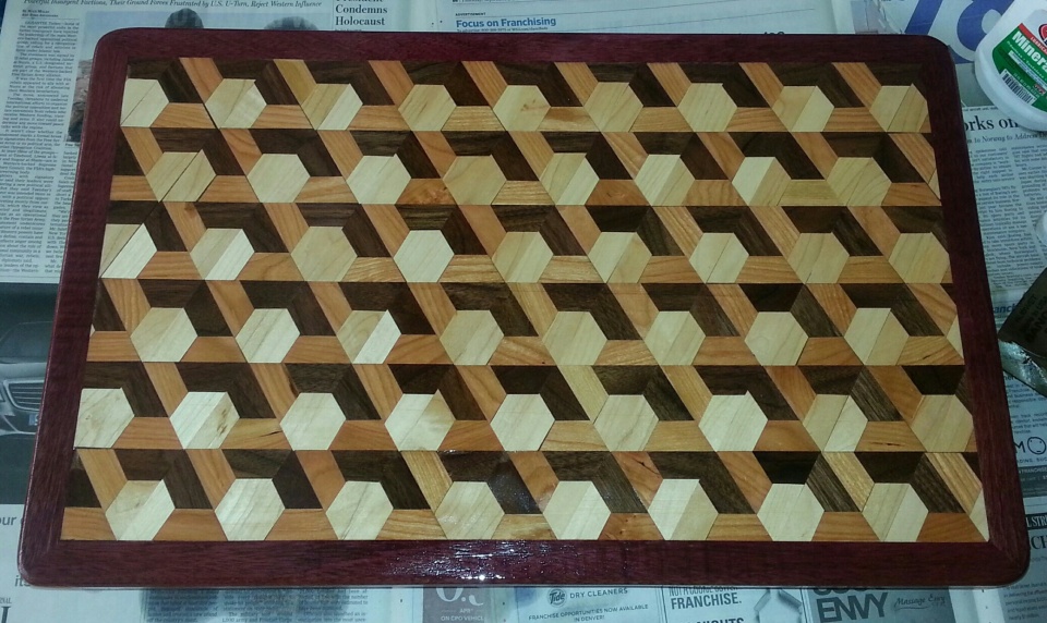

Wood magazine had an article a few years ago on how to make these end grain cutting boards. You can get some interesting designs.

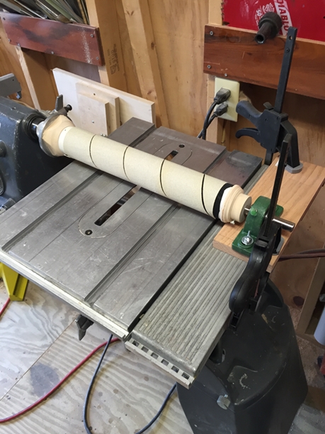

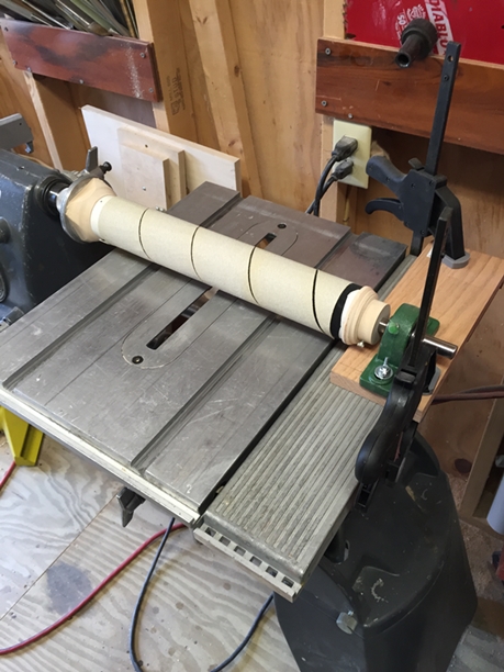

I made this thickness sander for my Shopsmith from PVC pipe just for cutting boards. Used faceplate to make an insert for one end and an insert with bearing on the other. Velrco adhesive strip and sandpaper was the most expensive part. Use 80 - 100 grit paper. Similar plans/ideas available on the internet for table saws or lathes as the power. To my surprise, this worked really well.
attachment.php
Planers are not a good idea for end grain.
