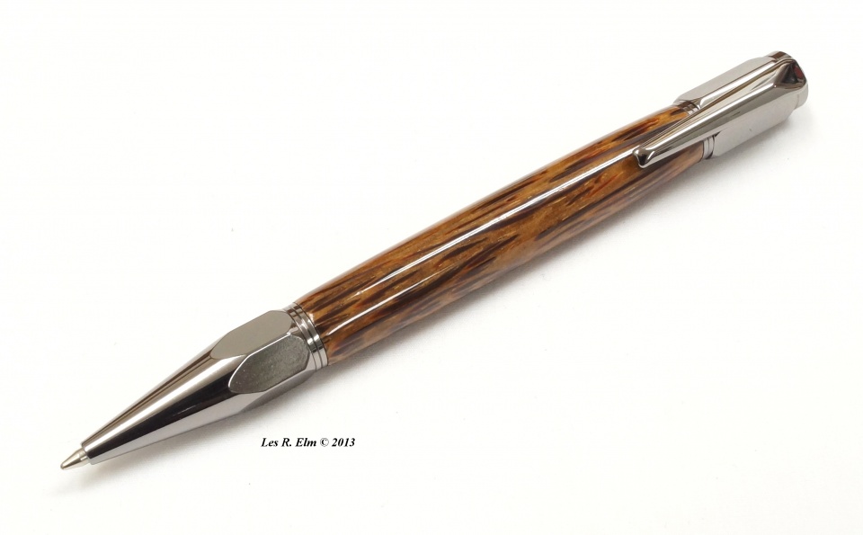

MINWAX WBOM Clear Gloss Polyurethane.
Les
