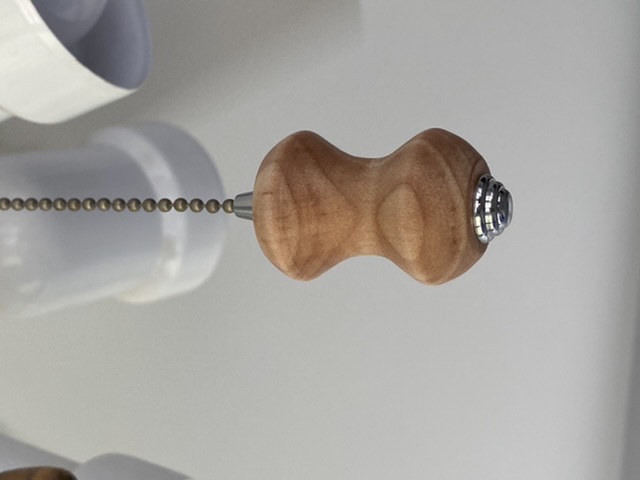

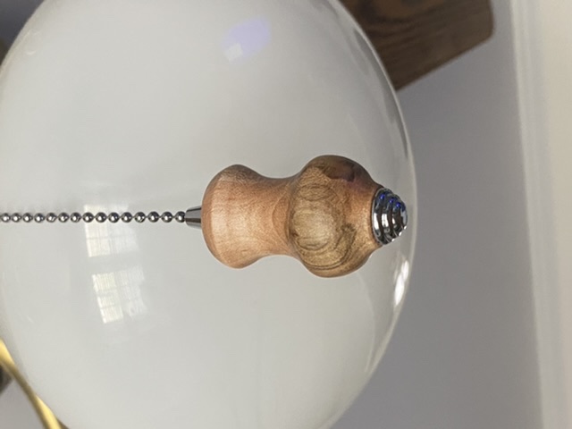

Found the old style fan pull kits on clearance and bought a few...was a fun project...both are Ambrosia Maple...

Beautiful wood for those. Many times I don't want to spend several hours in my shop and fast, fun projects like these provide some satisfaction while building skill, even if just a little bit at a time.
