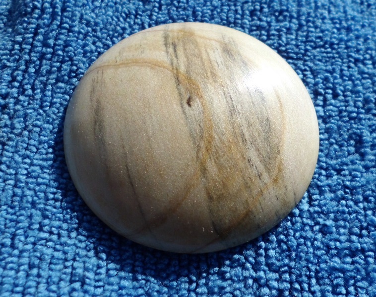

Well, I went ahead and bought that bowl blank through Ebay that I listed in my post ...
Fair warning, it was DRIPPING WET inside the package, and there was a little bit of mold that had started to grow on one edge ... I do like spalting, though, so that's fine, but the wetness??
I grabbed my Harbor Freight moisture content reader and as inaccurate as many people may believe it to be, it reads 19% for the "top" of the blank and 40% for the bottom, 30% in the middle. This thing was cut green and couldn't have been sitting on a shelf for more than a week! lol
I cut a small slice off one side and I'm turning it into a cabochon, just to get a feel for working this piece of wood. No idea what I'll do with the medallion once it's finished, though ... probably make a nice little decoration, though?

Well, if that's the consensus, then the only thing we can do is get our hands on some other Sequoia wood and tell people it's at least the same species ... and they can go see the fallen giant where it laid down in the woods! :)
I'm gonna have to dry some of this out and see how it turns.
attachment.php
It was very wet, kinda stringy ... had to start sanding with 120 grit to smooth it out, as it really tended to tear quite a bit - probably because it was soaking wet!
I sanded it up to 1000 grit, dry (though the wood was pretty wet, gummed up the paper pretty fast), then finished with Minwax, one coat of CA, (no sanding or micromesh whatsoever) Plast-X, and Turtle Wax.
Anyway, the picture and video I took simply don't do this wood justice ... cant see the chatoyance or the whitebait that is present in the wood surface anywhere ... (don't ask for the video, it's deleted). It's gorgeous, for a softwood ... though I do prefer the look of Eastern Redwood Cedar (aromatic cedar).
