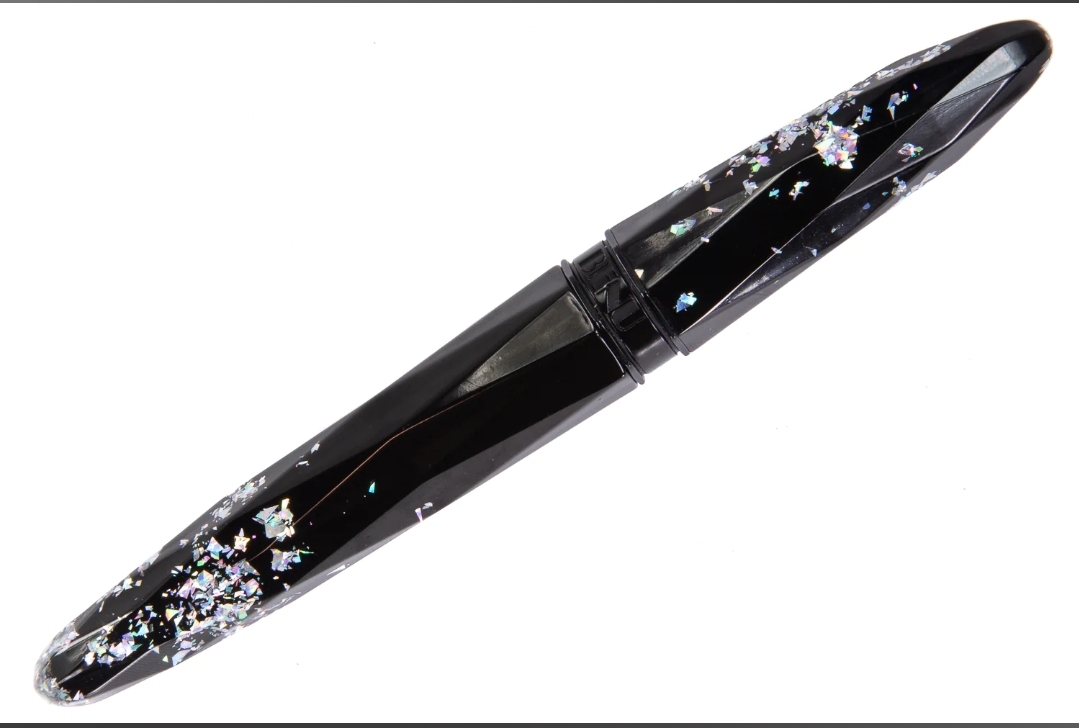

I've always liked the idea of adding facets to give a play of light and sparkle to the pen, but wasn't sure if there was a jig or tool that would help get the angles consistent to make it look nice?
Any ideas/thoughts would be helpful.
I've placed an example screenshot of a BENU pen below.

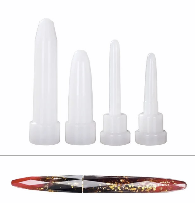

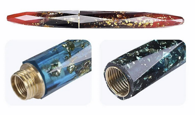

I'm fairly positive that Benu pen is made with a mold you can get on Aliexpress for like $4 and inserts for $2.50...
View attachment 366617View attachment 366622
Obviously Benu has some different hardware, but the overall resemblance is uncanny.
Actually pretty ingenious.
