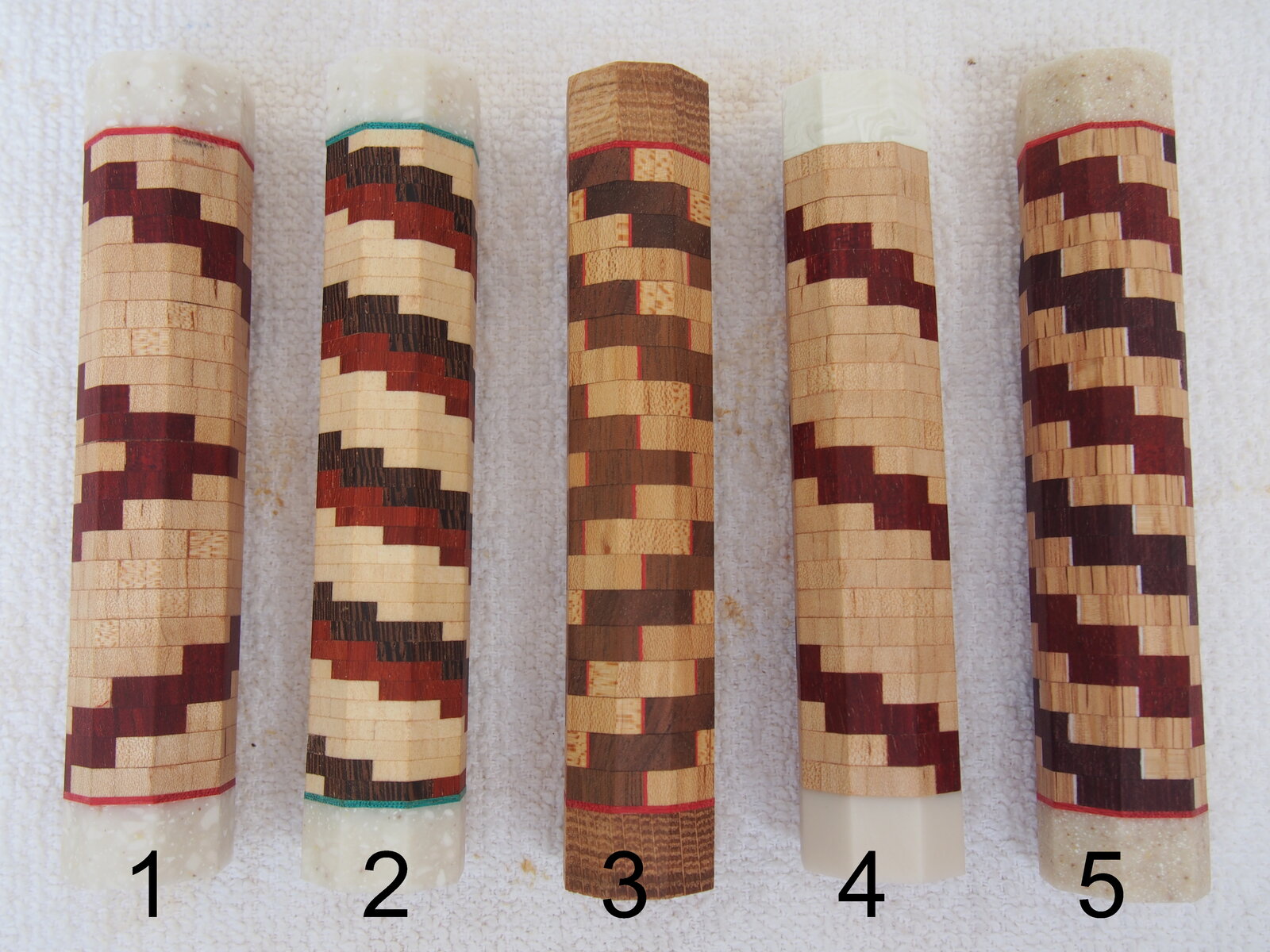

If you like segmented pen blanks , I make a design where the finished blank turns out to be 8 sided ( octagon ) shape . A few examples below in the pictures. They are available from www.exoticblanks.com
