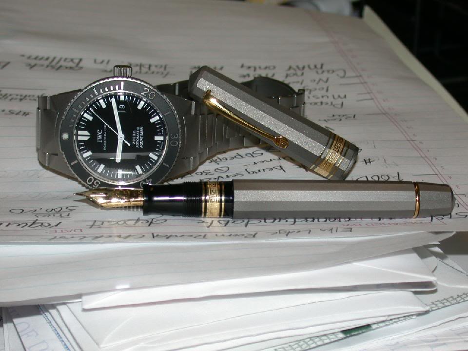

If I would be bold to ask, to make an aluminium pen body for an existing 3776 section with nib like the one in the picture, would $100-150 be sufficient?
I think this will resolve my issue whether I could get it done or I have to postpone it.

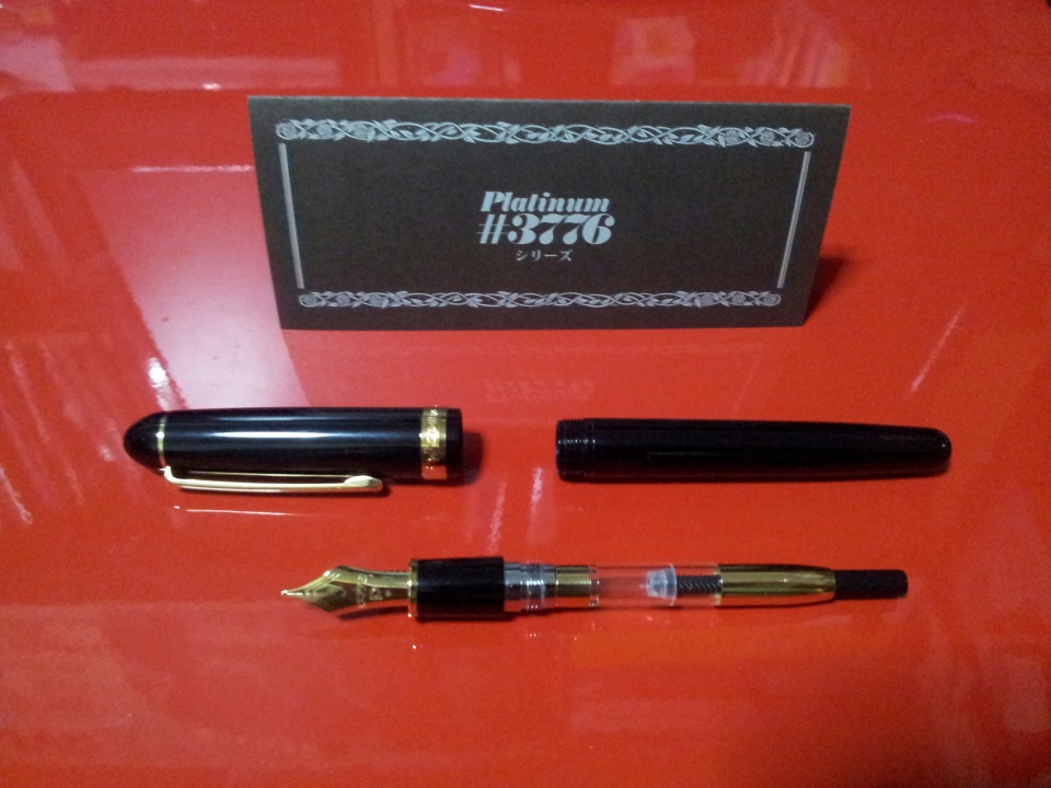

Do you happen to know the thread size and Pitch on the front section or how its attached?
Azrael
Jan 10, 2014
13
Singapore
You mean the cap? or do you mean the barrel?
If it's the barrel, I am told that it is a 10 x .75 thread.

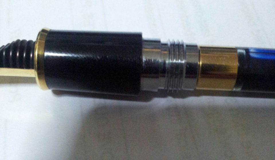

I attached some pictures. Not sure if it helps.
