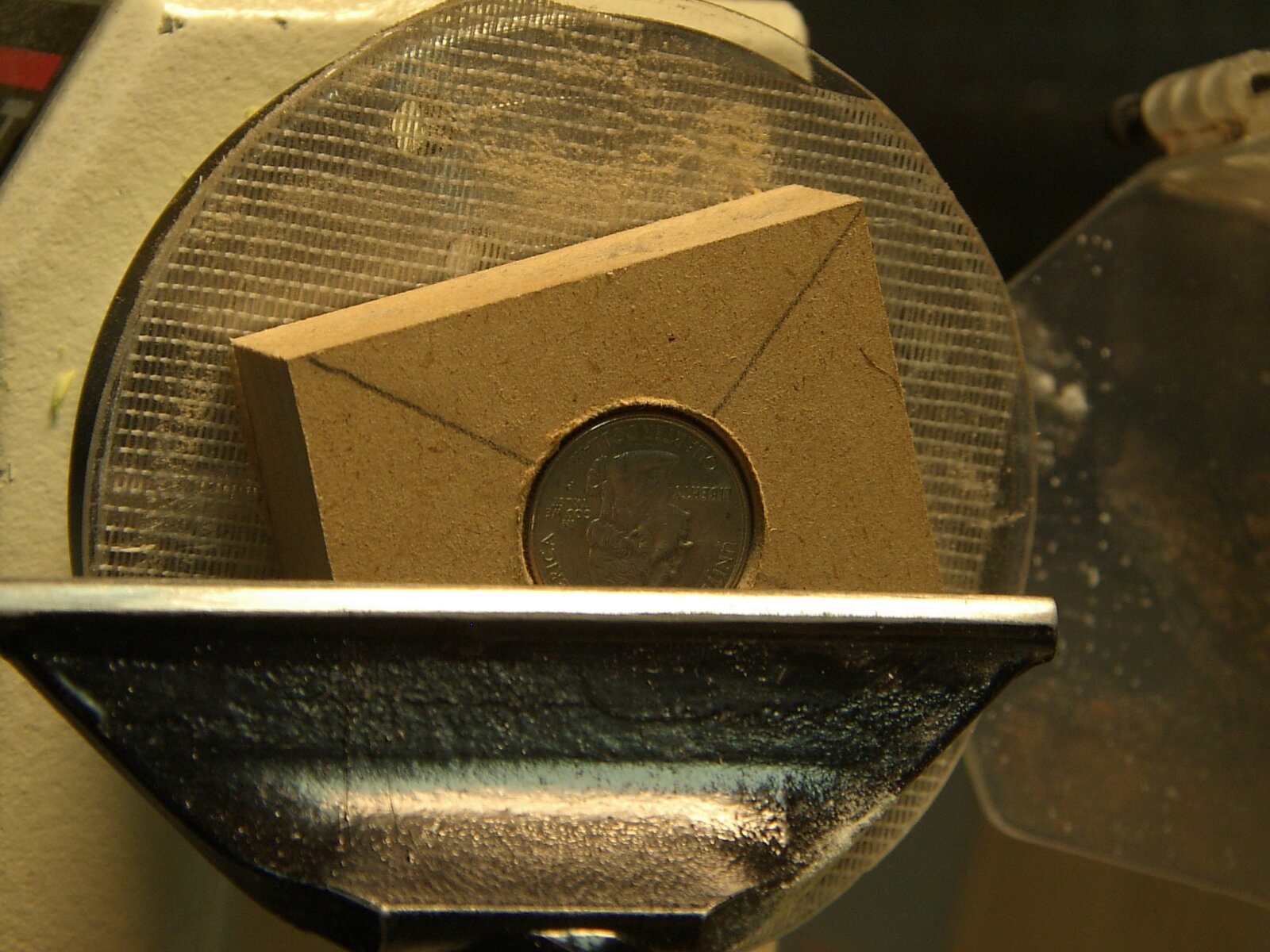

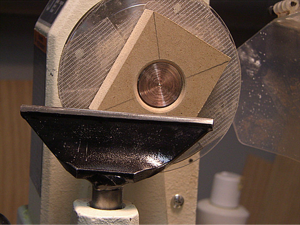

As you can see I used a piece of acrylic with double sided tape years ago. I have since switched to a piece of metal. Whatever you use it has to be true in that the thickness needs to be exact. Thus metals. Others may use wood. Then I use sticky back sandpaper for my sanding needs and just move the sand paper around to get full use of entire piece. Waste not want not as they say.
By the way this little project was for another challenge I had with another member here about thinning a quarter. I showed him I could do it 2 different ways. Turning and also cutting down the middle on my scrollsaw.

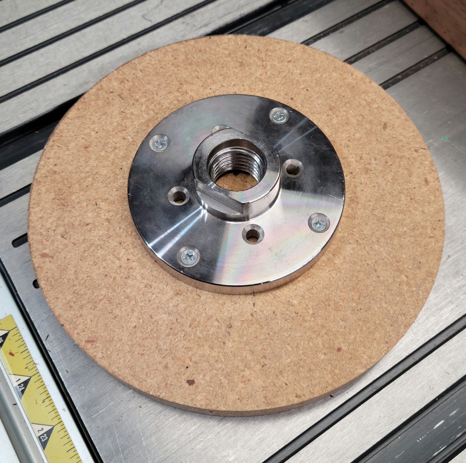

I believe I am overthinking this. I have a faceplate to attach a piece of plywood or MDF to. I will try that and see how it works.

I also use MDF, with a melamine laminate surface. MDF is pretty darn flat. I cut it round on my table saw (using a jig) and I screwed it to my faceplate, and use Pressure Sensitive 80 grit sanding discs. works perfectly.

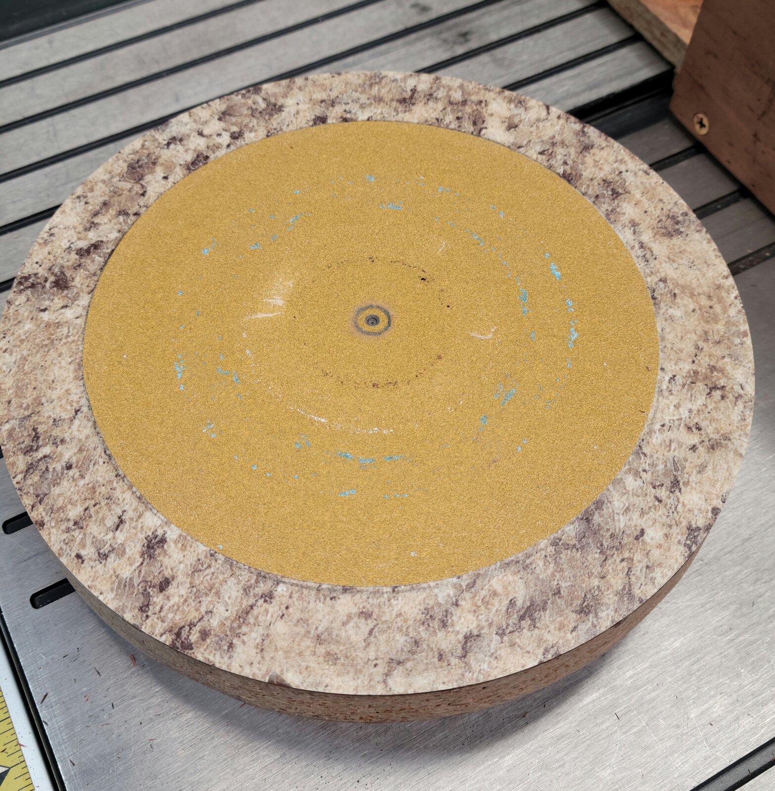

Sounds like I need to try the hook and loop, but currently I use a piece of MDF/formica from a sink cutout with PSA discs

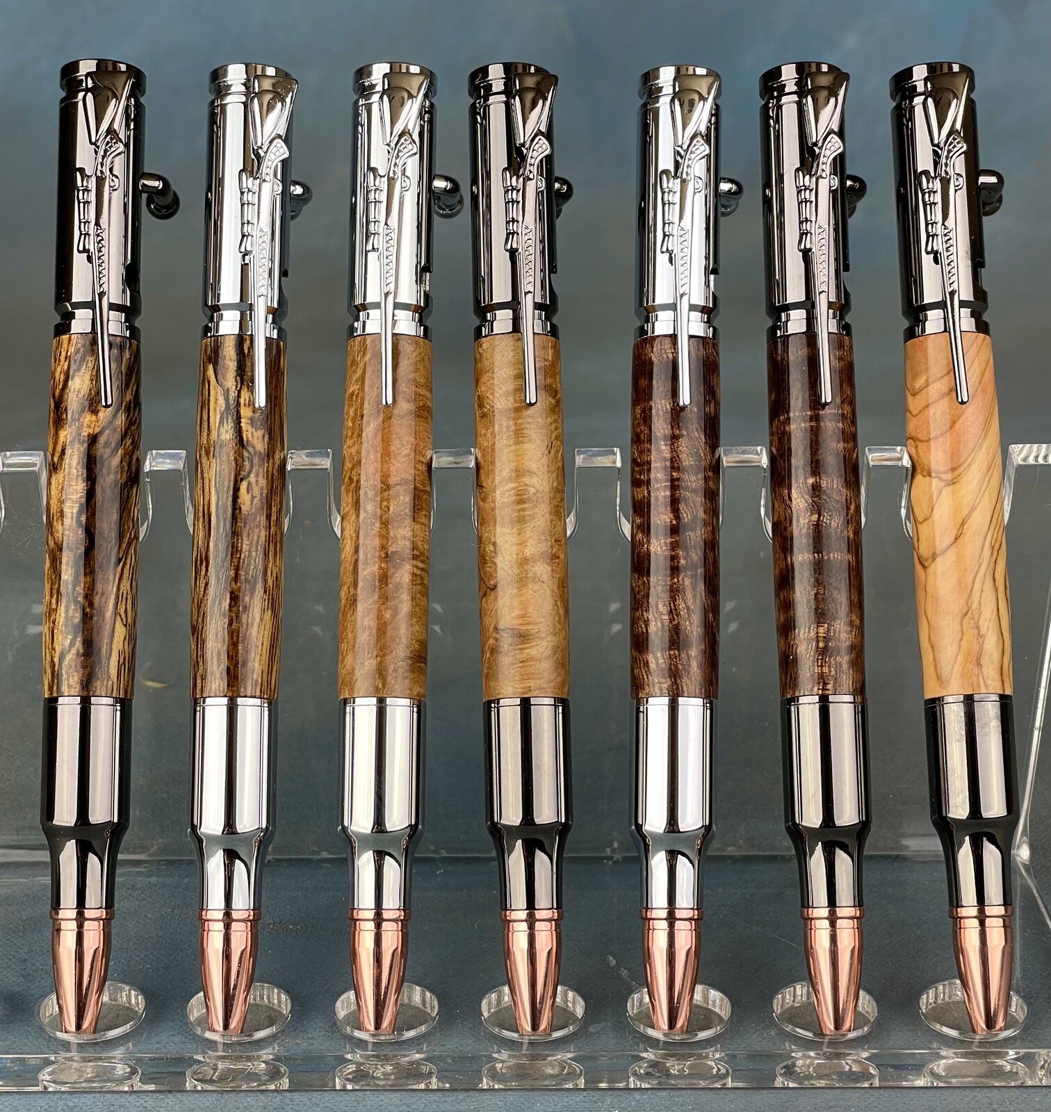

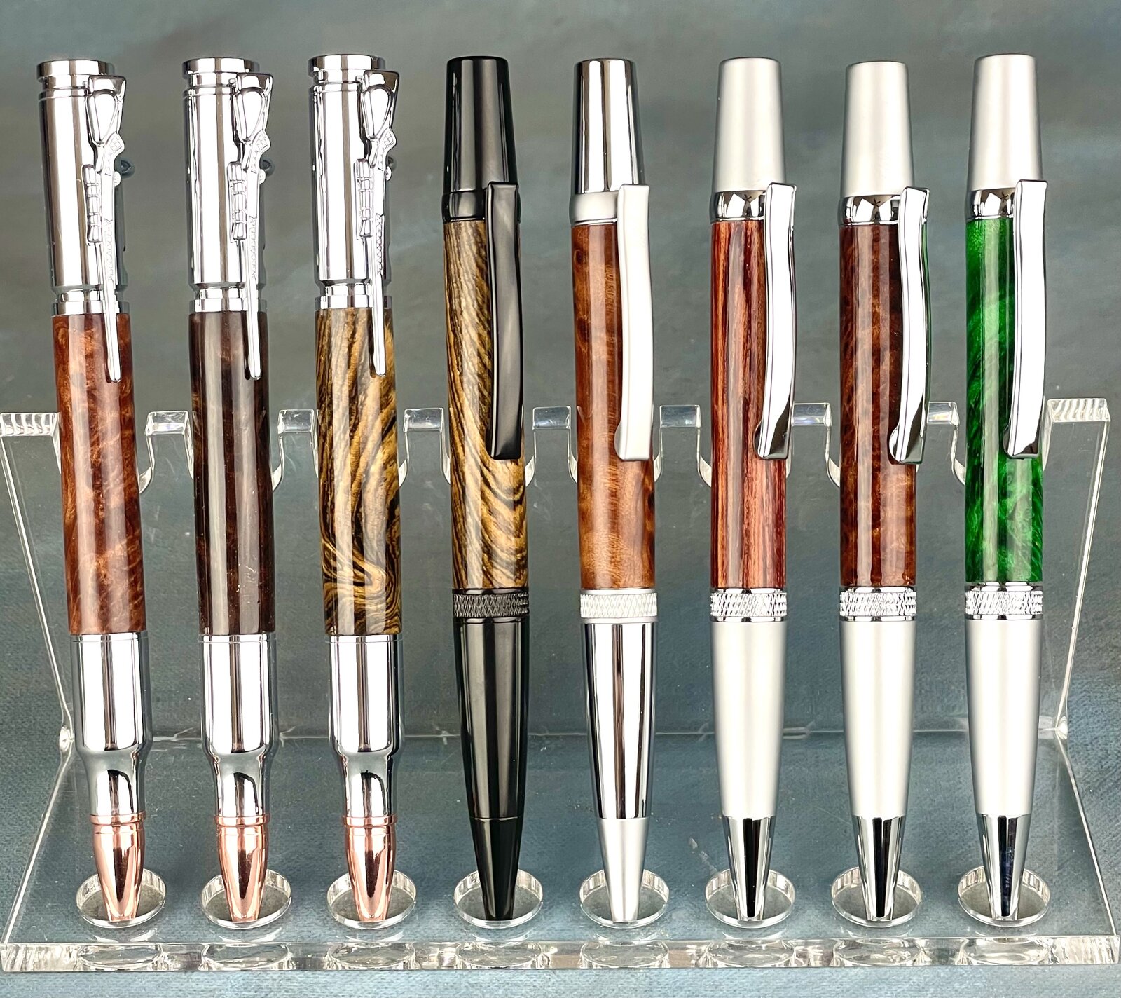

My ends are NOT rounded over and never will be using hook and loop. It would be impossible to sell poorly flushed up pen tubes. Here are some examples of squared tubes using 150 grit before turning with hook and loop and 220 grit after CA. In both cases there is a clear and unmistakable square end.
Do what you wish, but information from "jttheclockman" is certainly not gospel, just what he chooses to do and how he feels about this. I'm not gospel either, but sell many, many excellent pens without any rounding. See for yourself in the photos. Do you see rounding? I don't.

My guess is that it would depend somewhat upon technique. Not sure how hard some might press against the disc. Also, I'm not sure it would be enough for most people to notice (maybe even me?). In any case I have enough PSA to last me a while, so there won't be any changes in the near future. The formica cleans up pretty easily.

Forgot about this thread. I ended up cutting a 5" disc from 1/2" MDF and screwing it to the face plate that came with my Jet lathe. I used the stick on paper and so far it has worked without issue. I have only turned a few pens but am going to turn 10 or 12 in the next week or so. Will update when I think about it again.
