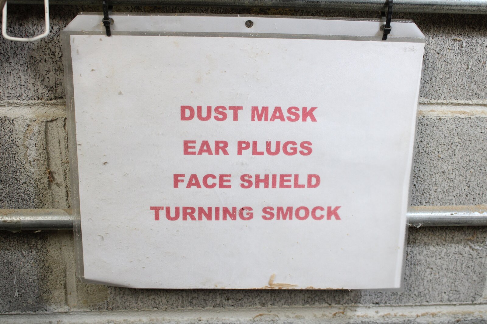

I have a full face mask plus graduated bifocals. The face mask not only protects the eyes but the face and throat. I don't turn without it.
