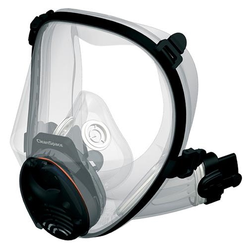

I am looking for a full facemask. However, I need one that will allow me to wear my glasses ( Can't see anything close up without them)
Any suggestions? and under $100

I believe the OP was asking about a full face mask NOT a face shield 😳😳😳
not for under $100 though.

None of the full face respirators work with your glasses. There are some brands like 3M that have an optional spectacle frame that clips into the mask that you get your optometrist to fit prescription lenses into. As you can imagine not a cheap solution. Oh. The beard has to come off.
The cheapest solution is to find a comfortable half mask respirator and a face shield like the suggested Bionic. Oh. You got to cut the lawn off your face to make that work too.
That leaves you with powered respirators that blow filtered air over your face. Also not cheap. You can keep the beard though.
Your last but most expensive option is to spend lots and lots of money on a 5hp cyclone, (like a Clear Vue) 6" minimum ducting allowing you to work with just a face shield. Some chips may not get picked up but the fine dust will.
