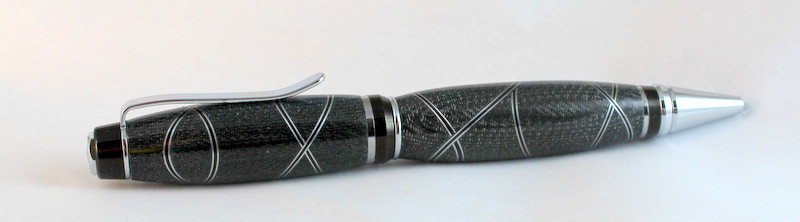

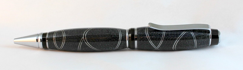

Here's a stacked denim pen I did for a contest a few years ago
121316
[/URL]
I made the blank by layering 34 pieces of denim held together by fiberglass resin. Then I randomly segmented the blank with aluminum roof flashing and black plastic. I finished it with 8 coats of medium CA then polished with micro mesh. I no longer use a CA finish, I just sand to 600 grit paper.
My customers like the texture of the sanded denim.
