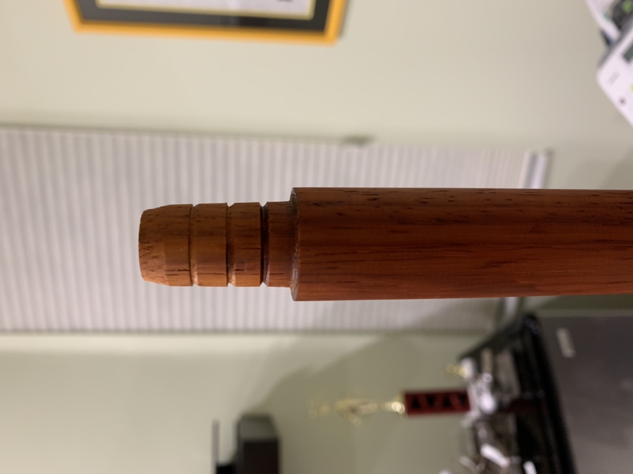

First walking stick (using a brass Hame handle) Way too short. Need to add about 6-8". Part shown is to be the tip... would extend from there. What would you do. Thanks.
I would just make another rod, drill the tip out to fit the male end and glue together. For a little more strength, maybe lathe down the present tip a little so you get an even thickness for each end.
Cut an even tenon and core the piece being added?
I've made a number of canes; since my lathe has an 18" bed, I've had to make them in sections that were glued together. I worried a lot about the strength of those joints, and that forced me to do some rather fussy things to address those concerns.
But in this instance, you are simply extended a walking stick by 6-8". Seems to me that a joint near the end of a stick is not likely to experience as much stress as a joint near the middle of a stick, so I think it would be adequate to just turn an extension, and drill a hole that matches the existing tenon, and then glue the two pieces together. I would probably make the extension out of contrasting wood so that it appears to be a decorative 'sock' at the end of the stick; that would create the impression that you intended to do it that way rather than realized that you made the stick too short and had to add an extension.

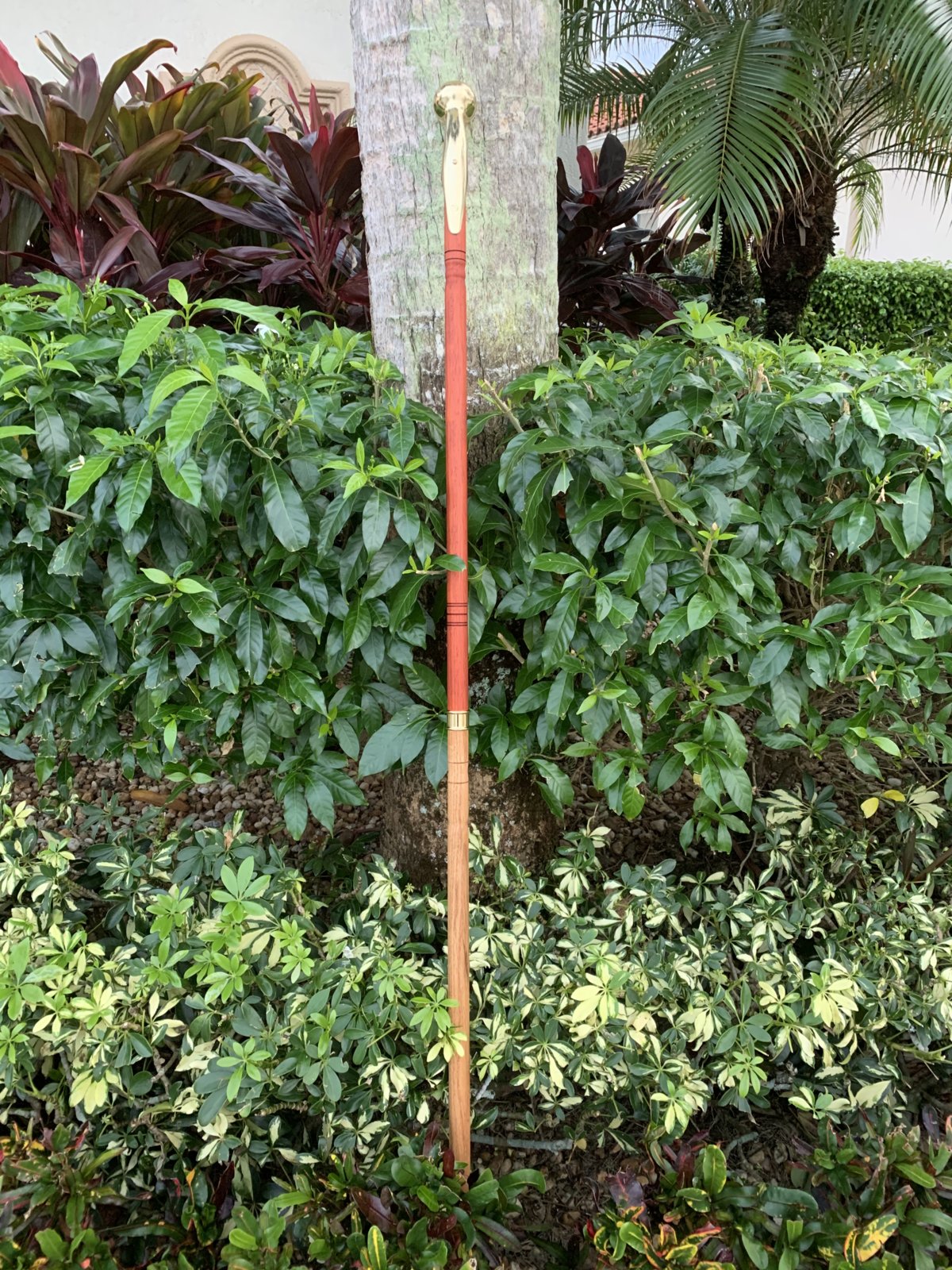

I use these brass joins to make canes at the blind center because we only have 18" lathes. Work fine. Plus the canes can be unscrewed to fit into luggage. The Lee Valley ones are a lot less than Woodcraft.
Got some today..the repair is the next project.

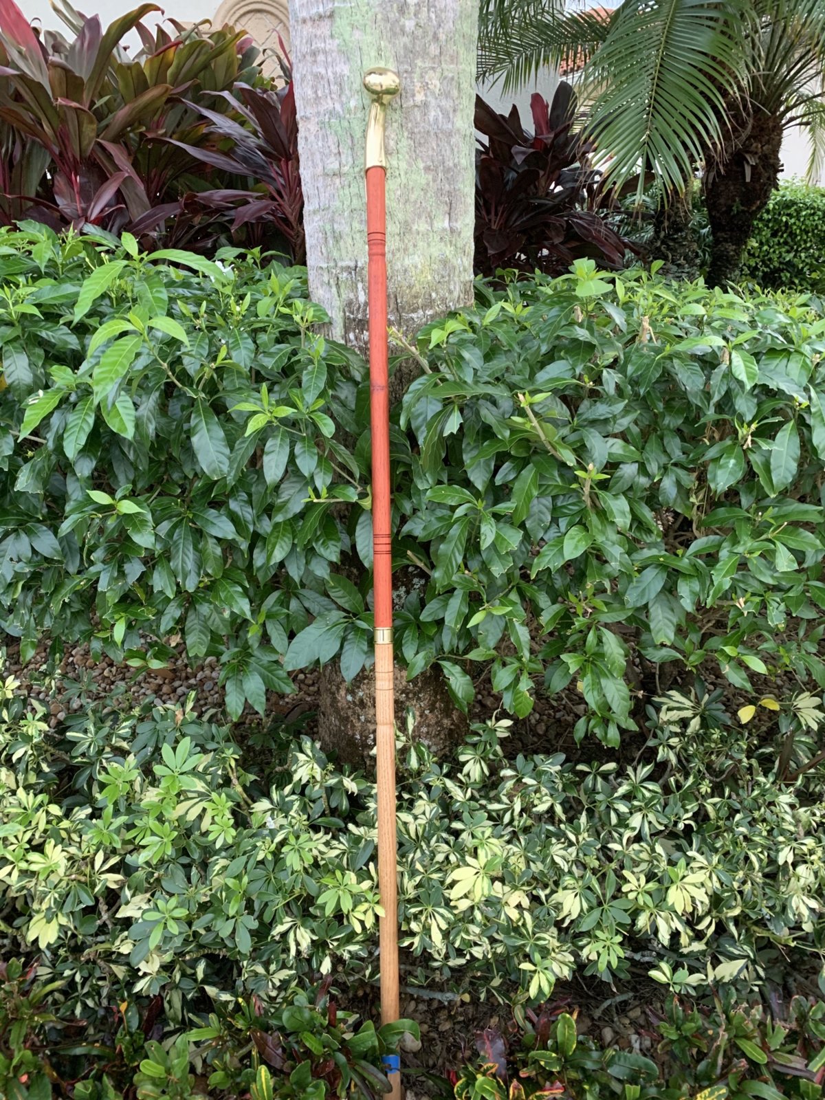

Thanks for everyone's input. I used the male/female threaded coupler and the ferrule from TreelineUSA.com
Just need to cut to size and put a tip on. It has some flex but I'm not pole vaulting.

Thanks again suggesting.
$4.95 for 2 pack from TreelineUSA. These have been working out great.
