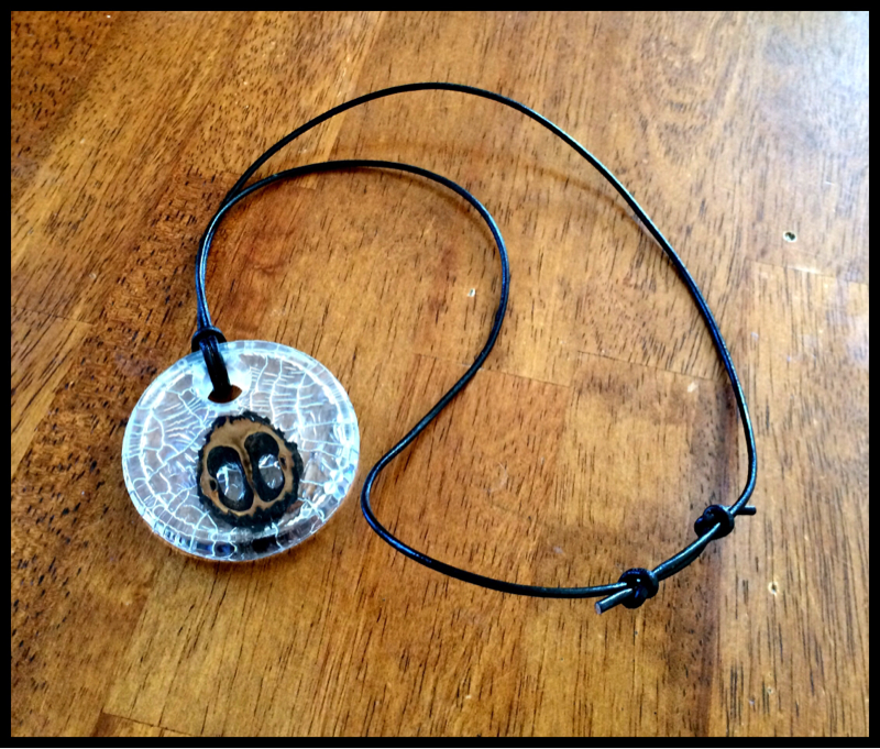

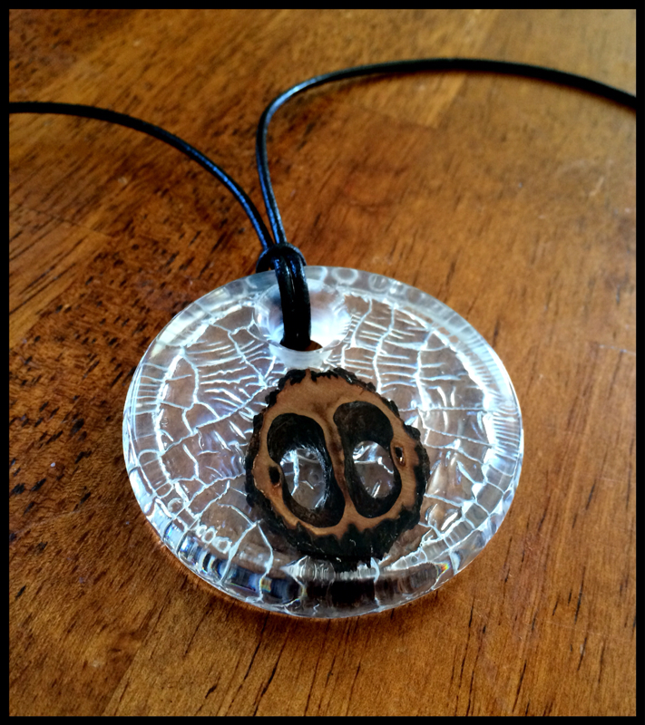

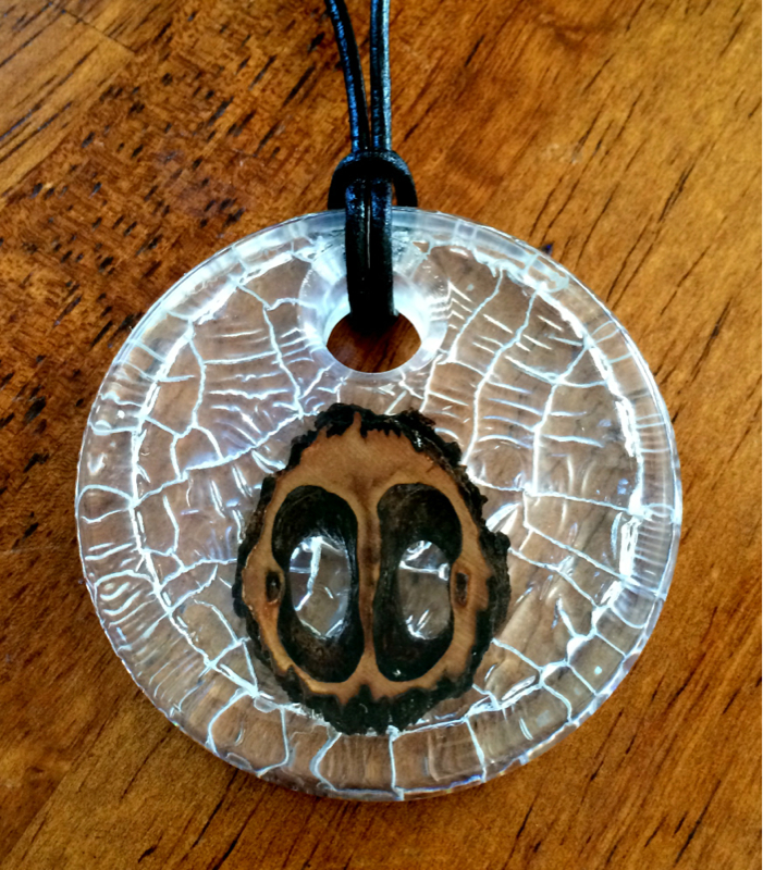

Be never cast anything in my life / this is the first attempt. My son found a walnut in the yard, so I sanded a piece down flat.
I picked up a little round soap mold cheap, poured some PR in and put the walnut piece in.
When it hardened overnight, the bottom and sides got this cracked look to them. I'm sure somebody can tel me why. :-)
The inside and top were fine and smooth.
My wife said that she thought the cracked look is kinda cool so I left it on the back. Turned and polished the sides and front.
In the pics, it looks almost like the walnut is sitting on top of the pendant. :-)
Kind of a fun little project.

I think the cracks, aren't cracks at all. When PR cures, it shrinks, and pulls away from the mold. But it's still tacky on the outside of the blank, and some PR sticks to the mold. From what you said, you didn't polish that side of the pendant. If you did, I think it would be clear.
But I'm with your wife in that it looks cool with the "cracks".
I think the cracks, aren't cracks at all. When PR cures, it shrinks, and pulls away from the mold. But it's still tacky on the outside of the blank, and some PR sticks to the mold. From what you said, you didn't polish that side of the pendant. If you did, I think it would be clear. But I'm with your wife in that it looks cool with the "cracks".
thanks
Yeah, they aren't cracks just like crinkled. They turn out just fine The sides has the same effect but I smoothed them out on the lathe
