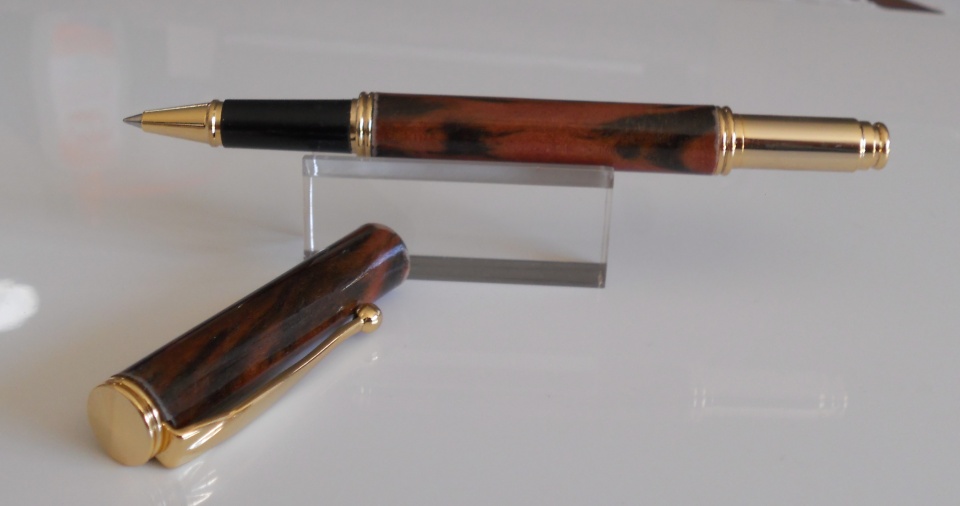

I thought that I'd post some of my latest flawed results.
So, I made the decision to try a couple of different styles of pen kits and have paid the price for being impatient and for poor instructions.
I thought I'd post a few pics of some that are not quite up to scratch as everyone needs to learn from mistakes.

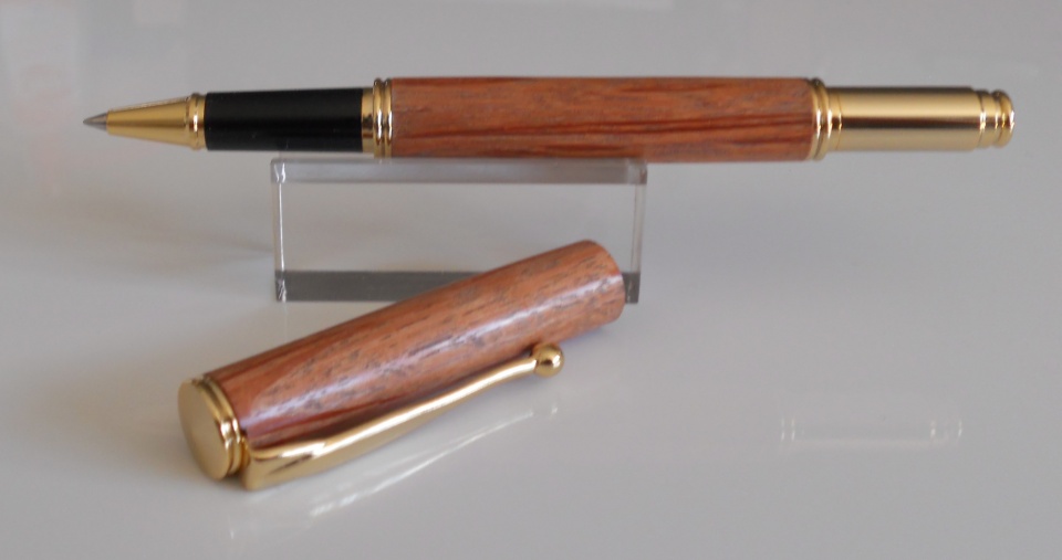

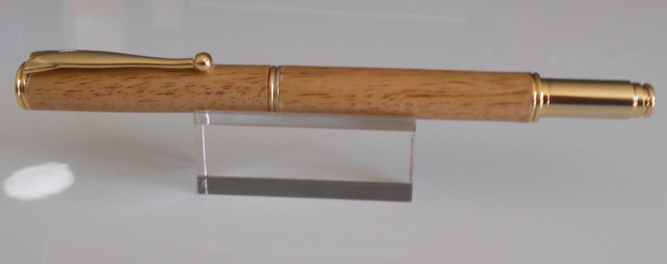

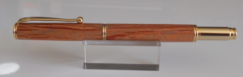

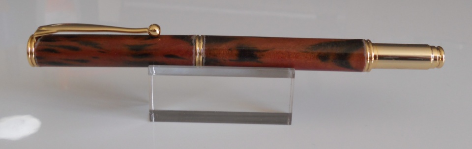

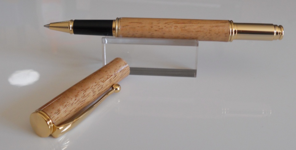

The Rollerballs are a Traditional press on cap and are turned slim. The tricky part was adjusting the insert to get the right amount of seating. On the Tiger Myrtle, which was my first one off the block, I was a tad over exuberant and took a tiny bit of brass off the tube and also had some finishing issues with my CA. The Forest Oak one was definitely the best as it was also my 3rd.

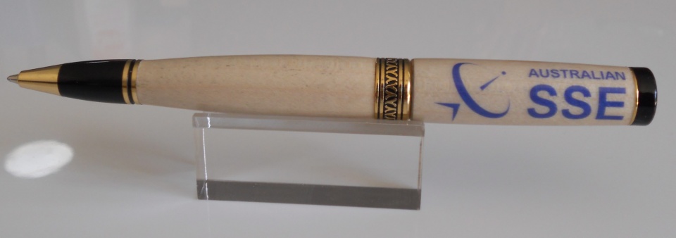

I have experimented further with decals and tried a twist style Parker. Not a fan and as I used a decal that I had printed out previously for a Sierra size, it's a tad off size here. This was more about using a timber and not acrylic for a decal pen.
Live and learn and turn, I say.:rolleyes:

We have all been there. Just a tip....On the myrtle and mahogany it looks like the barrels stuck to the bushings and your broke them free. Try scoring them with a exacto knife or a utility knife before you break them free.

Thanks for your comments guys. I will more than likely dismantle these and try to resurrect them. It's all been a learning curve and as I don't like to do the simple things and just dive in, I need to learn from my mistakes so I can compete with some of the works of art I see here each and every week.

I like the decal! What kind of printer and clear material may I ask?
Have a great day!
Thanks guys, In answer to Mark's question, the printer was a cheap and nasty Canon mX436 inkjet and the paper is "Inkjet Clear - Waterslide decal paper" that I got from an EBay business here in OZ.
Thanks for sharing these Brett. I have made all those mistakes, and occasionally still do. I am curious about the Forest Oak pen. I noticed some discoloration, is that how the blank was? I have had that problem when I was overzealous with my sanding, and often would allow the sandpaper to go over the metal bushings, and that resulted in the stains on the wood. Now after turning and getting it to size with the 240 grit paper I change from metal to plastic bushings which I buy from rockler (meant for CA), that works really well for lighter timber, and no stains. Just a suggestion if that is the problem.
