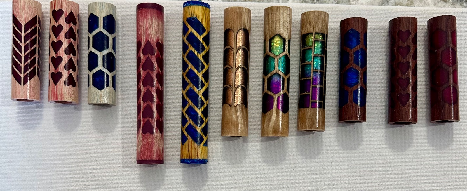

These are all skeleton from which inlays were cut. Seemed like I could do something with them. Colored resin stained them badly, even though I tried various methods of sealing them. The better ones were double dipped in sanding sealer prior to casting. The darker woods are not a problem, even if staining is there it's unnoticeable. Even clear resin is noticeable on the lighter woods. The thing is, I don't hate them but I don't know if I could put them on a pen knowing it's stained. Kind of silly since we all stain wood all the time. That is intentional though. I used both Alumilite clear and Liquid Diamond, same results with both. What do you all think, is this a losing endeavor?

They look nice. Stabilizing the wood will stop the bleed but that's not fun to do. Kallanshan sells some of his negatives for casting and I've tried a few. They were cut out pieces for other blanks so they weren't as patterned as yours. I'm surprised the clear resin stained them. I wonder if pouring at a higher temp where the resin is thicker would stop it from soaking in to the wood grain.
I thought about pouring them warmer but thought it might not fill in the voids well.
Since it's single colors I would have first poured as soon as the resin was mixed so it was thin. I would try waiting until it hits 95° ish. That's enough to keep color separation and still get around embedded objects. It might stop the resin from soaking in. Since it's under pressure I would think you'd be ok as long as it's not over 110°. At 95° it gives you time to pour. Either way they look cool!
I'll try a few more and letting it get to 95° before I pour it. I was thinking about offering some of the skeletons for sale, but if they can't be cast easily, that's probably not a good idea.
If sold with the caveat in big bold print - I can see a market for them for experimenters who like doing that, and an exclaimer saying "NO GUARANTEES ON THE OUTCOME!".

so I'm going to ask what is probably a foolish question. Would the staining turn away as you worked down the diameter on the lathe?
I think Hank had the correct idea on your sales of these blanks. "results not guaranteed"
I've turned some very thin and the staining doesn't go away.

These are not purposely cut to be cast. They are the leftover skeletons that have had the inlay pieces cut from. Yes I use a rotary attachment to cut them.
got it, what a bummer. They're really quite gorgeous
OK, am I missing something? The "staining" looks intentional to me and I like it. I think they would make some very interesting pens.
Mike
Mike
Yeah, the staining is not intentional. I think they look interesting, but I know they are flawed. That's why I would have a hard time trying to sell that look as a "feature".

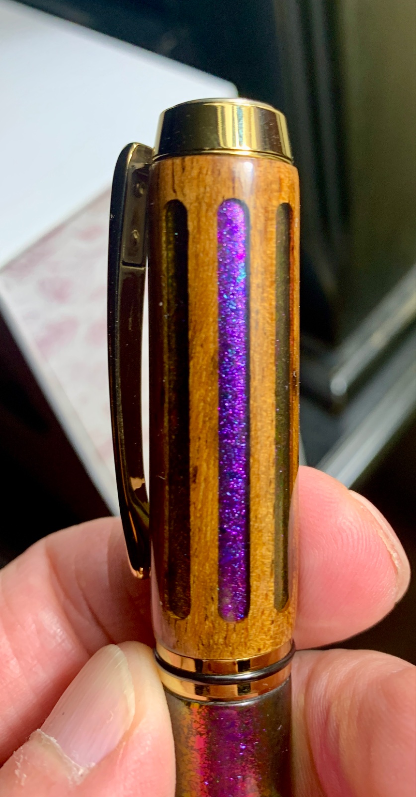

There is a lot of potential here. I assume the blanks are drilled, laser cut and then cast?
Here is one I made some time ago with a similar look but what I did was cut the blank, drilled for a tube that was decorated and then clear cast.
