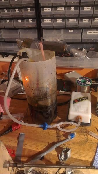

Yes we can do all this with stainless steel it just takes a little longer to etch thats all. theres also a couple of choices too, one of which uses ferric chloride, the other does not...
youve seen my professional etching tank, you would be better splashing ÂŁ500-ÂŁ700 on one of them instead of the big bucks associated with CNC. I still have those bits of stainless you sent me, lets drop one of those in my tank and we can see if that convinces you chems are the way forward for stainless :cool:
Here you go Steve, just for you.
2 ltr coke bottle with the top chpped off, neat 1ltr ferric chloride, no need to dilute for stainless. still add 100G of citric. also in this bottle i have a brewery immersion heater, and a fish tank air pump for agitation. stops all the heat sitting at the top of the solution and keeps smut off the piece. ive no idea how long this will take but ive masked a bit of stainless and put it in this state of the art DIY etch tank..... il let you know how it turns out :wink:
oo you may also notice the little blue piece on the airline by the T adapter.. thats a one way valve or an anti syphon device..... if the air pump is lower than the level of the solution it will syphon back when you switch it off... im sure you agree your air pump wont work very well next time iif its been flooded with a corrosive lol.

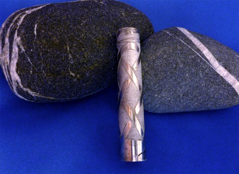

:tongue: yea you pretty well hit the nail on the head, though i have programmed and operated CNC's and havent found it anywhere near as satisfying as etching a piece.. but each to their i guess :cool:
oh, and on that note.... look! etched stainless steel :biggrin: not bad for a coke bottle and a fish pump

You know Brad, you aren't making this easy for me, you know!!! You weren't supposed to just come back in a couple of hours and say...'Look, easy peasy!!!' You were meant to say...after a week or so....' Er here are the results...can you make out the image???'
Dammit Janet!!! Frankenfurter's getting me going!!!:eek:
Thanks for your efforts with that bit of stainless Brad. I hate to say it but I'm kinda leaning in your direction now. :rolleyes::biggrin:
