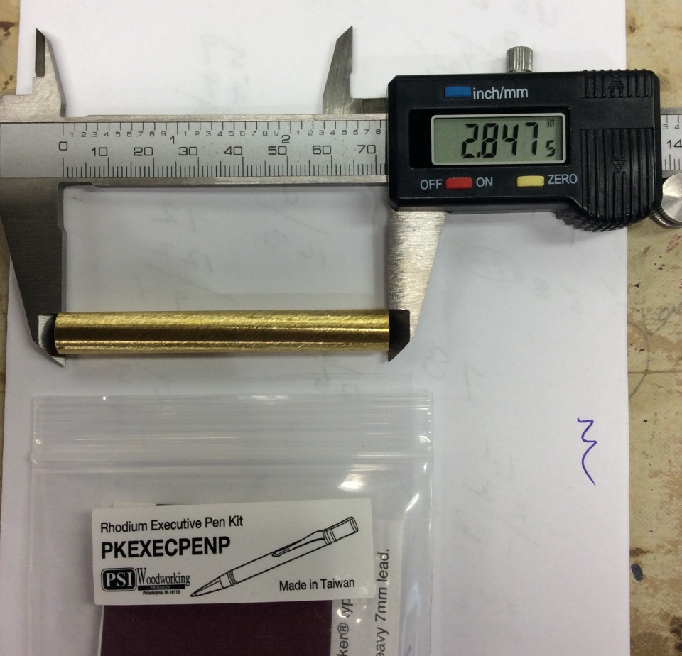

Executive question
Here you go.

Not new to me but PSI does not sell the tubes in that length I have to cut them to length and have some decal orders so I needed to get the correct size in order to make the 3/8" tubes correctly...thanks to all who answered...

Try PKEXECTU at PSI.
It's strange that none of the Executive kit listings tell you that.
The listings all say PKT38-8 which is the 10" 8-pack.
Michelle
Bet if you go to their website and plug in that number they'll come up.
The bushing/tube info in the IAP library has this information in it as well.
According to the spreadsheet the Civil war kit uses the same tube as the executive - PKCWPENTU.
I just checked the tubes from an Executive and Civil War and they are the same. The spreadsheet is accurate.
