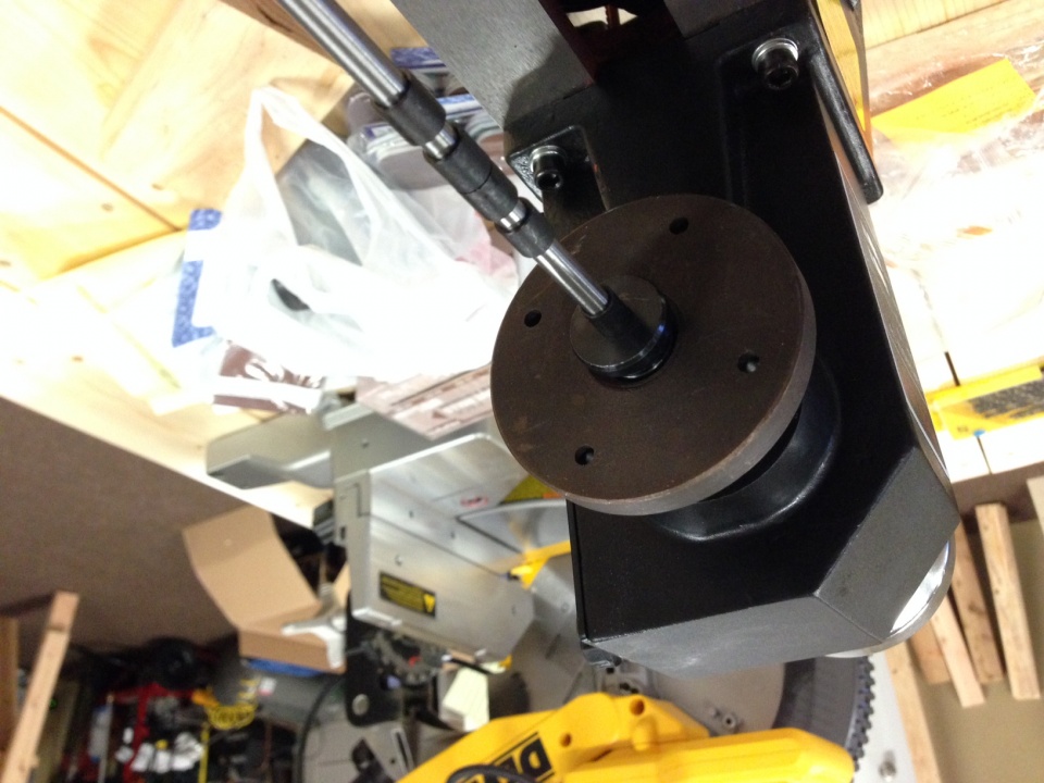

I bought an Excelsior Mini Lathe from Rockler. I have a few questions.
1. The lathe came with a face plate installed. Do I need to keep it there to turn pens?
2. When I put my blanks on the mandrel and the bushings and start to turn, the blanks sometimes stop spinning. How do I get the blanks on the mandrel so they wont stop spinning?

I have the same lathe and I have turned pen with the face plate on it but it kept hitting my knuckle so I took it off. It was tight so I sprayed a little bit of WD 40 on it and then put a rag on it and then put a wrench that would fit the face plate and gave it a couple of taps with a hammer and it came off. It will unscrew off. It's better to turn the pens with out it on unless you like to get your knuckles hit.. I find it easier for me to put a few washers on the mandrel before putting on the fist bushing and the first half of the pen, then the next bushing and then the other half of the pen and then another bushing and then another washer or use a small piece of wood for a spacer and then put the nut on the and install it on the lathe and make sure the tail stock is on tight and then tighten the nut on the mandrel and I get a pretty nice pen. I keep all my washers and bushing on the mandrel when I'm done using them.. Good luck with your lathe and pens. It's a great little lathe.. Love mine... The only thing I don't like is that the lathe is so heavy that I can't turn it around to get to the back door to change the speed so I left it as it was when it came. I've had mine for about 2 weeks. Fay
You do not need the face plate to turn pens, it can be removed.
You need to tighten the nut on the mandrel until the blanks do not spin anymore and take light cuts to start with. Do not over tighten the nut you can bend the mandrel shaft.

First off, I tried to unscrew the face plate off but the only thing that came off was the wheel at the lathe's head. Someone mentioned that the face plate screws off. I will try that.
I think that I bought a mandrel with a mandrel saver. It fits into the tail end and when you butt it up to the mandrel the end of the mandrel kind of goes into the saver.
I'll try the washer tip and to turn the wheel to tighten it up a bit and see if that helps.

You have a rod with a ball handle on it and there's holes in the drive between the headstock and the threads to put it in to hold the drive while unscrewing the faceplate or chuck. Once the faceplate is off cut a washer out of some card stock and put it on. This will help keep the faceplate from seizing on the shaft when tightened.
If you are using a standard mandrel with a knurled nut, go ahead an tighten it up firmly. It is not possible to bend the mandrel shaft by over tightening this nut. The reason is simple, the nut puts the mandrel shaft under tension which tends to straighten the shaft. Where you need to be careful is when you tighten the tail stock. Over tightening the tail stock can damage a mandrel.
I think I will get a mandrel saver on payday. It might be of some help for me too. Yes. I did get my face plate off by putting a rag on the part of it that has is flat on 2 sides and the place a pair of pliars and give it a tap or 2 on that pliars and it will unscrew off. Now you can turn pens with out it and you can put a chuck on the threads where the face plate was. My new chuck got here yesterday and it fits my machine and I have yet to try turning with it. Good luck with your lathe and all. I love mine.. Fay
