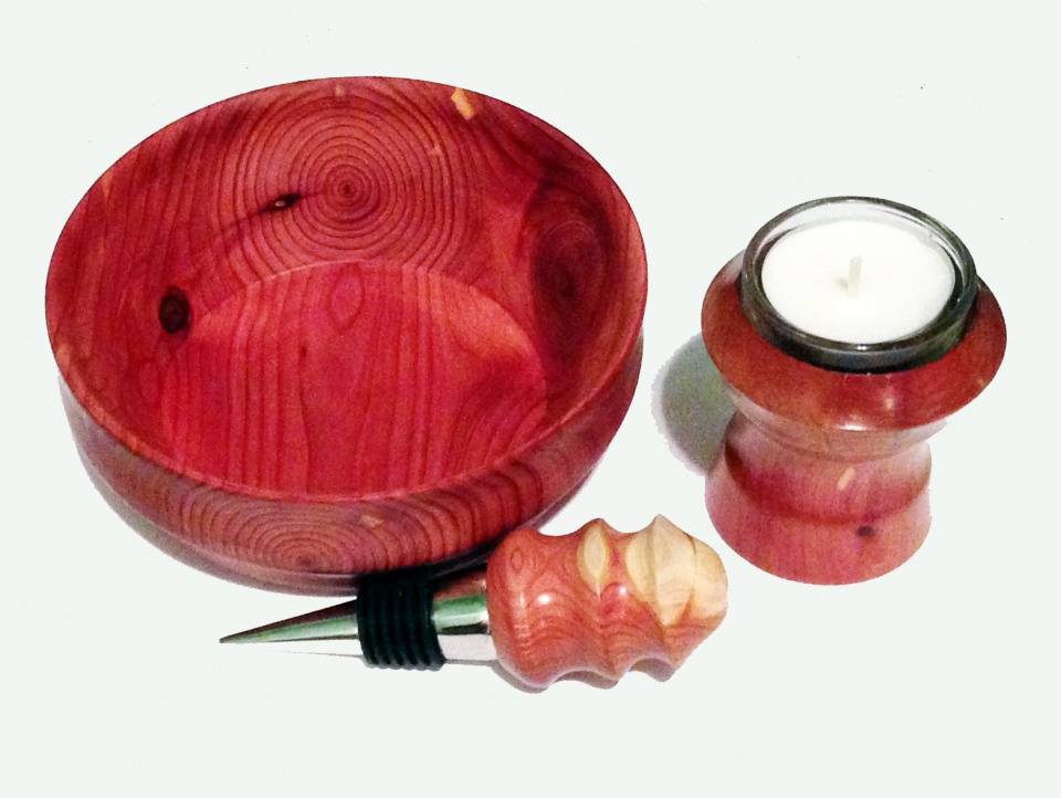

I used my R2 cutter to put the bottom slope on the stopper in the photo below and I used my round cutter for the rest of the stopper shape. The top concave is essentially a plunge cut and the lower one is a sweeping cut.
Acrylic is a bit more touchy than wood, but the key is to stay within the limits of what the cutter size allows.
