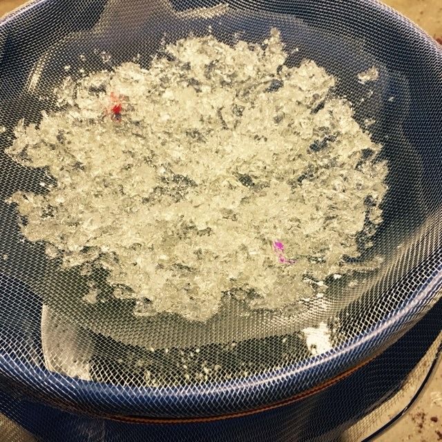

This week I found out I qualified for front runner of the pack. I was pouring some Silmar into a smaller more managable container from a 5 gallon can. Well I somehow ripped the cap off the 5 gallon can and thought no big deal I have a left over accelerator bottle I can flip over and stuck in the hole.

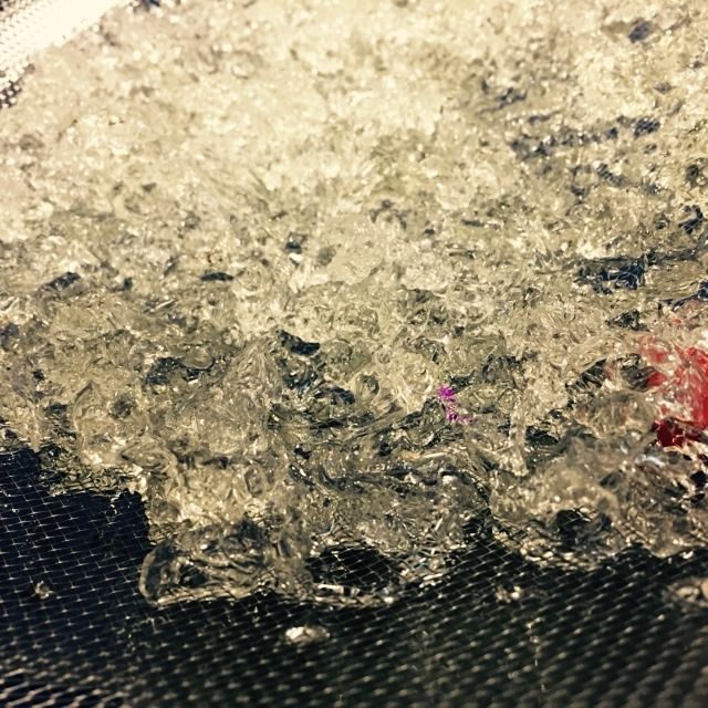

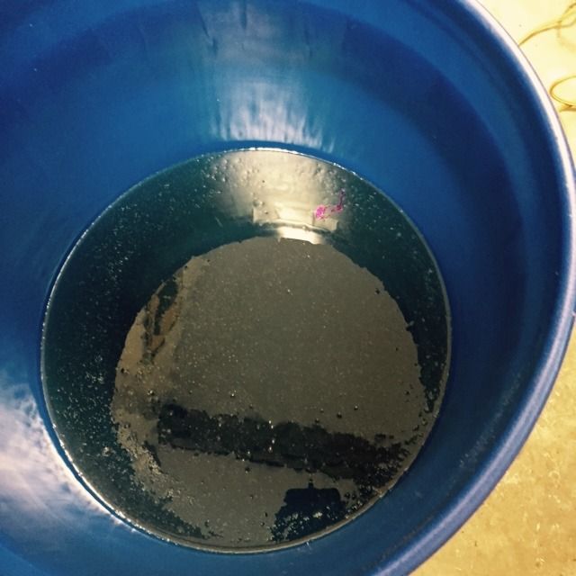

I went to get more resin today and found clumps coming from the jug and thought "what a winner". In an effort to save what of it I could bought a new clean bucket and lid and some screen door material and now have strained all of the clumps out. Hopefully I have saved 2 gallons.

I think the rest will continue to harden slowly so you better use it quick or you'll find you have 2 gallons of rubbery goo in a few weeks.
Once a pail of resin is empty I remove the lid and use an old CA accelerator spray bottle to lightly mist MEKP over the pail and lid. In a week or 2 the remaining resin on the sides and bottom cure, especially in hot weather, and I put my scrap metal in it to take it to the metal recyclers. The 6 to 9 cents a pound for steel adds up. :smile:
