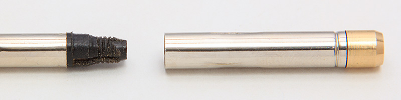

I wanted to make a modified pen that didn't look like a modified pen, so I set out to adapt a euro pen kit to take a parker-style refill. First off, I drilled out the nosecone with a #38 bit. Then I pulled the plug from the end of the refill, turned it down, and threaded it with a M5 x 0.8mm die. That way, it will screw into a standard 7mm transmission:
attachment.php
Normally, I avoid modifying refills, but since a customer can pull the plug out and stick in into a replacement refill, I think it's ok this time.

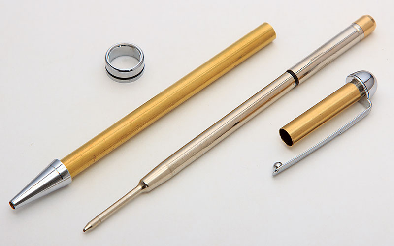

When attached this way, the transmission will need to be installed in reverse orientation, which necessitates a couple other design changes as well. Standard euro tubes won't grip the tube in this placement, so I cut new ones from some 7mm tube stock. This photo shows all the parts, with the refill screwed into the transmission. The transmission will press into the short upper tube.
attachment.php

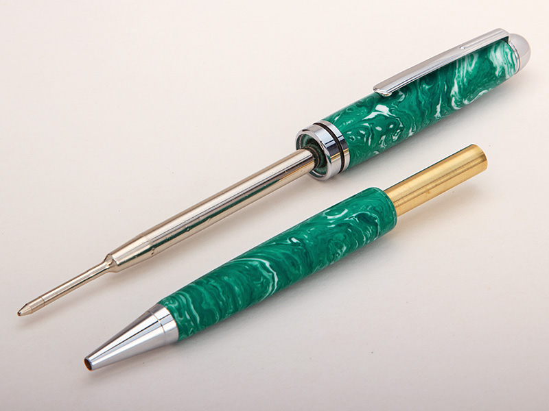

I didn't want to change the outside appearance of the pen, however, so I cut the blank such that the tube would extend from the lower barrel, and the tube would be recessed in the upper barrel. Part of the reason I chose a euro-style over a slimline, was to allow a thicker (and therefore stronger) unsupported section of the blank. The blank is made from alumilite white resin, which is strong and durable even without a brass tube. I selected a green marble pattern. This is the pen completed but with the halves separated.
attachment.php

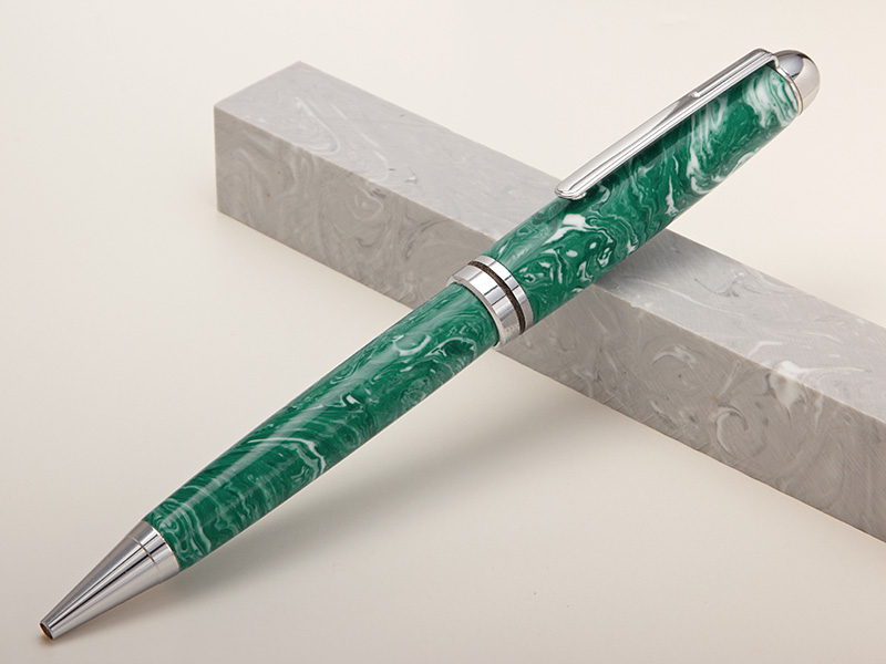

And here is a photo of the finished, assembled pen. The only oddity, is that the refill extends with a counterclockwise twist (opposite how a regular slim/euro pen twists).
attachment.php
