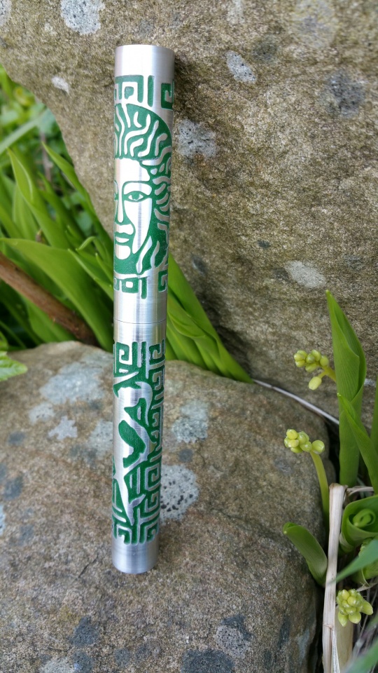

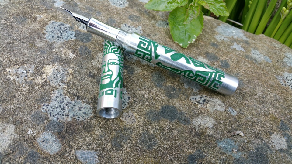

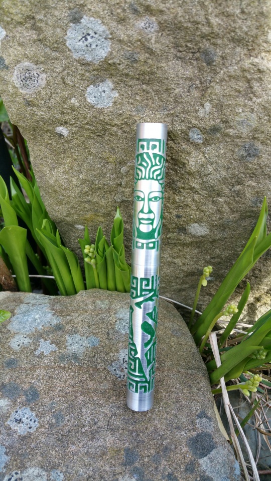

I've been working on a Medusa & Perseus design for the past week, and with my new airbrush delivered today, I could finish it off
Thanks for looking :smile:

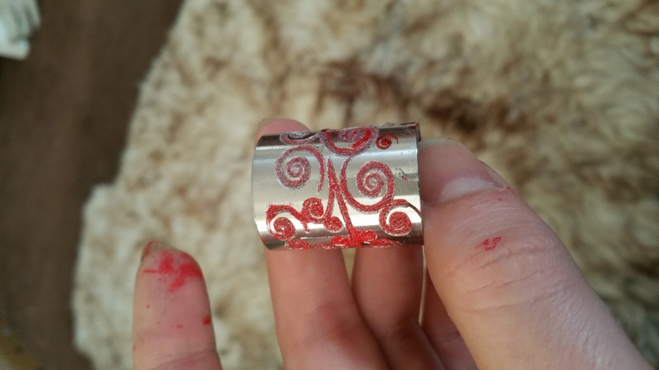

I know this looks rough and nasty, but it's proof of concept to see how it would behave.
I put a stainless plumbing fitting into the etch tank today and pushed it for a deep etch. The deeper it goes the rougher it looks.. earlier in the process it looked rather nice when it had just removed the top layer. Almost like a diamond encrustation finish. I spray painted it which always looks awful as it's too thick, but it allowed me to see a better view of the etch.
I reckon with a bit of refining, a lighter etch with the right pattern, and most probably not painting it at all would look rather tricky

Hi Brad, that pen is as cool as always. Well done again.
Now forgive a stupid question but I'm intrigued as to why you used paint..:confused: I would have thought that you would anodize the entire thing, then sand back the original un-etched surface, leaving the etched picture .
You know Im very interested in your progress with stainless, .
I think you are right with a light etch. I don't think colour fill is better than a stippled or diamond etch.
As soon as you nail it, I'll be your new best freind!! :biggrin:
As always Brad a very well done piece of art. The work in this is beyond what we see. We as members have a little insight to what the volume of work is because you share with us the technique.
I am thinking along with Skip on this. Is it possible to reverse the effects. 2 different things. Annodize the entire pen and then acid the design. Or acid the the entire pen and have the design stand proud.
Look at us we are telling you what to do:biggrin:. Just thinking out loud. Keep up the great work. You are doing something very few of us could even think about trying.
Anodising is very, very sensitive to imperfections. usually when I anodise a pen I have to meticulously sand the piece in order for it to anodise evenly. This isn't possible in all those hard to reach parts of a deep etch.
This was further complicated by etching using Ferric chloride because of all the smut it created, and even after a thorough clean, contaminants seeping out of the metal would cause the anodising to fail. so, from that point forward I started to use acrylic enamel which is quite hard wearing compared to "paint".
However, I no longer use Ferric chloride for etching, and the process is so much cleaner. I stand a chance of being able to give it a scrub with a toothbrush with some caustic to clean it up and I suspect it may well anodise. Since using this new approach of etching, I have not setup an anodising tank. It's on my list of things to do, and you can be sure once ive setup an acid tank again attempting to anodise the infill will be one of my first experiments. Along with anodising the surface a different colour etc.
I have quite a list of things to get around to, but step by step il get back in the game. I've been away from it for a bit so im progressively getting back into it. hence the last being a kit pen. this time kitless.. next time most probably anodised, then etched and anodised..... then somewhere along the line practising zincating aluminium so I can chrome and Black chrome pieces..
Step by step ;)
