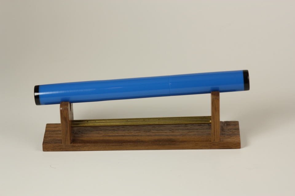

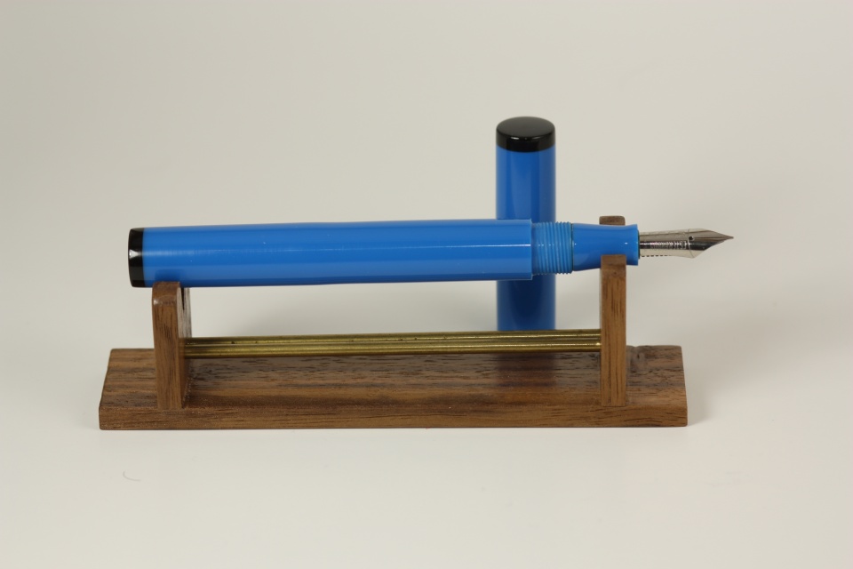

So the pen is an eyedropper from my own PR castings. It holds just over 5ml of ink. The section is friction fit, shellacked in place and tapped for Esterbrook nibs. Weight is right at 16 grams empty and is a little longer than an Estie J. Heat is not a friend of this pen, so no leaving it in temps over 120°.

Nice pen Mike.
While I'm not a fan of the step down to the section {personal preference}, it is a nice simple design. The cap to barrel connection looks perfect. Do you plan on adding a clip?
I have a few Esterbrooks myself. They all need a little work and I know I wont be able to fix them all. This is a nice inspiration for the spare pieces.
Darrin,
No clip plans just yet for that pen. The finials are epoxied in. And on the cap, the tenon part of the finial is drilled out to make sure there is plenty of room for the nib.
Maybe in the future but don't know where to get a good clip that doesn't come off a kit.
In the past, I've considered getting a die made to stamp my own from stainless, much the same way Esterbrook did in the J pens. Certainly not what the new guy is doing these days.
