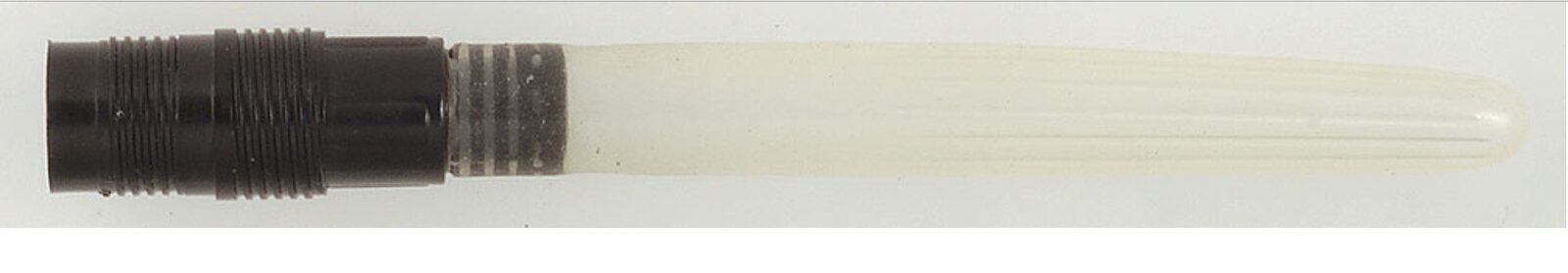

Do any of you have a plan / instructions for a coupler to join the ink sac to esterbrook nib feeds. ??

I don't understand exactly what you are asking, but I've made a couple of pens that take the old Esterbrook "Renew-point" (sometimes called "Re-New-Point") nib units.
Ink sacs (latex or poly-something) are typically a tight slip-fit over a tenon (with a hole drilled through for the ink to feed) on the nib section, sealed with shellac. There is no coupler to speak of.
Since ink sacs are available in a range of sizes, I can't tell you the tenon dimension - that will depend on the sac you have.

This black part in the picture
