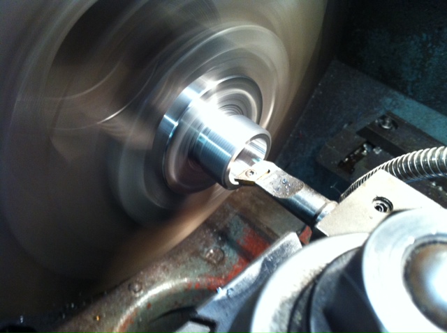

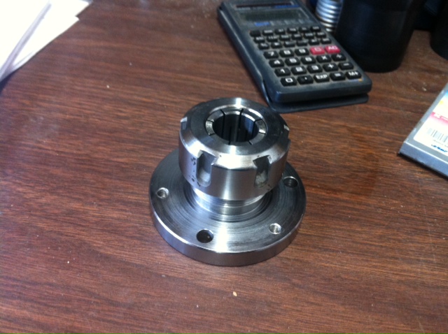

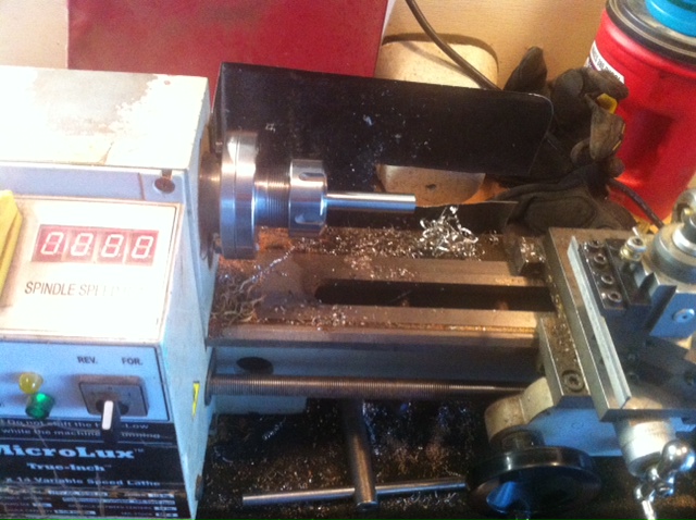

Finally got (or took!) the time to finish this for my mini lathe. Now to just get the time to play with it!

Shiny is good! Nope, didn't make the nut. Guess if I had I could have made the threads whatever I wanted! Bought the nut and some collets a couple of years ago. Figured with the way the collet fits the nut I'd leave that to the perfessional fit :)
Looks good. What kind of runout are you getting?
Haven't stuck an indicator on it yet, but it is pretty darn close. I used to could see movement over a couple thou, and it has no visible movement to my eyes, but....... I may need to dial in the compound and take one more skim pass for the collet to seat completely, but I think I'm gonna like it!
