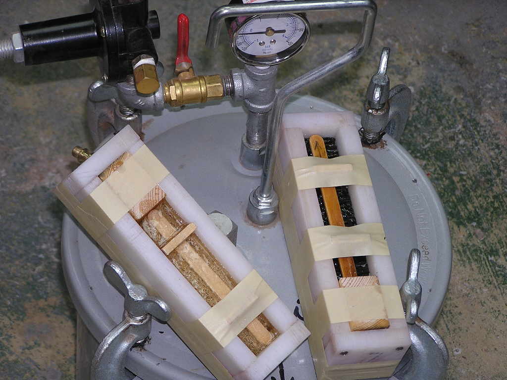

First the specs. I am casting in a mold I made from a cutting board inside diameter is 1x1x6. I have 2 molds I am using a pressure pot. I use about 50lbs pressure. I am trying a variety of things impregnating porous palm wood, pine cones, loofha and what ever else I can put in the mold. My shop is A.C. about 78 -80 deg.
My likes and dislikes. I like epoxy it seems to be more reliable. It turns easier. It doesn't eat rite though a plastic cup. It's expensive a BIG factor.
Polyester I like the price. I am trying to get the hang of it but struggling. I used 3-4 drops per once as others say. I mix about 6 oz. each mold takes about 3-4 oz. It sat all night in the pot still not cured. Put it out side to air (I'm in Florida) for a few hours still a little runny. We're about 16-18 hrs now so I put it in the toaster oven about 150 for 1 hour just getting dry.
I know I heard a little sticky is normal but I must be doing something wrong. I read too much catalyst will make it brittle. But It would be nice if it were to cure in say about 6 hrs or so.
Any more suggestions I will keep experimenting but that get expensive. I like the epoxy but I want to try to make the polyester work. And what do you guys mix the poly in plastic cups don't work. I found that out the hard way. What a mess resin all over me the floor a disaster.

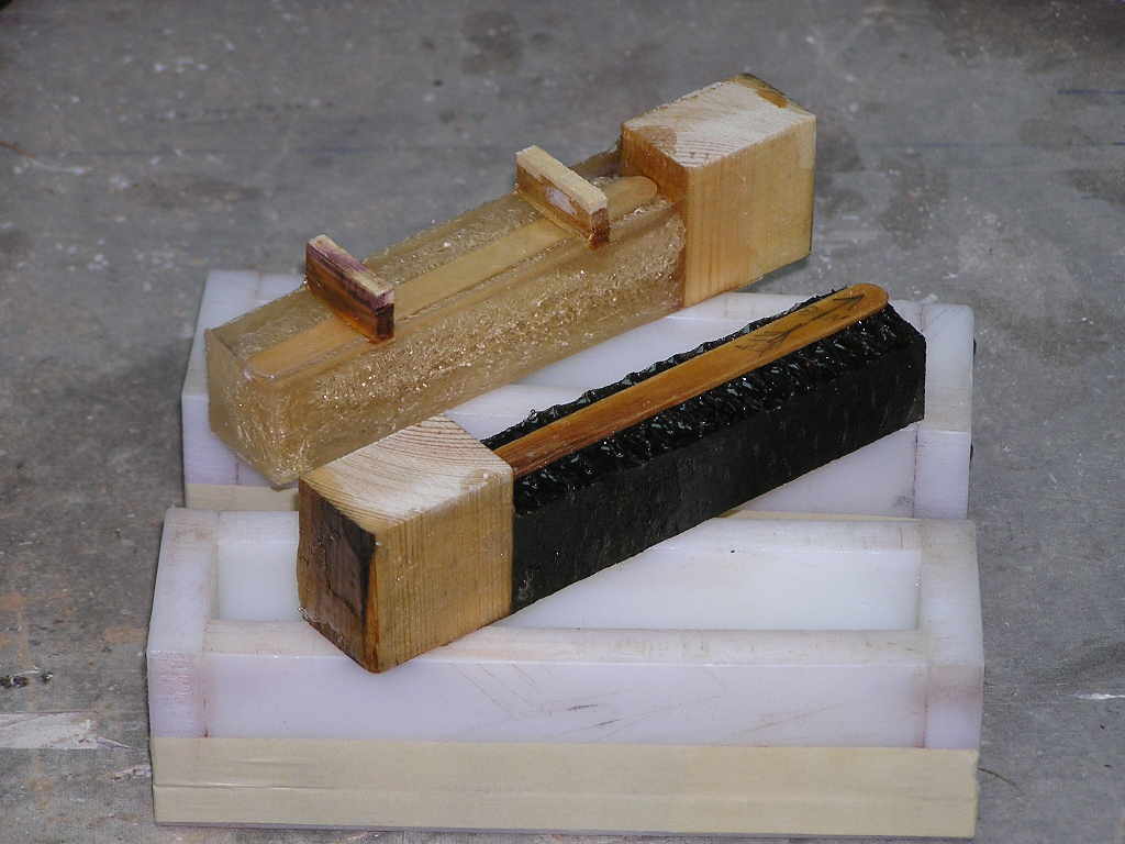

Success.....2hrs later we have a cast!
They popped rite out just a little sticky on the sides like others said. But they look OK like there going to work. I'll know later on tonight or tomorrow when I turn them.

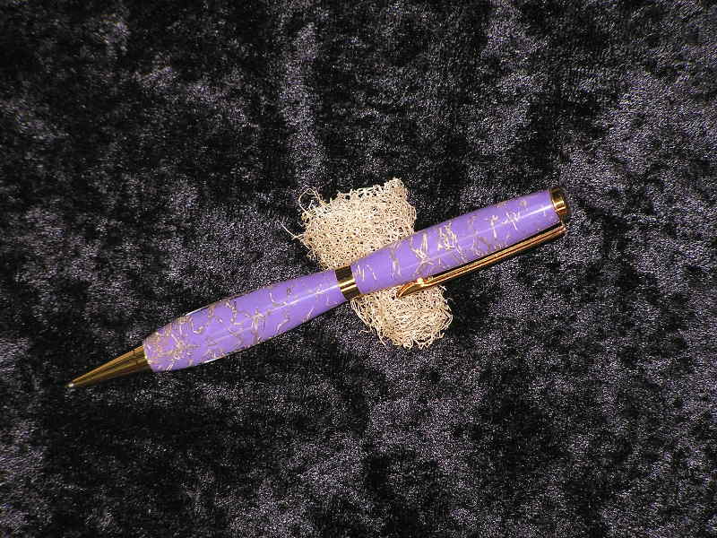

Well it's the next day and good news / bad news.
Good news I got a pretty good loofah pen.
Bad news the pine cone exploded.

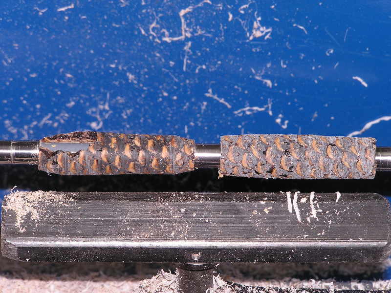

My feelings the poly is a little hard to turn. It seems to be a little fragile. I did the pine cone first and I find that the ploy is very hard and hard on the tools. I had a very sharp chisel and sharpen it a few times during turning. I find I have to go real slow (cutting that is the lathe is spinnig fast) or the poly will chip. Well as I was turning the pine cone it exploded. You can see the chips in other places. I am trying to be careful and cut very light.
The loofah turned pretty much the same but I got it done. Again I find the poly very hard and easy to chip in fact there is a crack or two in the pen. It did polish up very nice.
The very short experience I have with poly & epoxy is that poly seems to be harder & less forgiving. But polishes up very nice when you get it. The epoxy is easier to turn, doesn't chip & is more forgiving.
