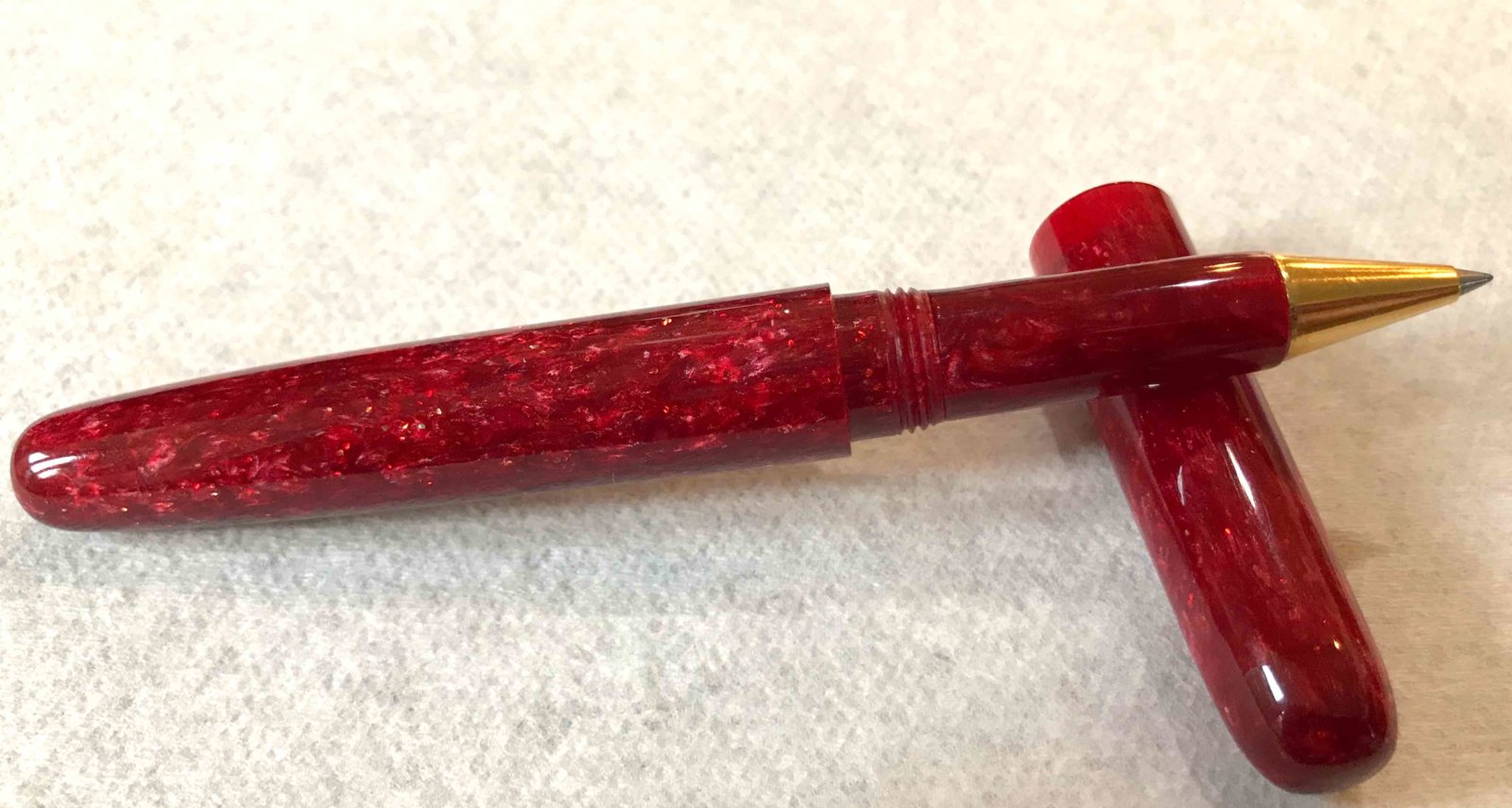

Hi All,
I've screwed up a section where I've just now noticed that the nose cone (this is a rollerball) isn't flush against the acrylic; however, the epoxy has now dried. A couple questions:
(1) Does anybody know of a good way to remove the nose cone under these circumstances?
(2) Should I try applying acetone to the inside of the section in hopes of loosening the epoxy, or will this damage the acrylic?
I'd really like to avoid making another section if possible...
Thanks!

The problem has been solved via elyk864's method. I had to actually fix the section in place and get fairly aggressive with a hammer. Absolutely ruined the nose cone, but managed to leave the section unmarked (phew!), which is the part I most wished to preserve. So, thank you to everyone, and special thanks to elyk864!
Attached is a photo with the section shown.
