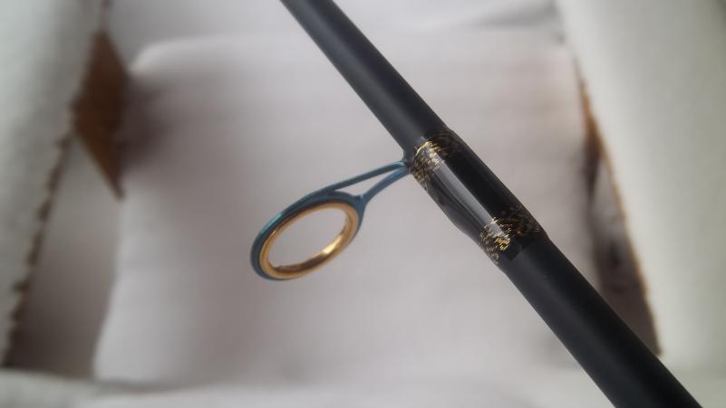

This is the product I use in building custom fishing rods. Its for finishing the thread wraps. Looks like glass and wont have any discoloring issues. Sets SLOWLY and needs to turn at low rpms for several hours. I'll try to experiment with it for blank finishing sometime...
