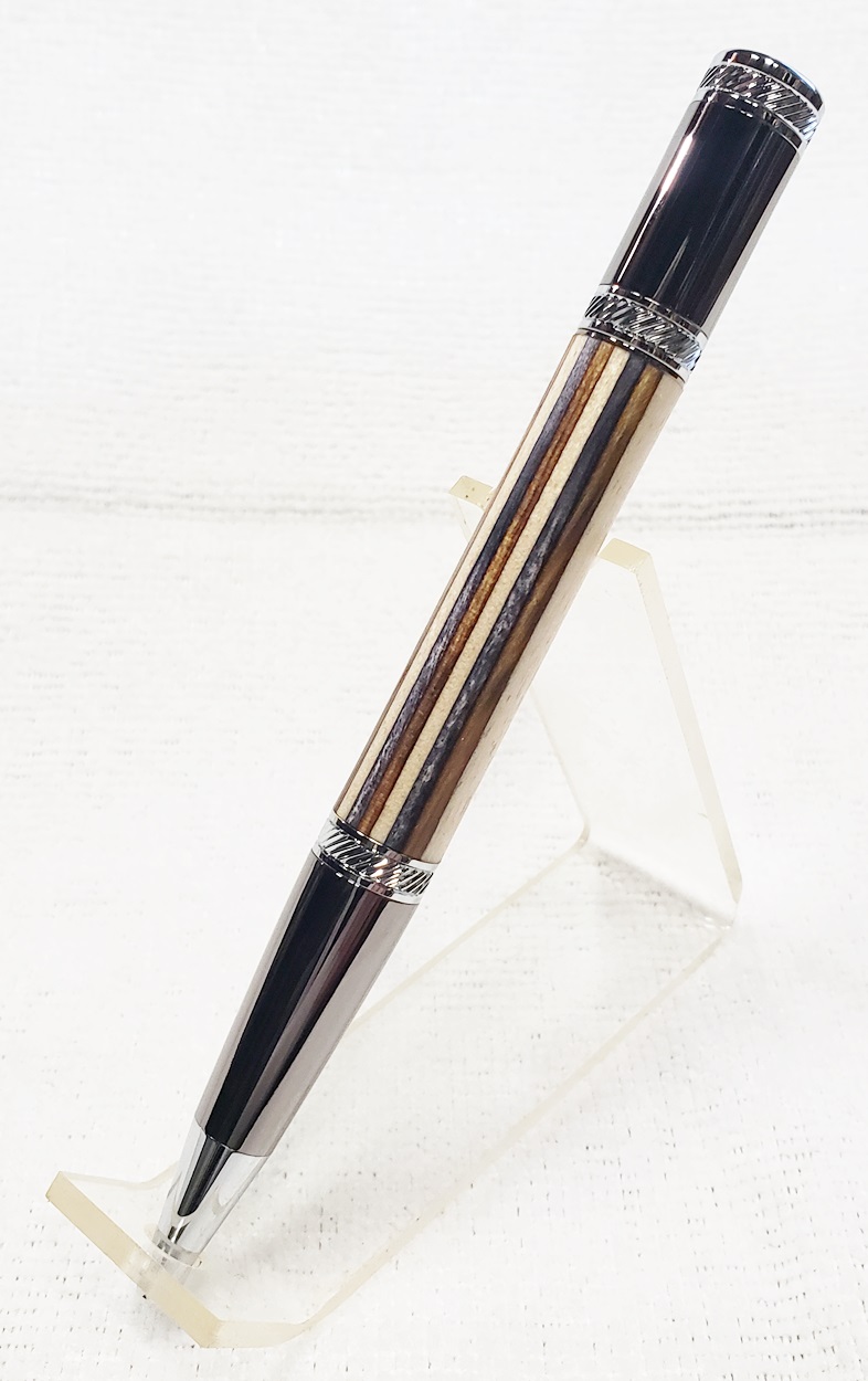

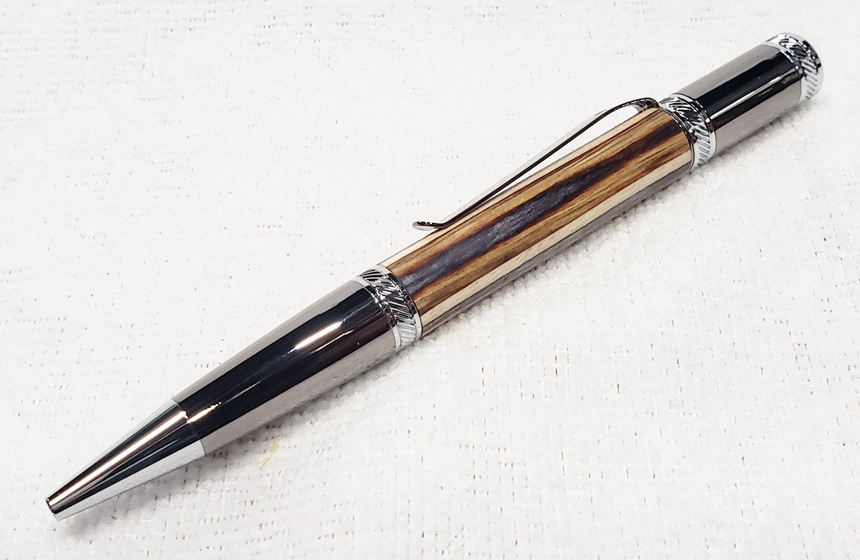

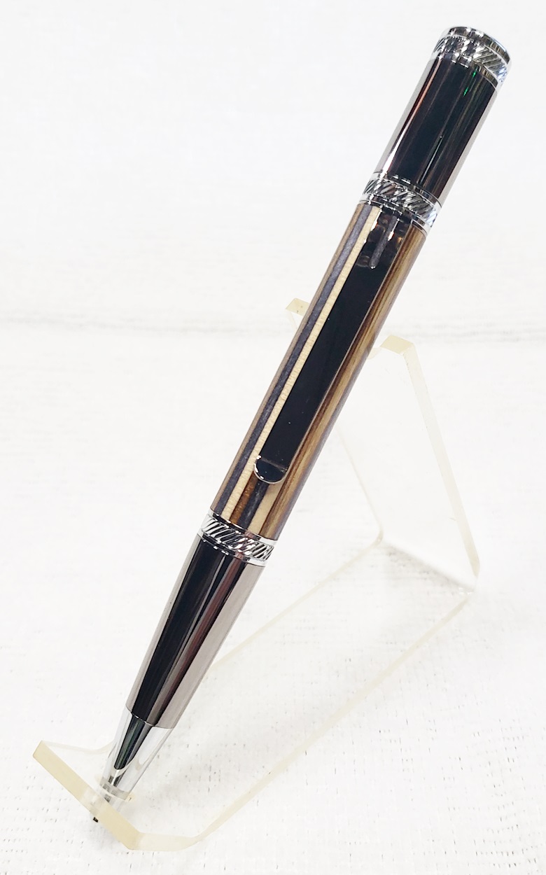

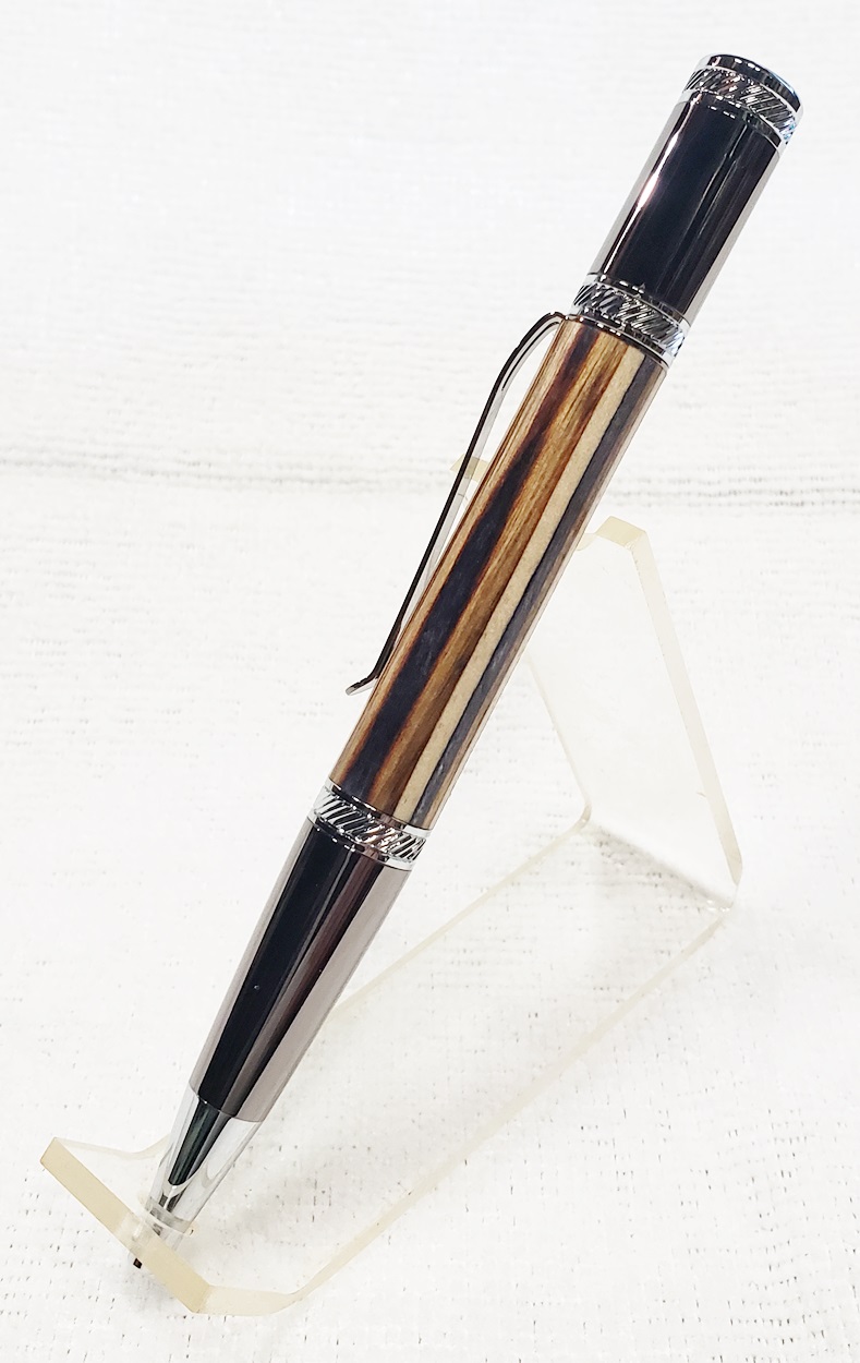

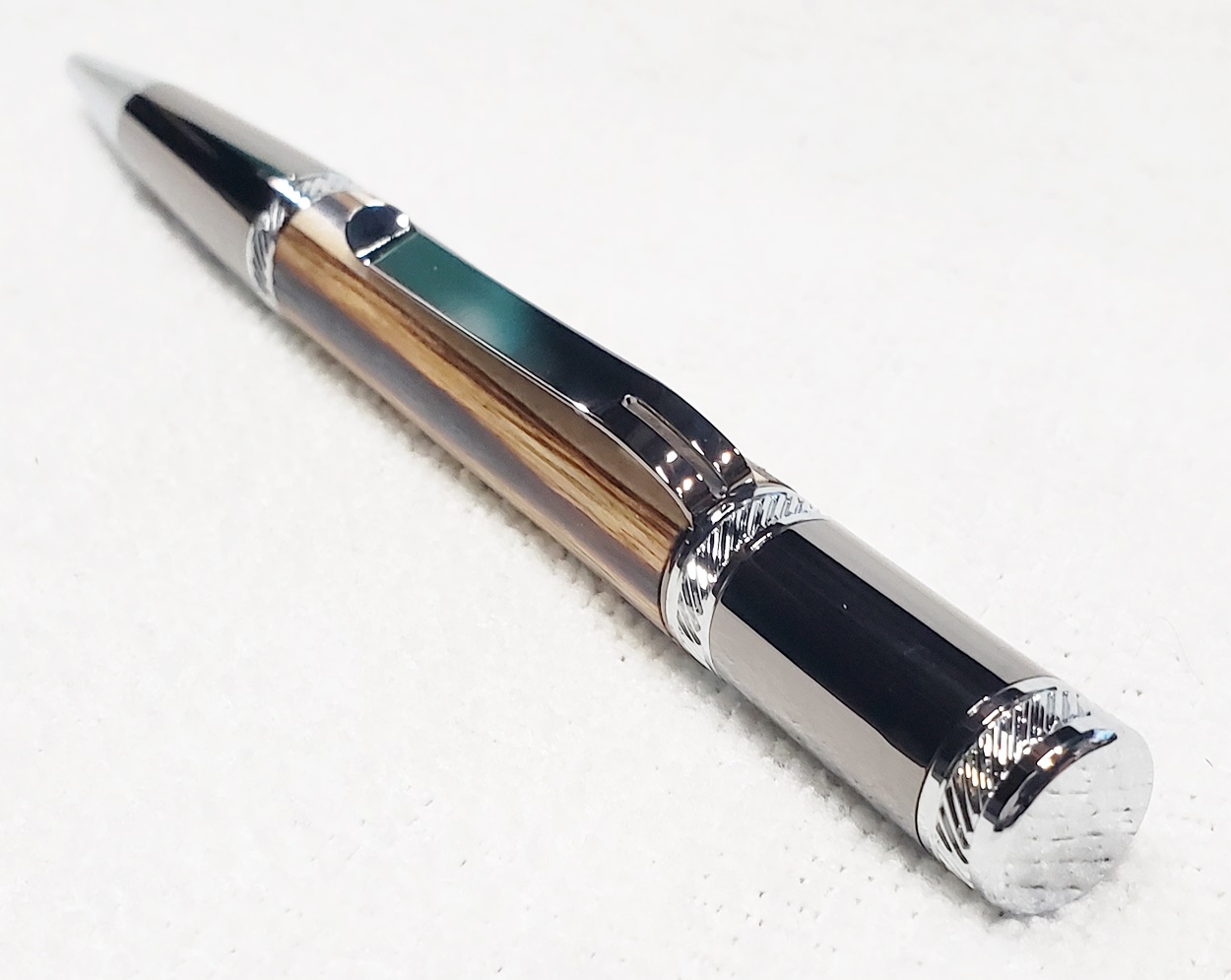

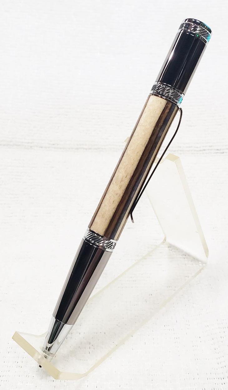

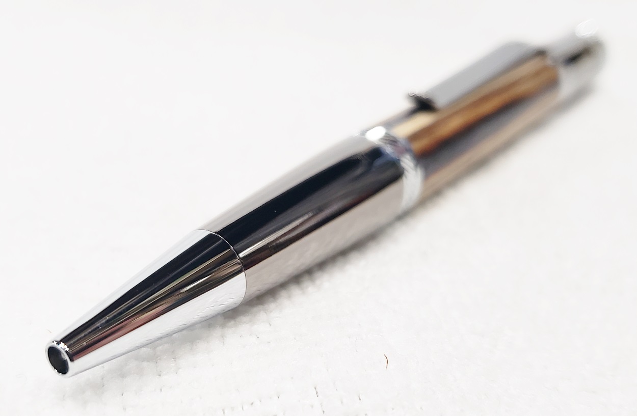

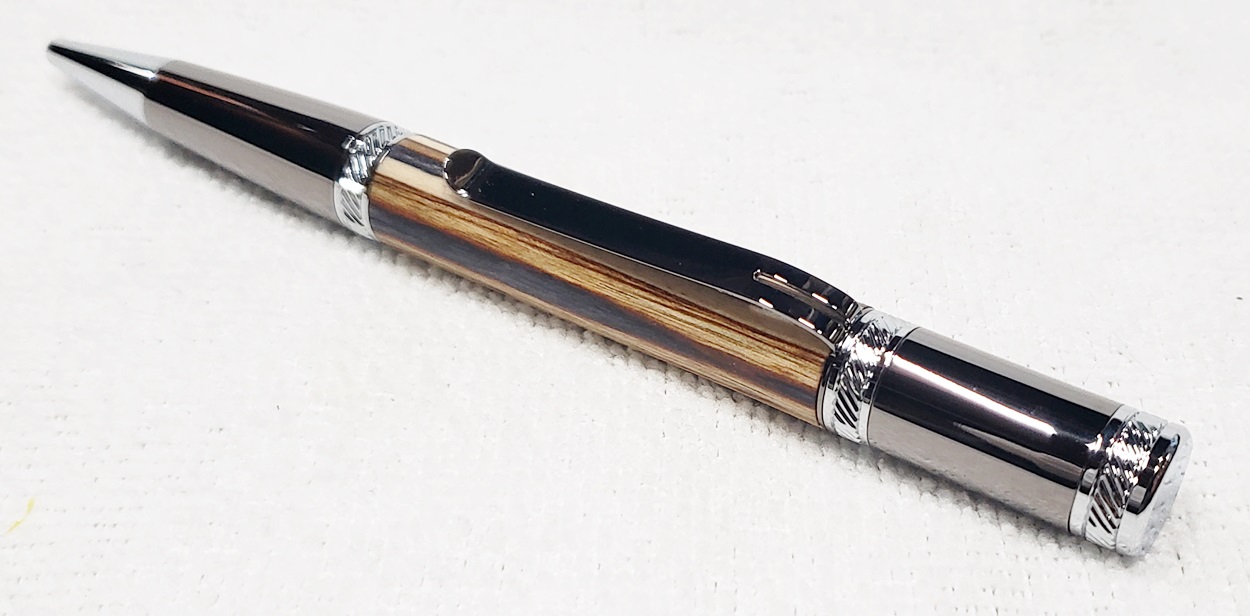

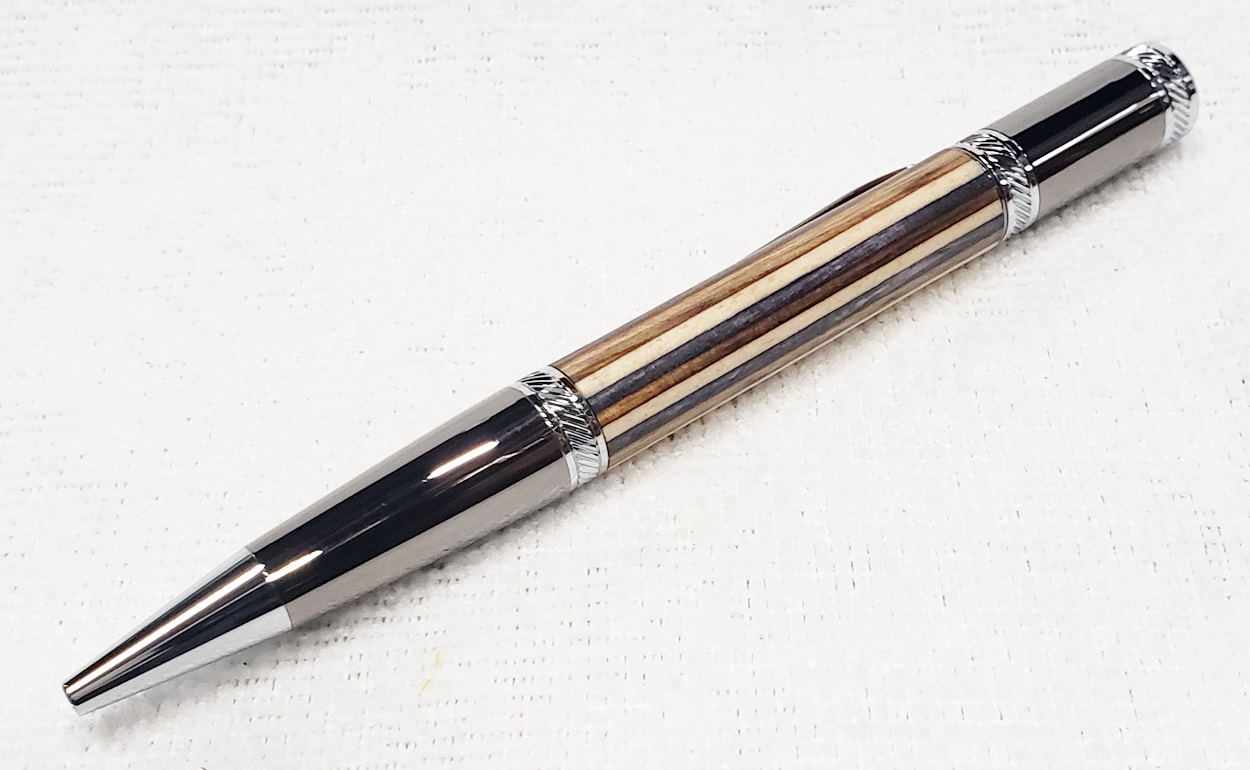

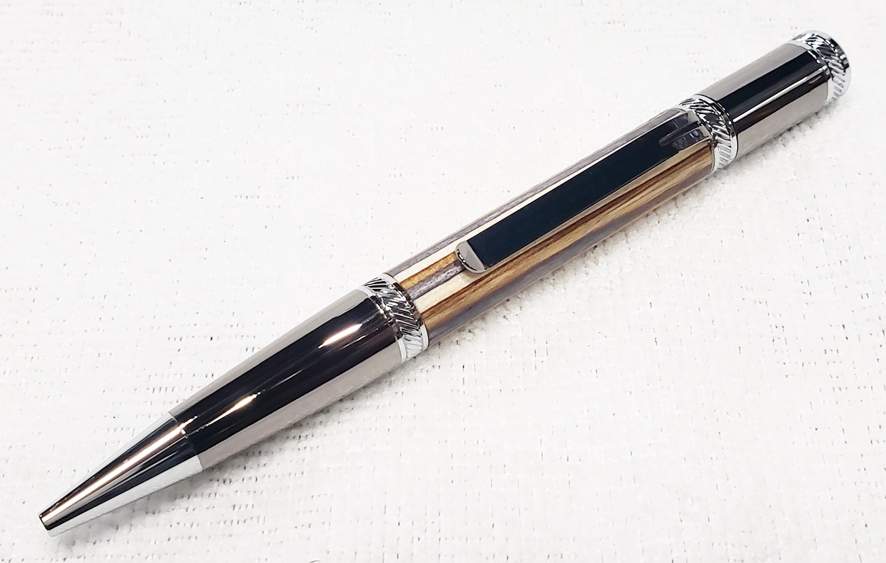

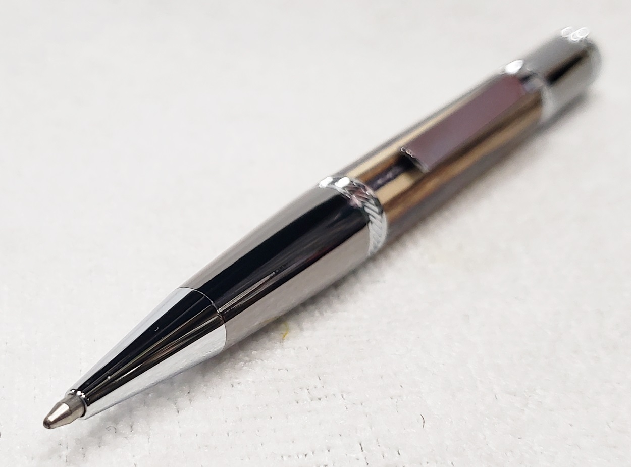

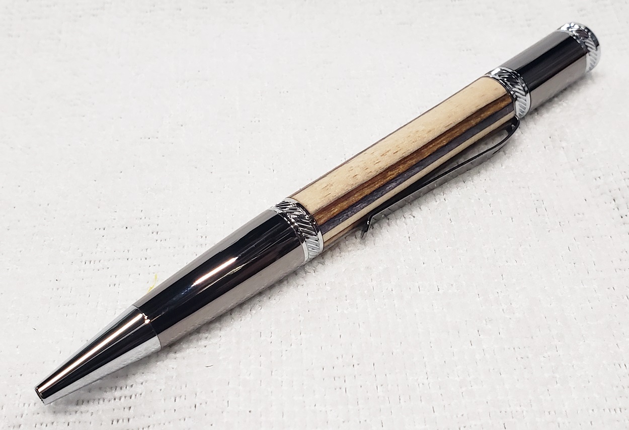

This is my second Woodcraft Enterprise (Berea Sierra Diverse) pen, also in gunmetal and chrome. I had problems with the first one, but got them sorted out with this one. I'm glad, I like the style of the pen. The blank is a SpectraPly called Buckskin, also from Woodcraft. The blank looks better than I expected, and goes well with the pen. Very happy with how it turned out.

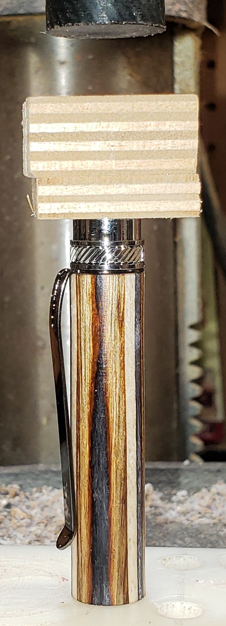

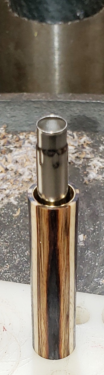

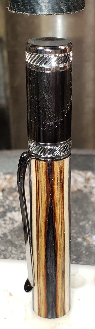

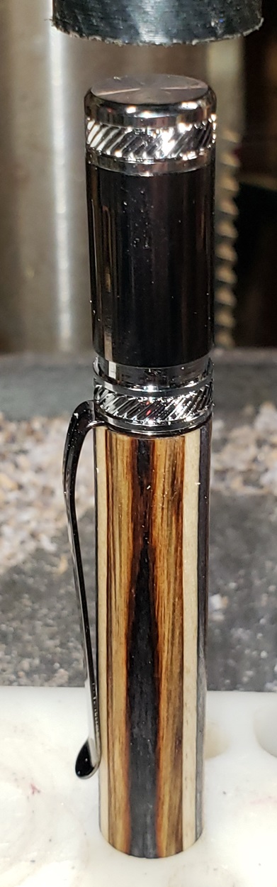

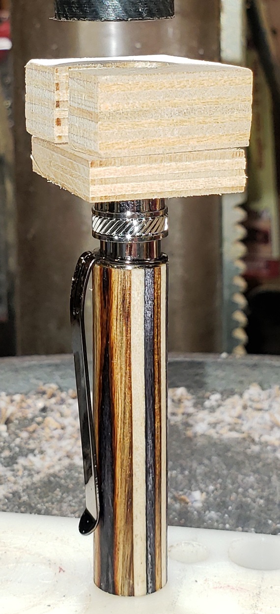

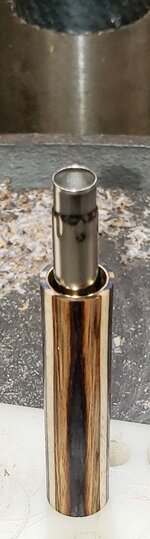

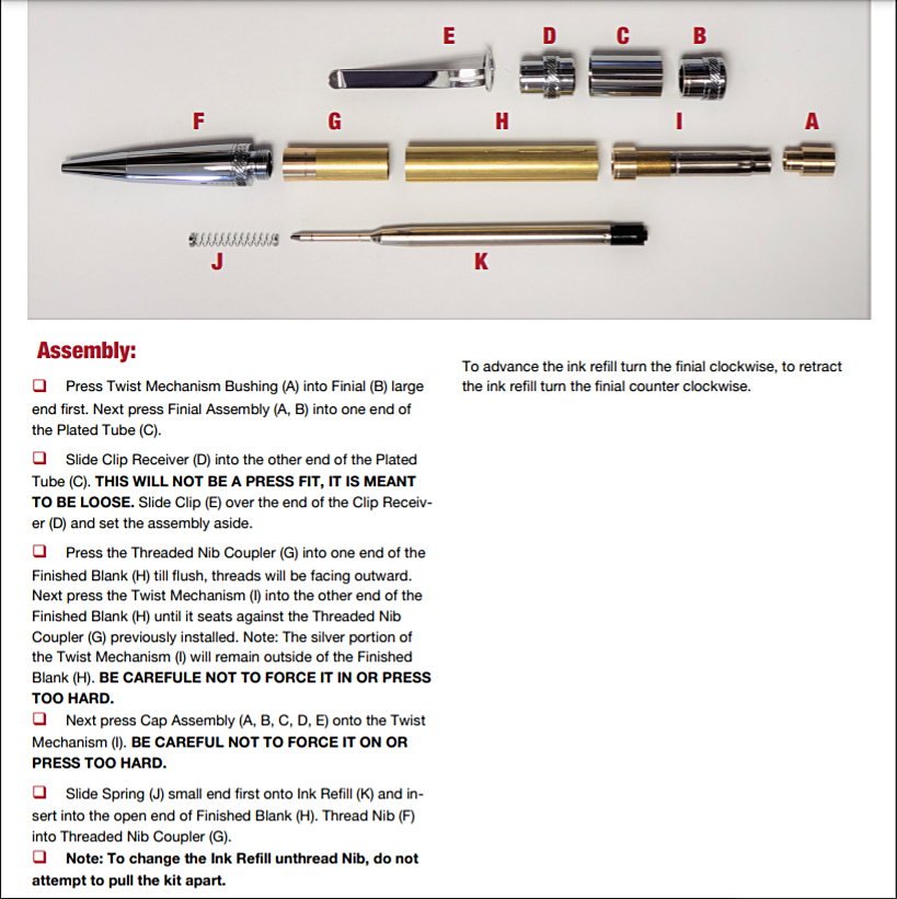

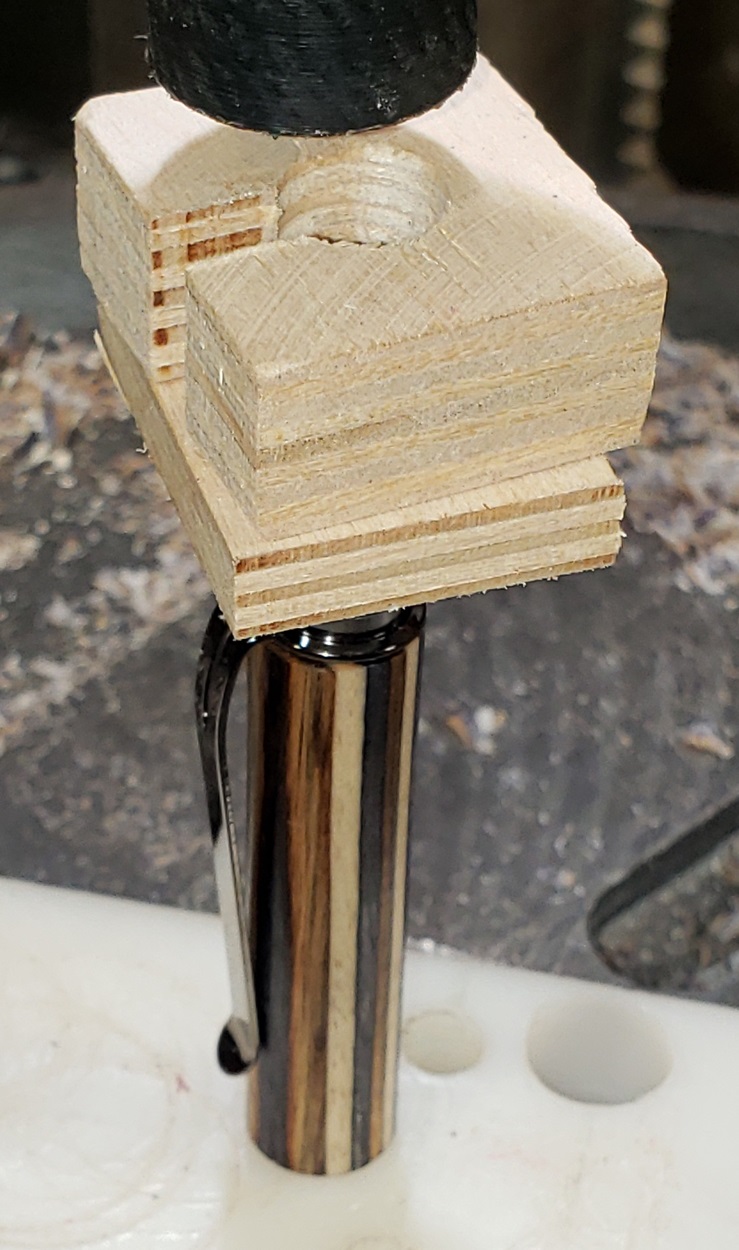

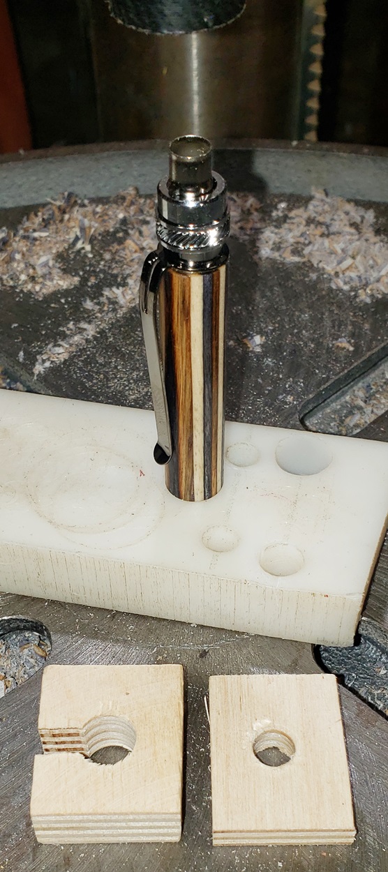

The instructions call for assembling the finial completely before it's pressed into the pen. But I found this puts too much pressure on the twist mechanism, because the clip receiver (D) has to be pressed in tight enough to keep the clip from rotating. So I pressed in the clip and receiver (D, E) before pressing in the rest of the finial. This allowed me to press the finial in just far enough so it doesn't jam the twist mechanism. Success!
