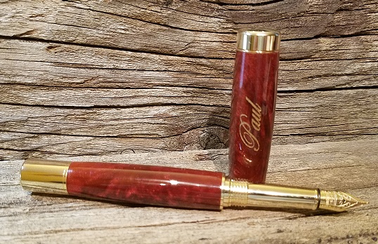

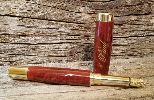

Long story short, I wanted to be able to reliably engrave acrylic. In particular, Rhino blanks, as they are the one's I typically use. I tried a bunch of different methods to get my laser to engrave rhino plastic blanks, to no reliable result. But finally, I figured out a way to do it. Low fire ceramic glaze.
I might also add that I update my software to the Neje laser Printer extended software. I can dig up the link if anyone is interested. It gives a longer burn time.
So I turned the blank, sanded, micro mesh to 12,000 but didn't buff it with wax as usual. I brought it in the house, and brushed on one thin coat of low fire ceramic glaze. (I tried two coats last night, and it didn't work) I ran the laser 4 times at max burn. One right after the other. Then I just washed off the remainder of the ceramic glaze. The engraving was deep enough for me to use rub and buff on it, and it turned out really, really well. ( I have enclosed a picture) I will take it out and resand it with 5k, 7k, and 12k. just to clean it all up.
