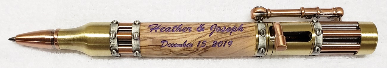

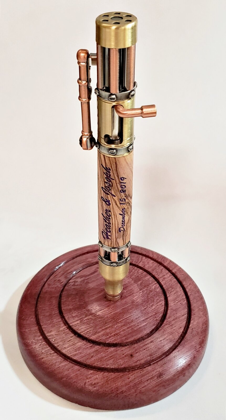

I always have my pens engraved with Brush Script. I don't know why, I just like it. This is my son's and daughter-in-law's wedding pen.
I am assuming the engraved color is not form the engraving process. Do you engrave then paint then sand back to wood?
No, the engraving company engraved through masking tape, filled it with paint, then took the tape off.
