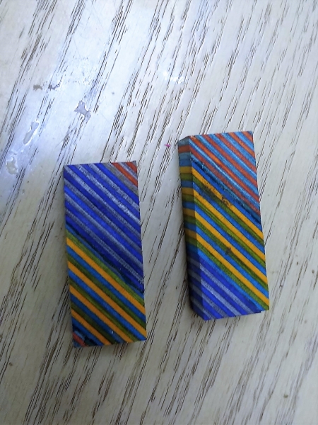

One interesting way to do this is to take six different spectraply blanks and glue them together into a 5x5 block. Then cut them on a 45 degree angle to make diagonally striped blanks. They produce "rainbow" pens when turned. The short ones from the corners can be further glued together to make even wilder combinations.
You can also do this with various widths of contrasting woods, then cut them on the diagonal to make segmented pens.

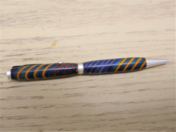

Rainbow blank and rainbow pen. Gwen was able to get in today to turn again because of a cancellation, and she made this rainbow pen. She had a little chipout right at the centerband...a problem with turning spectraply crossgrain.
