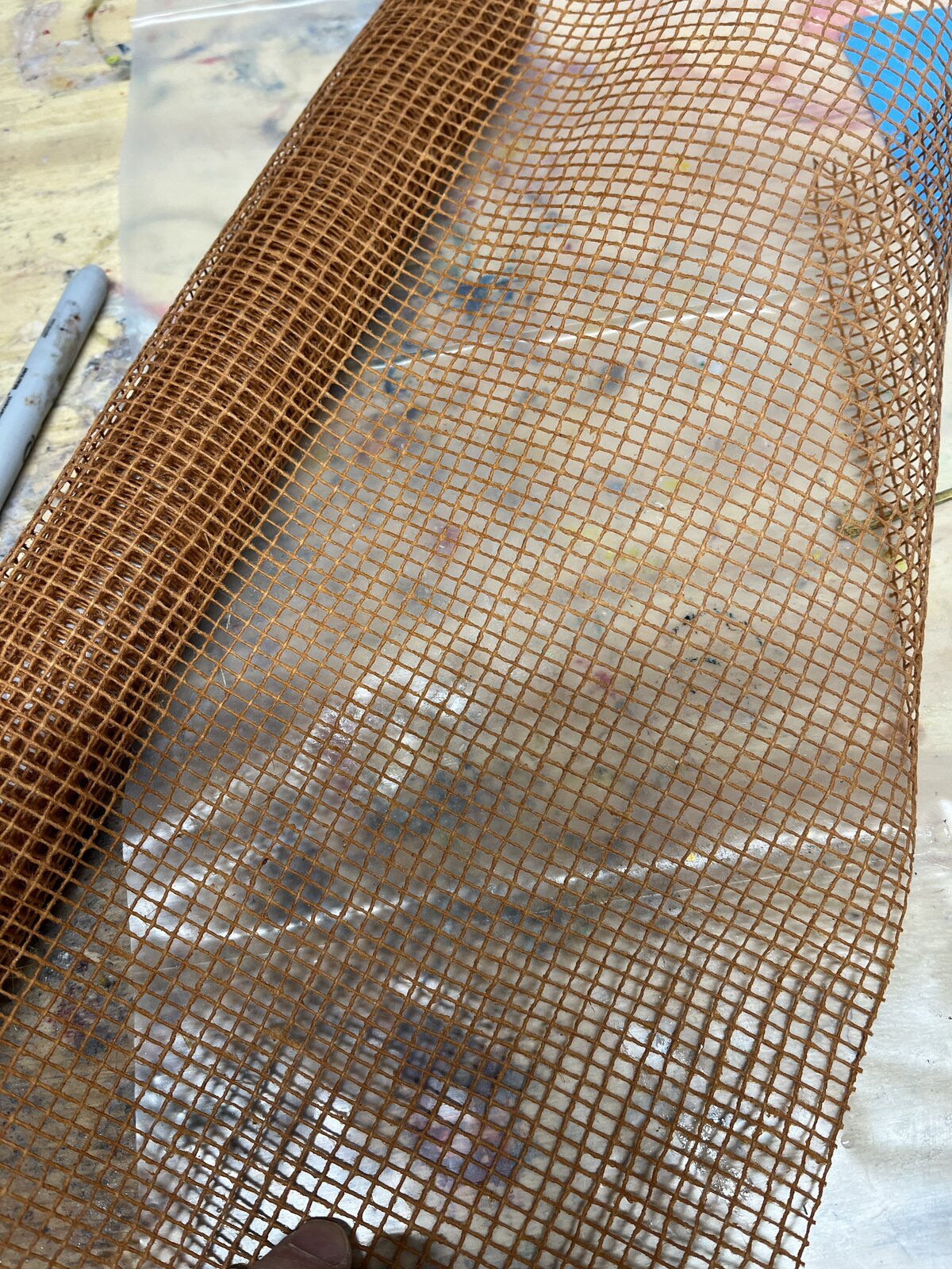

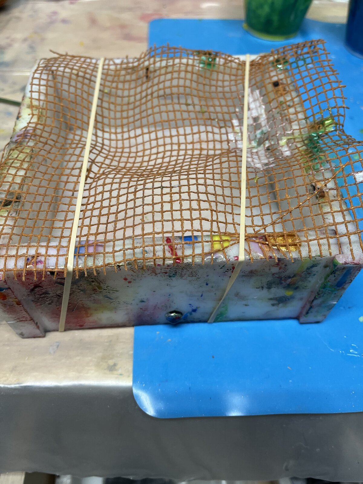

Easy fix Bill. Get you a roll of 1/4" natural braid from hobby lobby and cut a piece to be held over the mold with rubber bands that you can pour through. Other options are bags oranges or onions come in, pull a bath scrunchie apart or a piece of wire fence. I prefer the soft material and throw it away after a couple uses.
