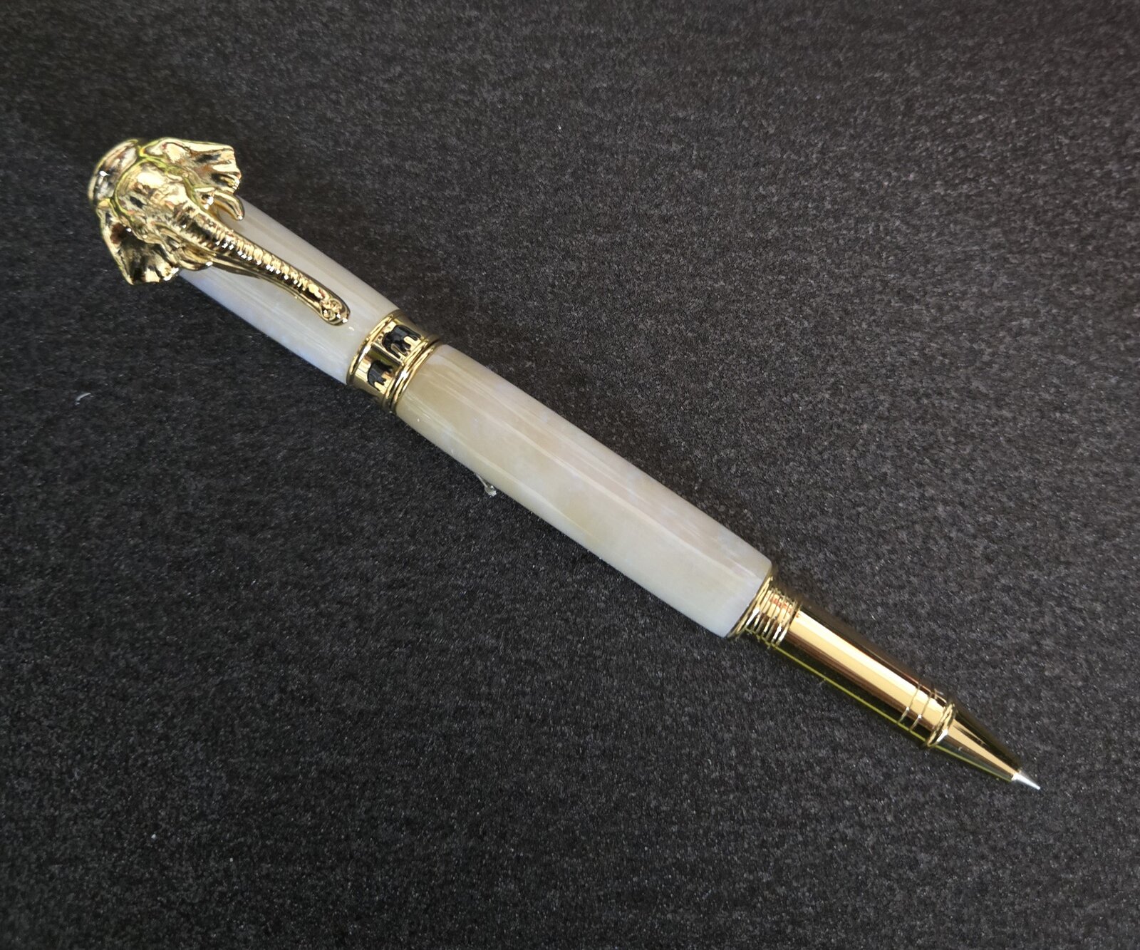

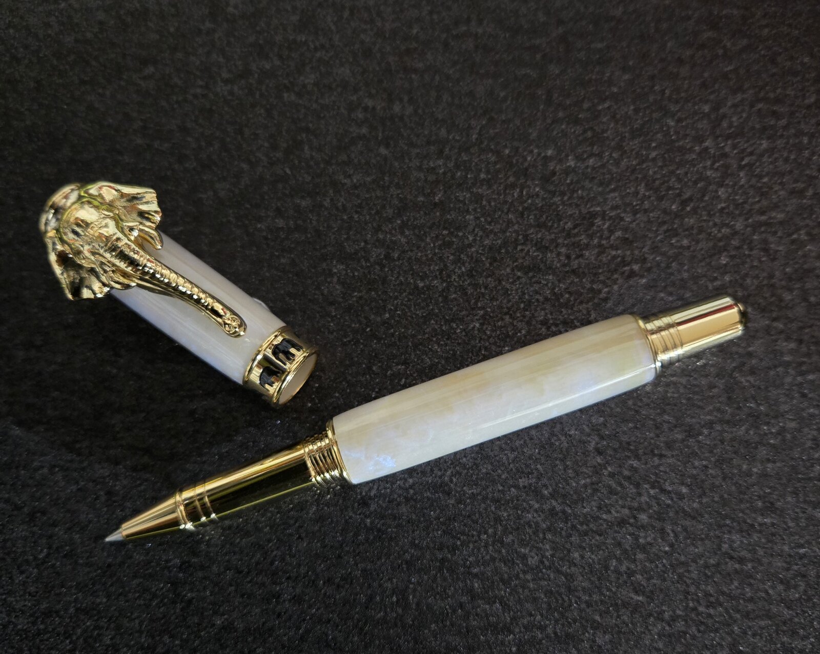

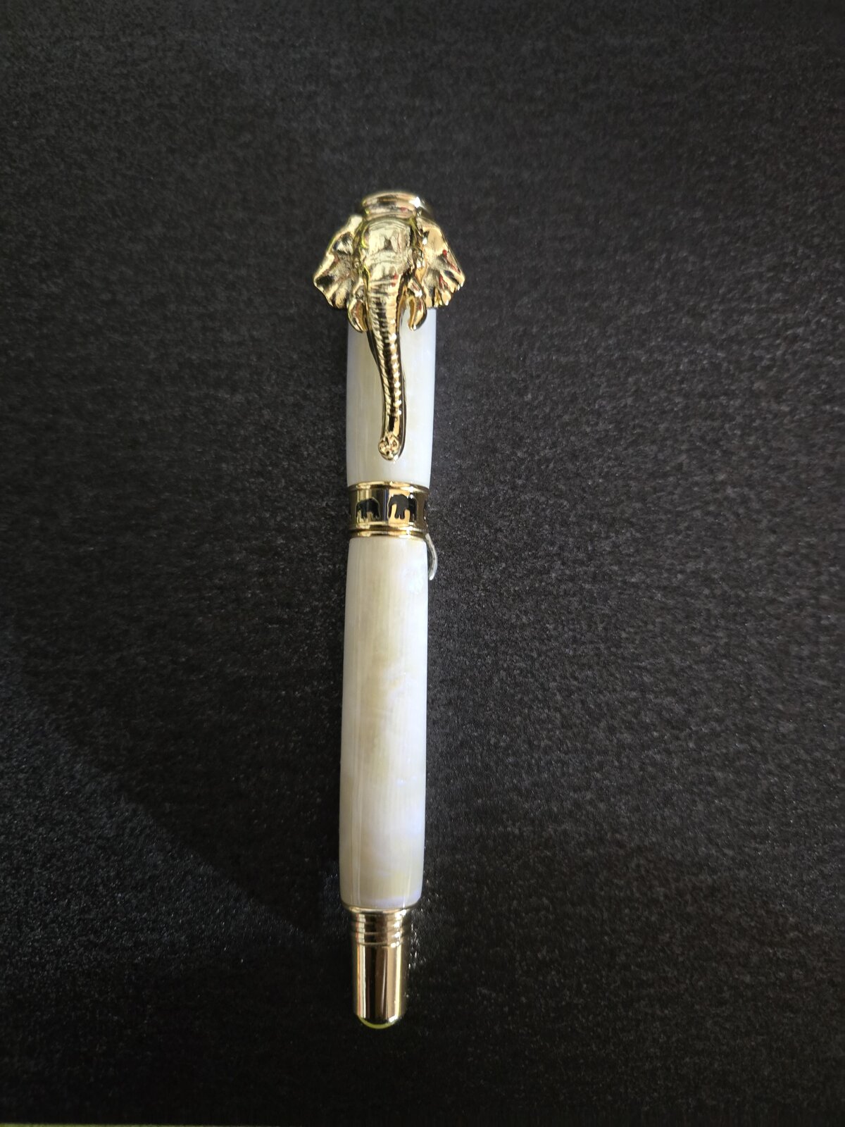

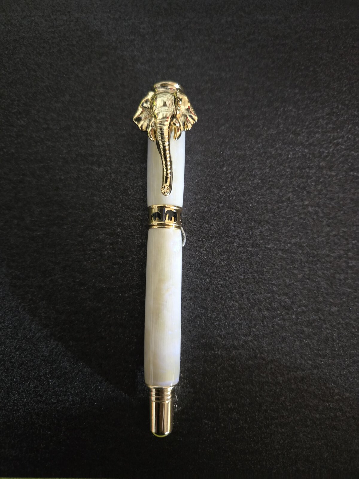

Inlace acrylester isn't the easiest media to work with but I really like the results. Carbide tip to rough shape the blank then dry sand from 80 grit to 600 grit. Wet sand from 1200 to 12000 then 3 step Novus polish. These pictures really don't capture the brilliance but you get the idea.
