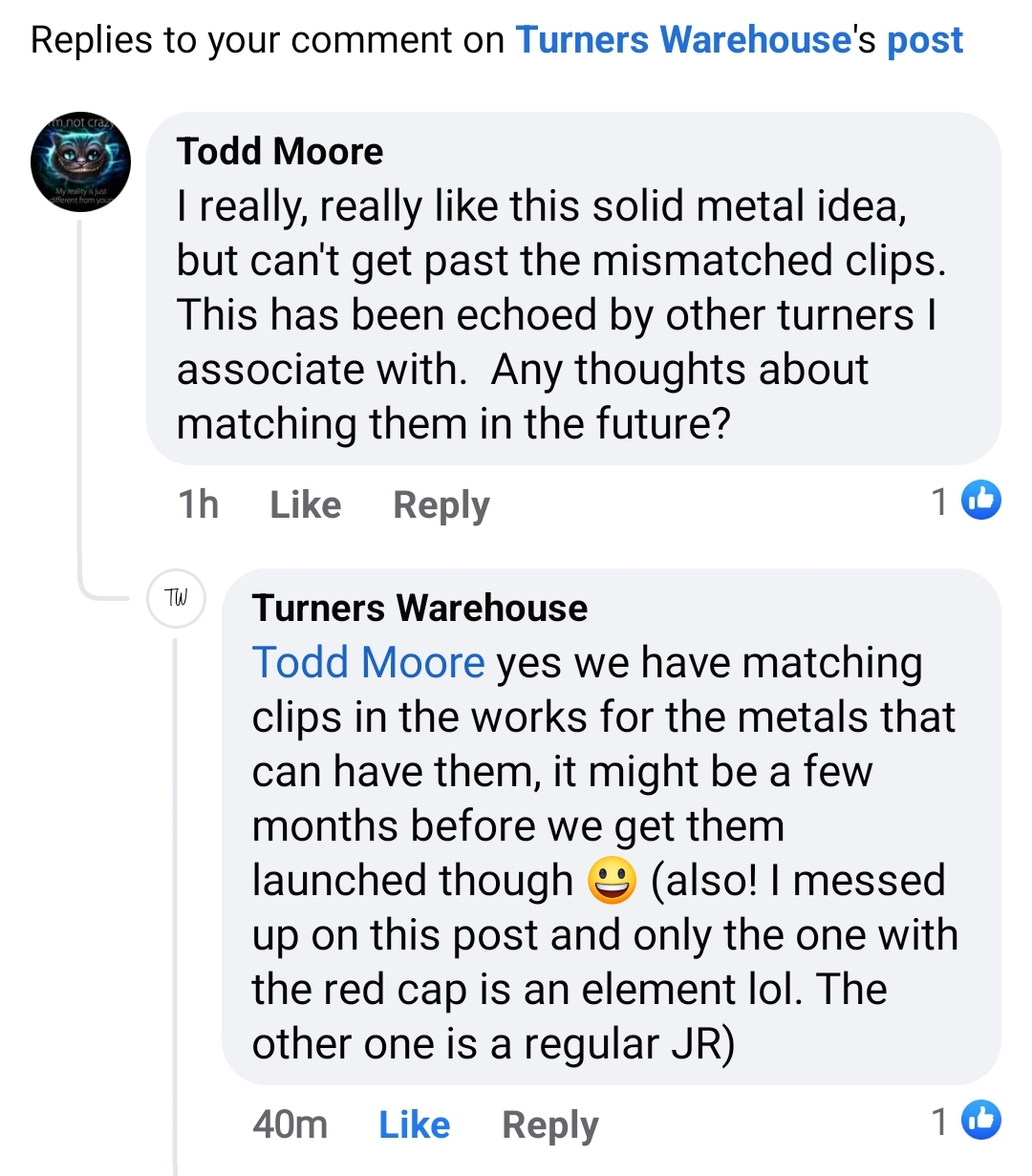

I mean... I know a guy making stainless kits here in the US with matching solid metal clips... :) Honestly one of the reasons we haven't done brass, etc is because I don't have it in me to have a non-matching clip. Brass is a TERRIBLE clip material so we may look to our friends at Ionbond to do some coatings for us.
I just saw these a few days ago and was intrigued. It is not necessary to age them as shown, but to allow them to pick up a natural patina over time sounds nice to me. I like the antique/heirloom look. I do very much agree that the mismatched clips are a deterrent, though.

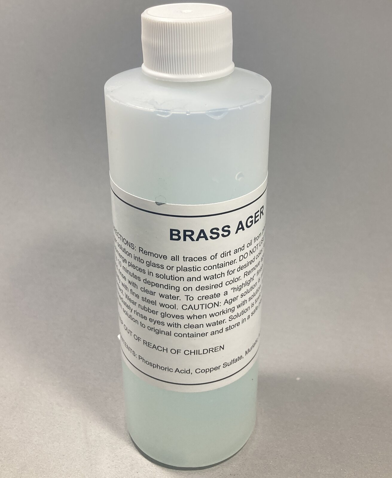

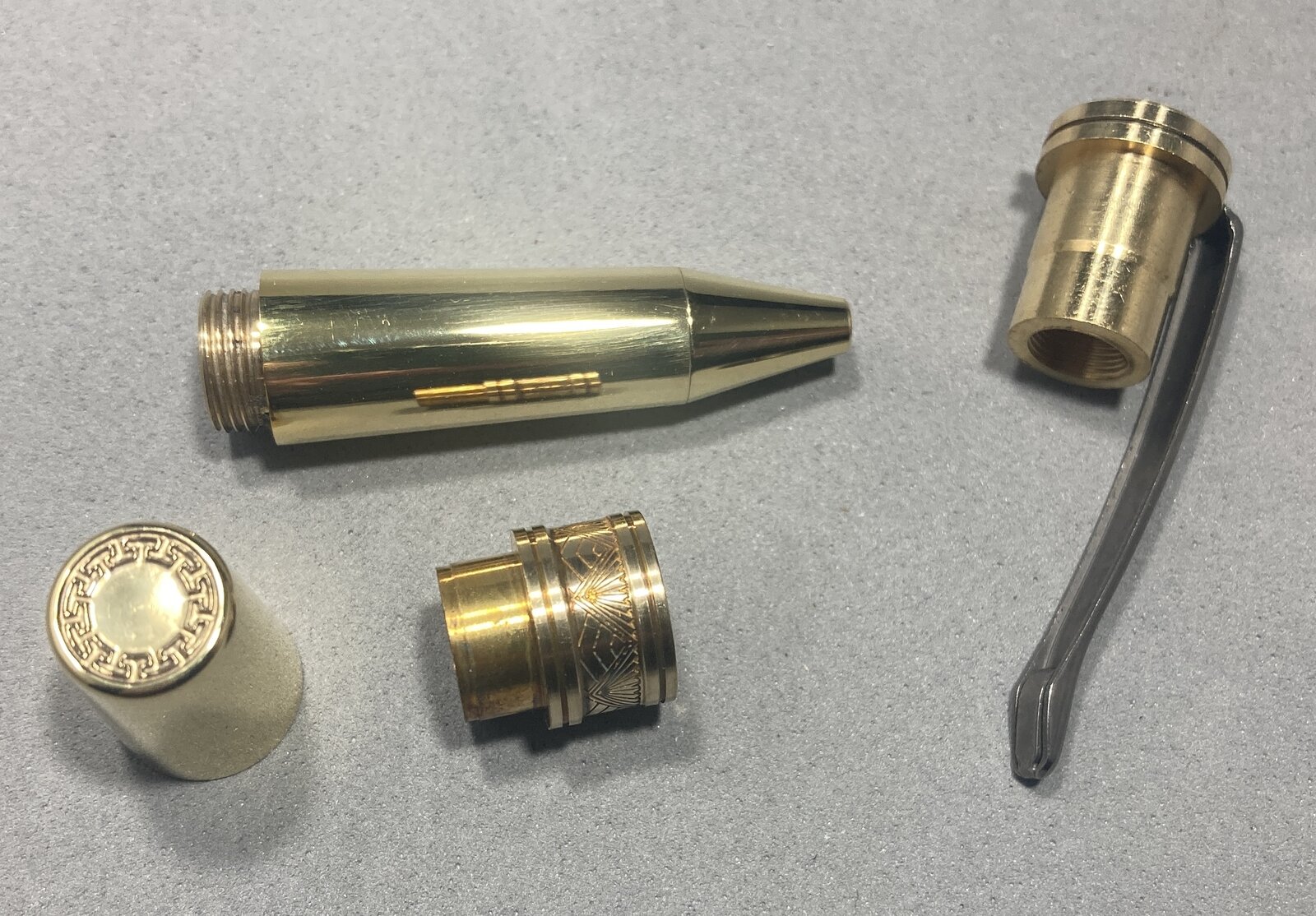

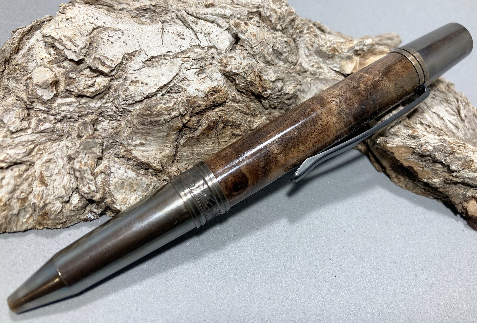

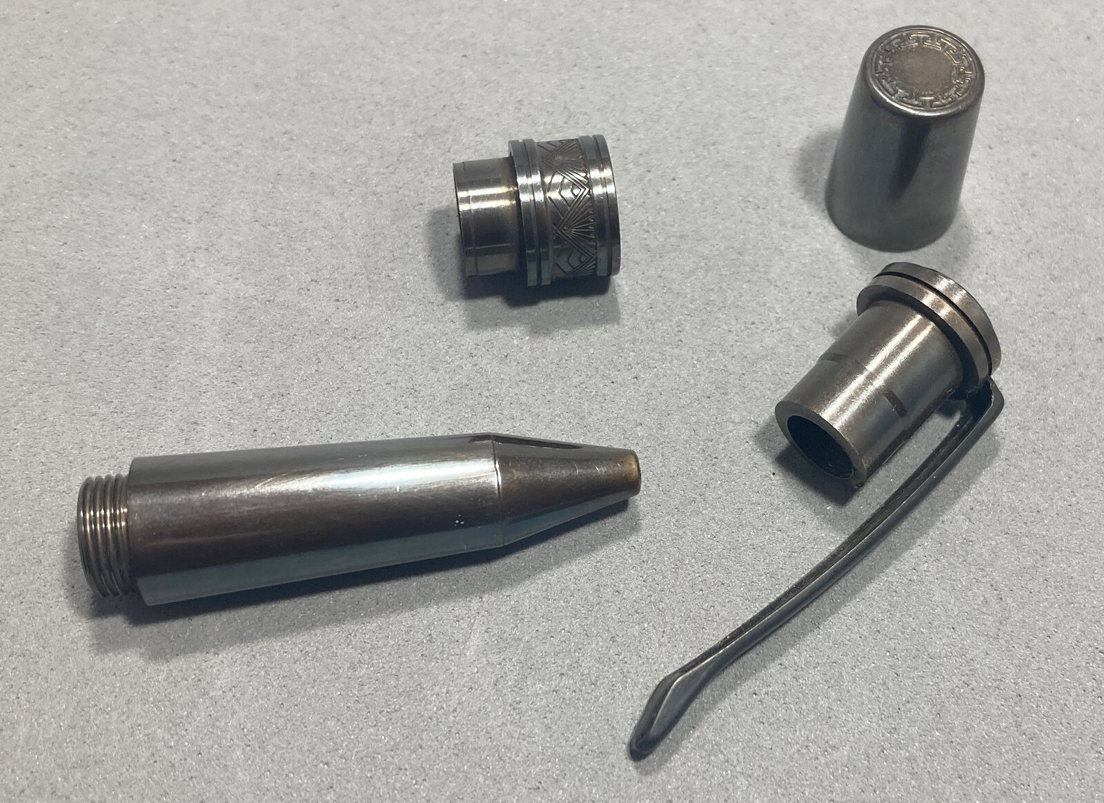

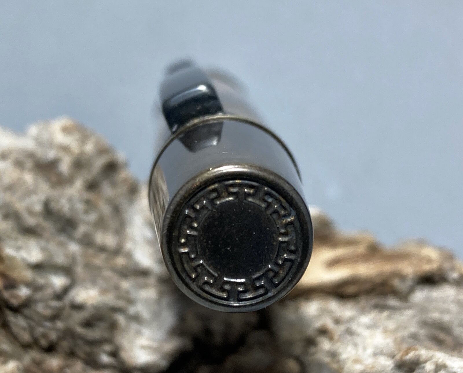

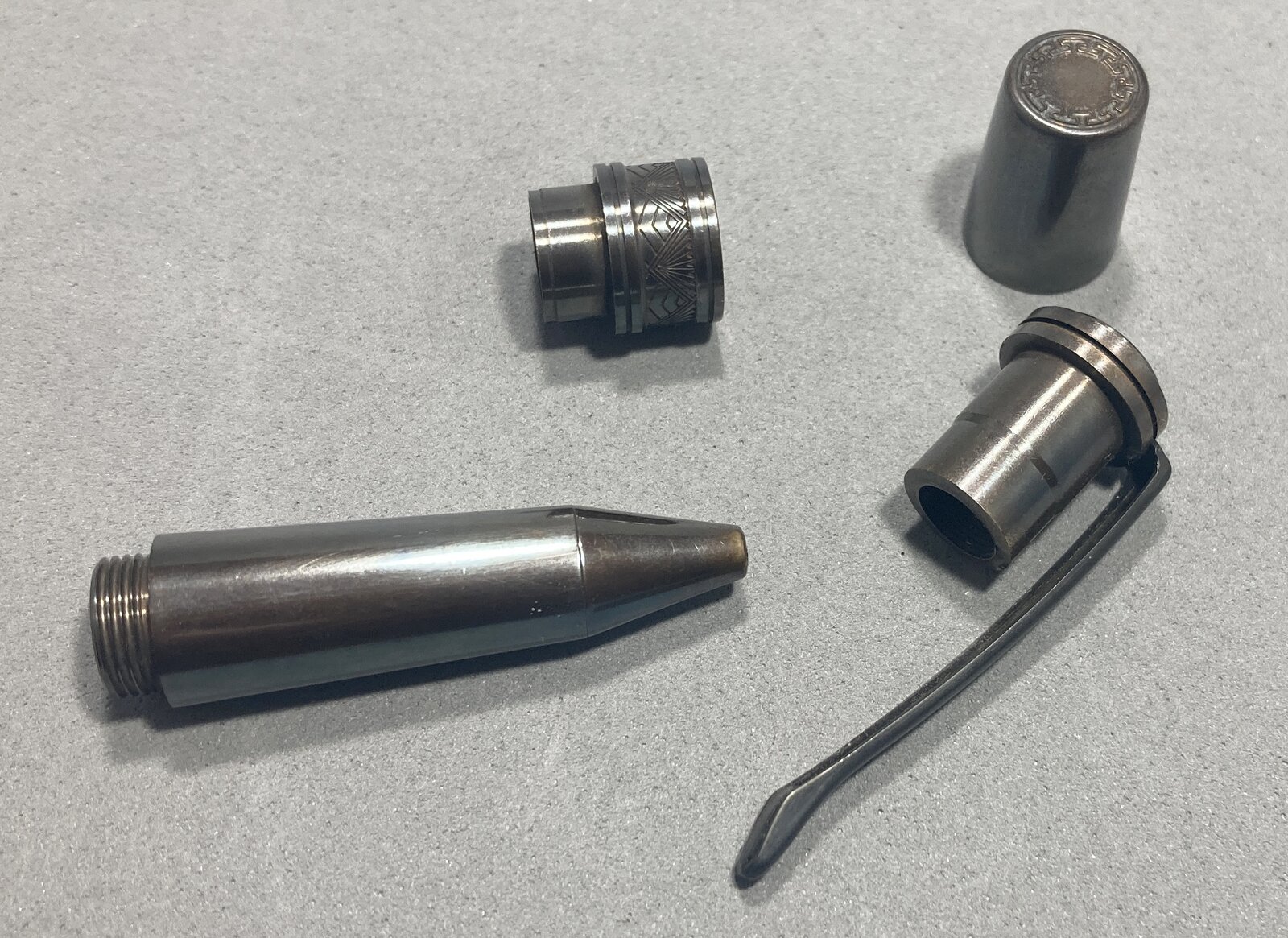

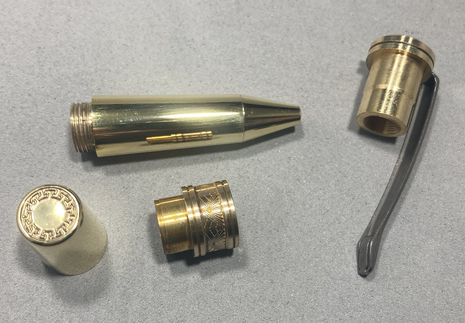

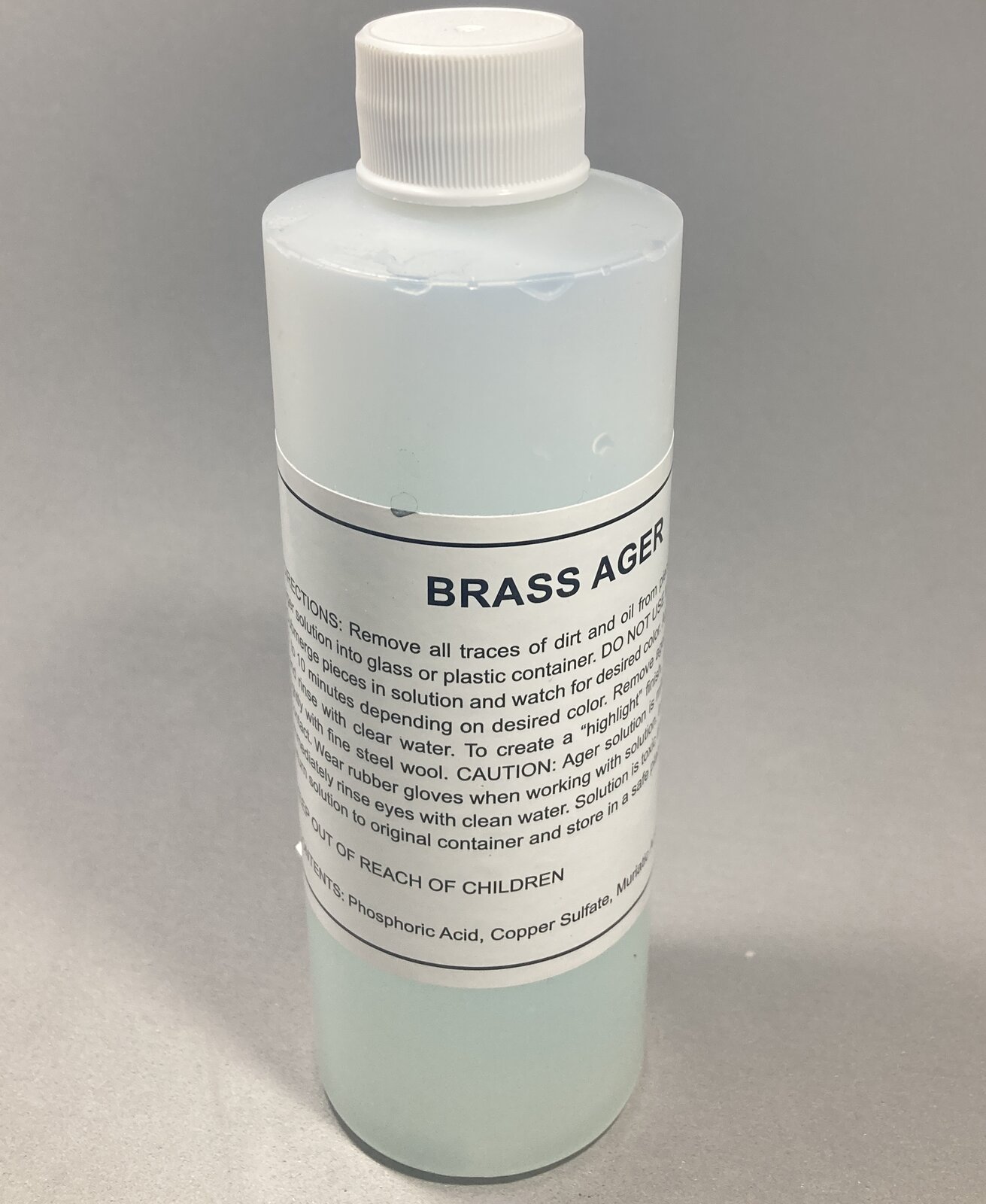

So when John started this thread, I had already ordered several of the element kits (one of each Brass, Aluminum, Stainless). I didn't weigh in at the time, because I had nothing to add to the conversation. Well, I have now made one of the kits (the Brass Ballpoint, which is basically a Sierra). The brass parts arrived very shiny, but I opted to speed up the aging process with some brass ager.

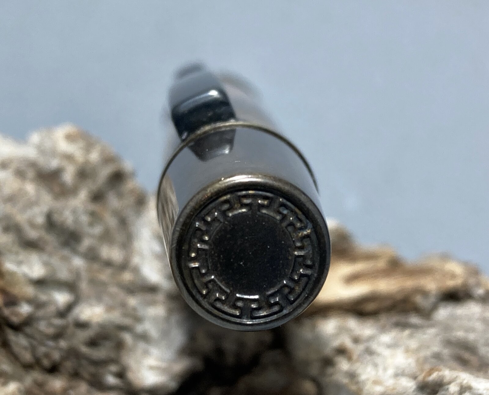

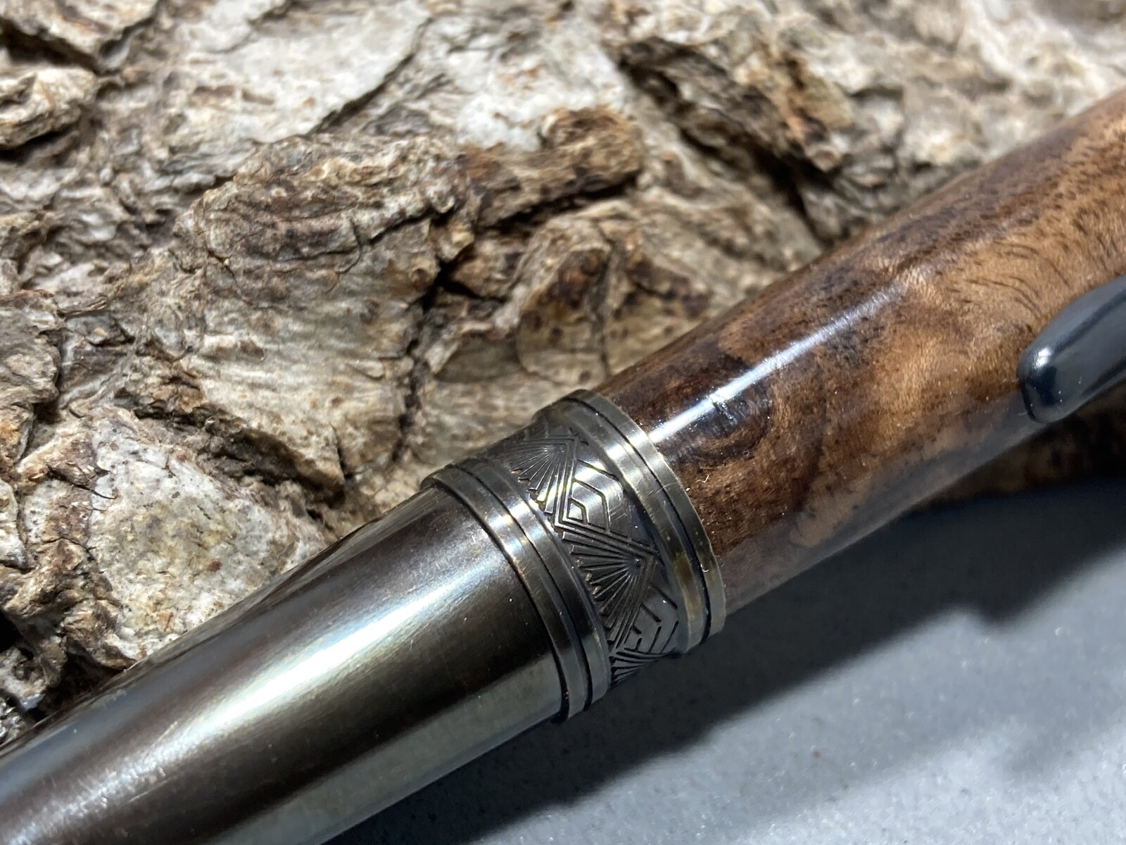

The ager solution (I got it on Amazon) worked very quickly (less than 1 minute). I tinkered around with it, dunked the pieces a little longer, and you can see what I ended up with.

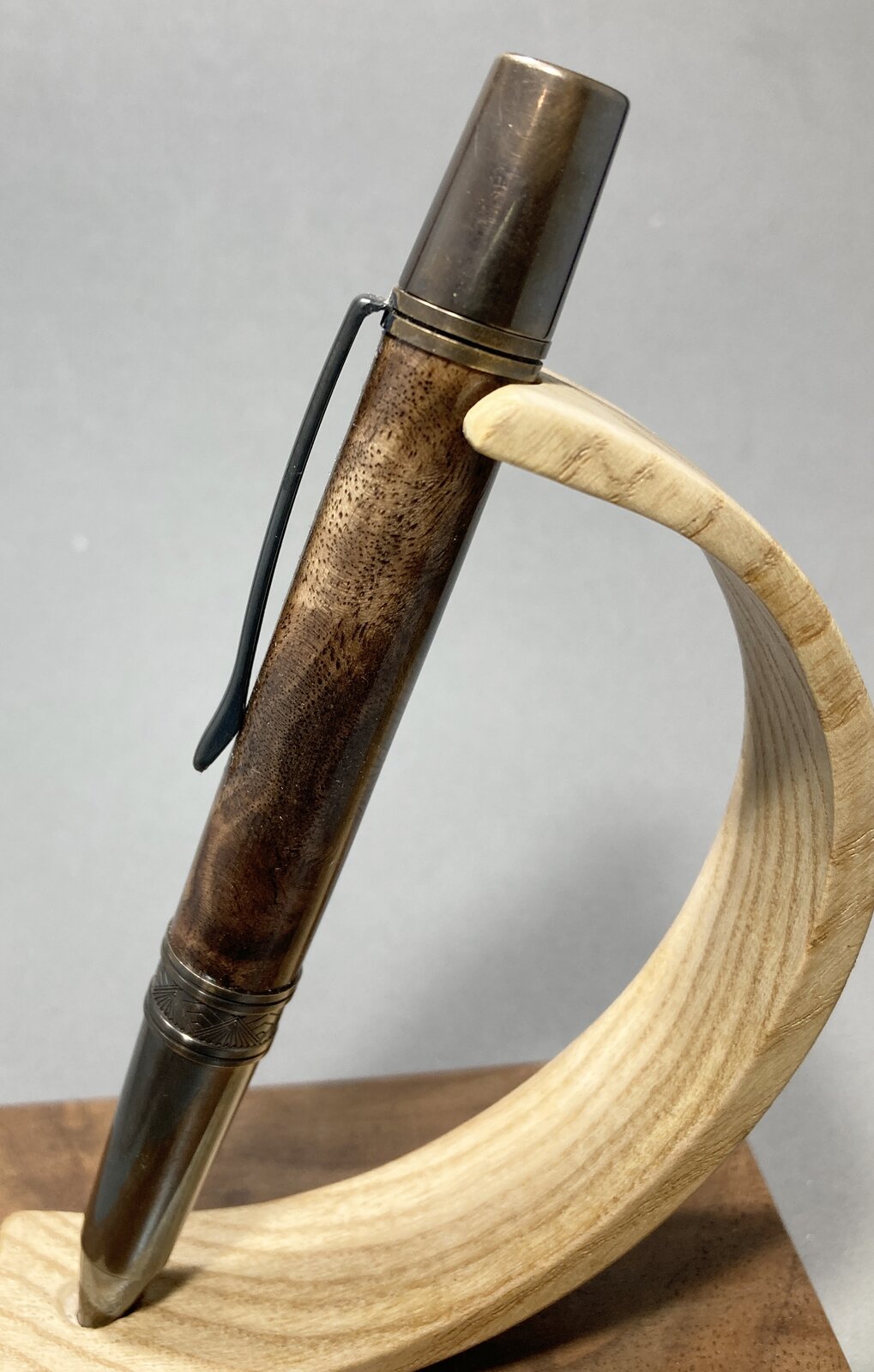

I will say, the parts have a nice weight to them, being solid metal. The pen assembly was uneventful. Here is the finished product:
I don't know if the brass ager changed the surface chemistry of the brass parts to reduce additional aging, but we'll see,
I do have to say, the video Turner's Warehouse had on their website to promote this new line of pens was terrible. It showed a finished pen that looked like it had been pulled out of a dumpster, encrusted with blue-green oxidation, like a pipe that seeped/leaked for several years (DAMHIKT). But I think applying an aging solution like I used to give the pen a decent, consistent "Patina" looks pretty nice, in my opinion.
I also need to add that customer service at Turner's Warehouse told me to just use regular Sierra bushings, which I did. I turned the Walnut down to the bushings (to 0.472"), but as you can see in the photos, I overturned the barrel. I should have stopped at about 0.490".

Step back in time.:) I and many people use to use that brass ager stuff many years ago to blacken pen tubes when needed. I can remember dunking in that solution. I probably still have some of that somewhere. Those kits may have a certain following who knows.
