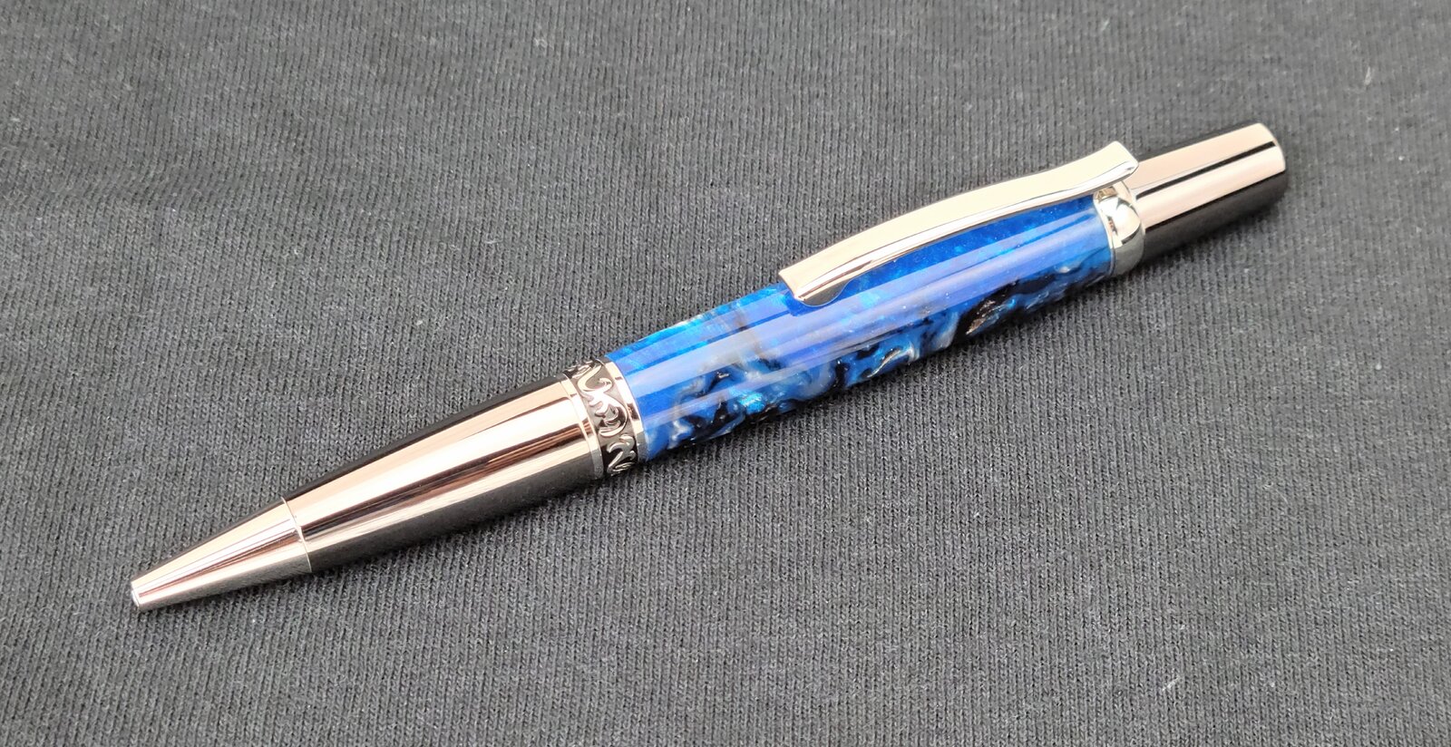

I've had a bunch of pens drilled, painted, tubed, trimmed, etc, and ready to toss on the lathe for a while, but there have been way to many adult responsibilities lately. And then, after a week of COVID, I was a little stir crazy, so I finally got out for a motorcycle ride yesterday and in the shop for a simple pen today. Yay, me. I guess I'll have to go back to work next week, though 😞
Anyway... this is one of the new Elegant Sierra iterations with Black Ti and Platinum plating. The blank is Blue Damascus Inlace Acrylester. It's always a pain to drill, but it sure did turn smoothly with a radiused square carbide cutter. That's going to be my go-to for Inlace going forward. It was wet sanded/polished through the Zona grits, and try as I may, even with some plastic polish, the radial scratches would not go away, so I got out the buffing wheels. The barrel went through the tripoli, white diamond, and carnauba routine and finally, I am satisfied with the shine.
