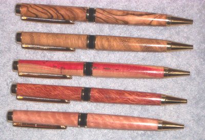

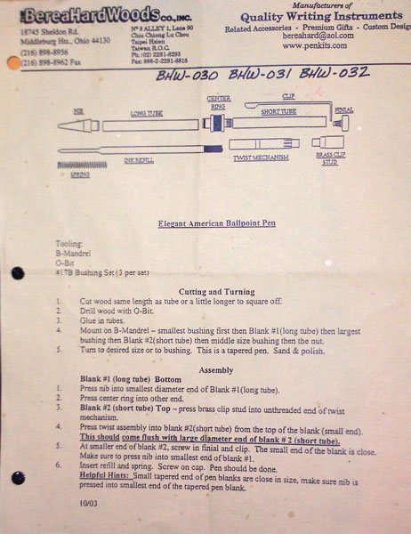

Eagle,
Here is a picture of a five of them and the instructions. If you can't make out what you need from this picture of the instructions, let me know and I'll send another, larger to your private email address.
