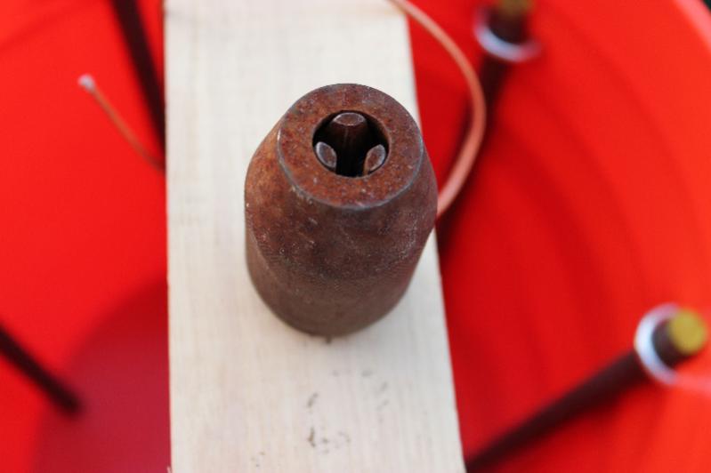

After much reading on the internet about Electrolysis for removing rust...I have finally assembled all the parts for my tank and have done my first test... before i start dunking my metal lathe, for restoration.

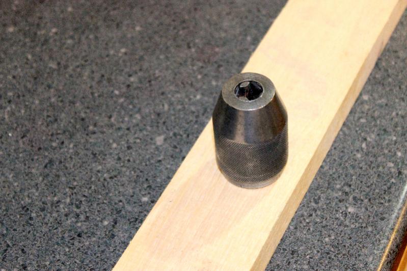

This is a chuck from an OLD hand cranked brace that was in my father in law's shed. And to say the least...I am amazed at the transformation.... 30 minutes in the tank and two minutes with a green scrubby to get the oxide off... and Ta' Daaaahhh! Im excited to get started on the lathe tomorrow!
Remember to fully disassemble the parts. In other words don't put gearboxes and bearings etc in like you did with the brace chuck. You can't be sure you have all the liquids out of the nooks and crannies so the corroding starts anew.

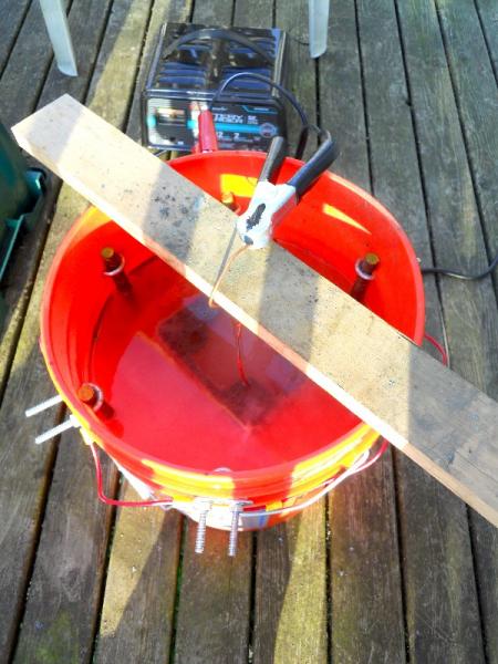

Looks impressive. If you don't mind sharing, what was required to accomplish this transformation and how much was the investment? Thanks.
Hi Glen,
$6 Rebar (there are six)
$3 Orange Homer Bucket (i have several already...)
$3 Large box of Armor Hammer Super Washing Soda
$3 For six U-bolts to hold the rebar
$0 For the battery charger ~ i had it already too
$15 total
and OMG... this thing strips paint... even in the NON rusty areas like no bodies business.... Electrolysis Rocks...I'll post some pictures later this evening of what ive got going so far!
Pete...you are right! ... as soon as it comes out of the tank... i blow it dry it then i either primer it or oil it very well :smile:

before and after
Set up before water and washing soda
The process is line of site. So having the rebar on the bottom and the item on wood slats, in addition to around the sides. will speed up the process.
Under way the foam bubbles will contain the hydrogen gas, had a idiot neighbor stop by and moved one of the clamps and it sparked and conditions were right for a nice loud pop and flash. He hasn't been back to ask me to fix anything since! :wink:
The rebar after 12/16 hours of working.
The same rebar after washing the crud off good to go till they are thin down to little wires of themselves.
Something to consider in choosing a container to use, NO METAL. Make sure it is strong enough to hold the water weight about 8 pounds per gallon. You can see what happens to the storage bins. Also you want to be able to cover the item.
I have since gotten a 40 gallon stock water tank from Tractor Supply with a nice thick wall and rim. I am planing on putting a plastic drain valve in it so I can run a hose to the side of the drive. to drain the sludge and rust off.
You must have the NEGATIVE LEAD CABLE connected to item being cleaned! The POSITIVE LEAD CABLE connected to grid of sacrificial electrodes. This is very important if they are reversed you will rust the item.

Glen... Those are FANTASTIC pictures... and every one of your links... with the exception of one... is exactly where i got my information :~) ( and a couple of YouTube links too)
Your First blue tube looks exactly how i did mine with the exception that i drilled my Homer bucked and used U~bolts to hold the rebar in place...then I used some 14 gauge wire and connectors to connect the U-Bolts/Rebar together :)

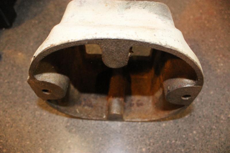

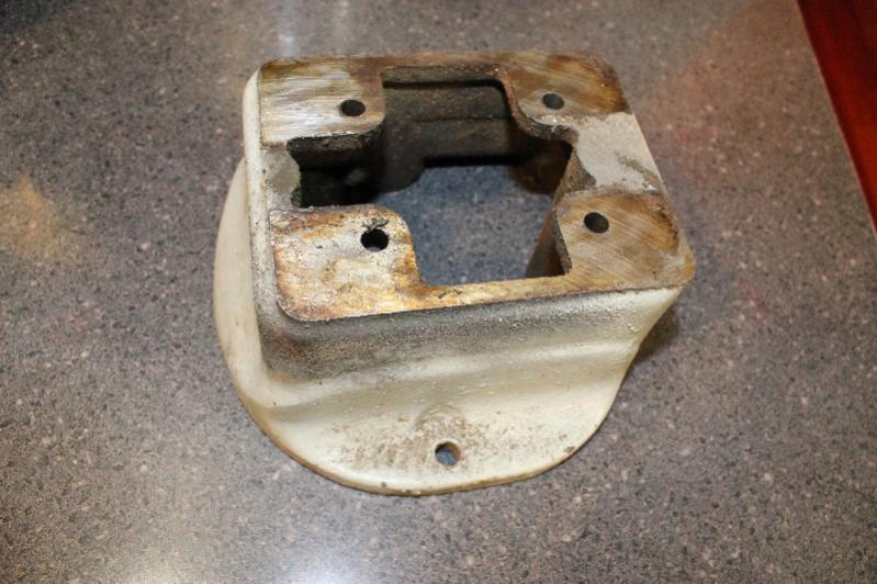

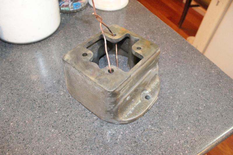

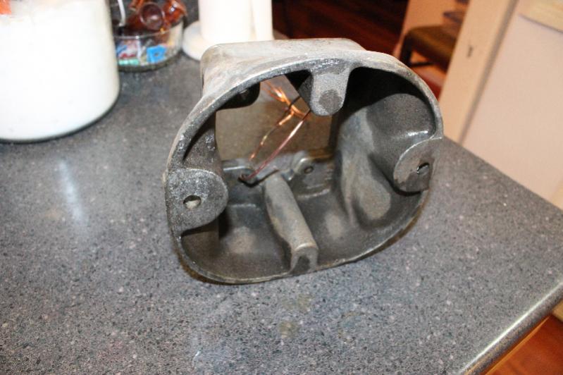

Here are some pictures of my First (of two) Lathe "Foot" that took a dunk today..... 3 hours and 45 minutes, and two quick brass wire brushings inbetween to get the loose big stuff off ... and Ta Daaaaaahhh the before and the after!

Yort81, glad you got the correct info the first time around. It seems like the net is going through the nasty mean people phase sometimes with postings of things that have important info, or bits of info missing.
Like you said it will remove rust, crud, and most paints. Heavy crud or grease build up, might need to be scraped. high dissolved crud in the water can slow down process, plus it does make a bigger mess disposing of the spent electrolytic. It will also loosen some frozen nuts and bolts.
It doesn't work on everything or every type of coating. and you can make your rig as fancy or simple as you want. It will save time and frees you up to do other stuff.
