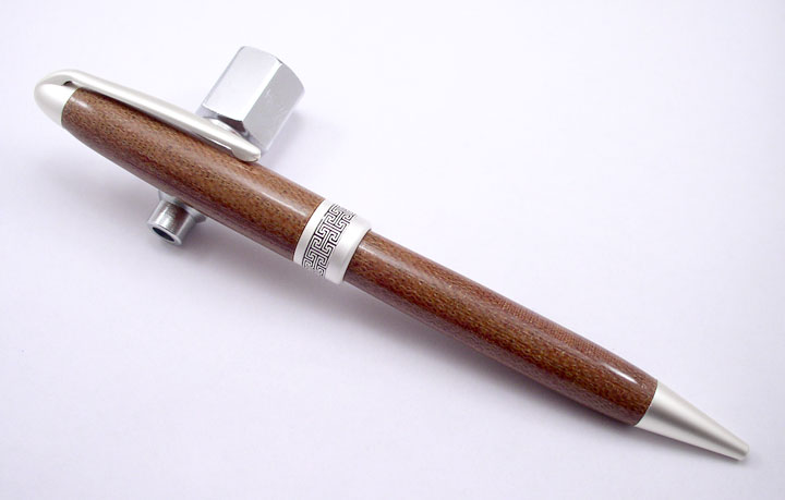

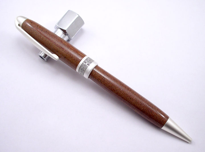

I've seen the amazing work done with antique phenolic resins so thought I'd try some of the contemporary stuff. It's actually shinier than it looks in the pictures. The underlying texture seems to absorb the specular highlights.
This is off-the-shelf Bakelite. Don't know what the fabric wrapping is made of, but HSS tools won't cut it. Had to use carbide. It's probably asbestos or something very abrasive. Wear a mask!

As I've looked around it seems they use linen, cotton, nylon, or fiberglass for the fiber. Yeah, it does smell like the phenol as it heats a little. Don't know why its so abrasive - the HSS tools would only make one pass before being so dull they wouldn't cut.
