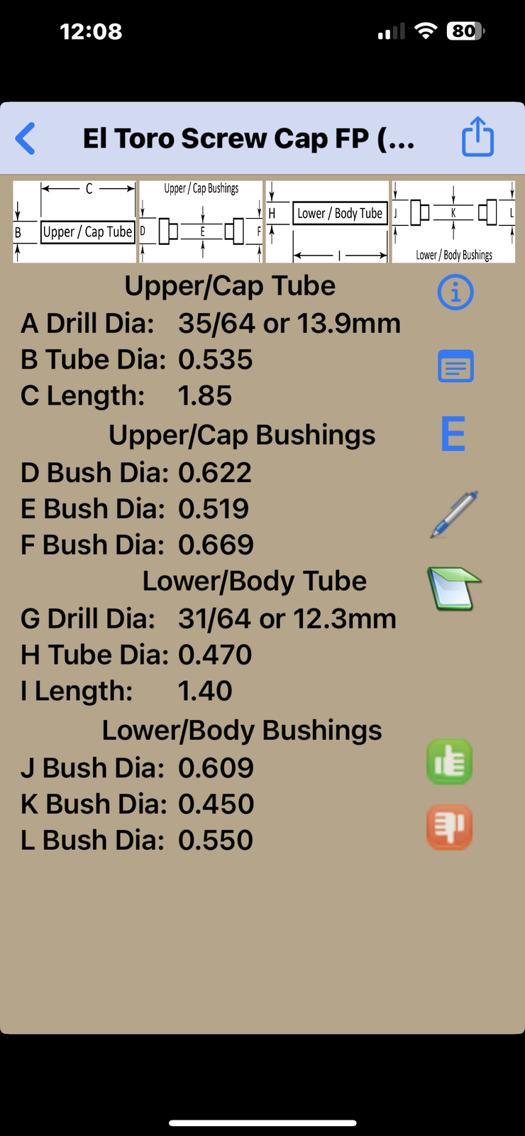

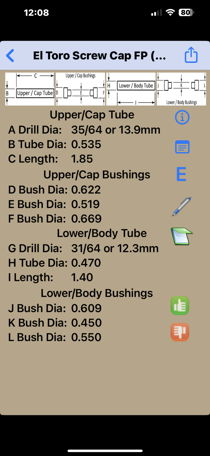

I am in need of the dimensions for the tubes used in an El Toro Kit. I have to redo an El Toro for a friend, the tubes are damaged so they cannot be reused. Require diameter and length. Any help would be most appreciated
Thank you in advance
Here is the info we have in the Bushings & Tubes app database

The ElToro was redesigned in the last couple years. The body tube is now longer than the cap.
The information Edgar shows is the old (and better looking, IMO) data.
However, you CAN cut down the body to the old dimension and the pen will look like it always did, and work fine.
