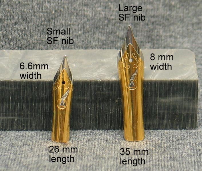

I've never used an El Toro kit but in case this helps....photo shows dimensions of the small & large Heritance (r) SF nibs. Length is tip-tip and width is at the widest part of the nib. Of the pens I've done: The "small" fits Jr Gents, Jr Statesmans and Barons. The "large" fits Cambridge pens.

There are many different sized nibs available but as far as I know of there are only 2 sizes used in any of the kit pens , #5 and #6 . #5 is the small sized nibs used in Barons and other kits that use the small nib and the #6 nibs fit the El Grande and other kits that use the large sized nibs .
Measure the size of the current nib from tip to base and wing tip to wing tip and compare these to those two sizes . Post those sizes here and maybe someone can help . I have several different sized vintage nibs and can compare those . Also measure the thickness at the base where it goes into the feed since there are some differences there as well .
