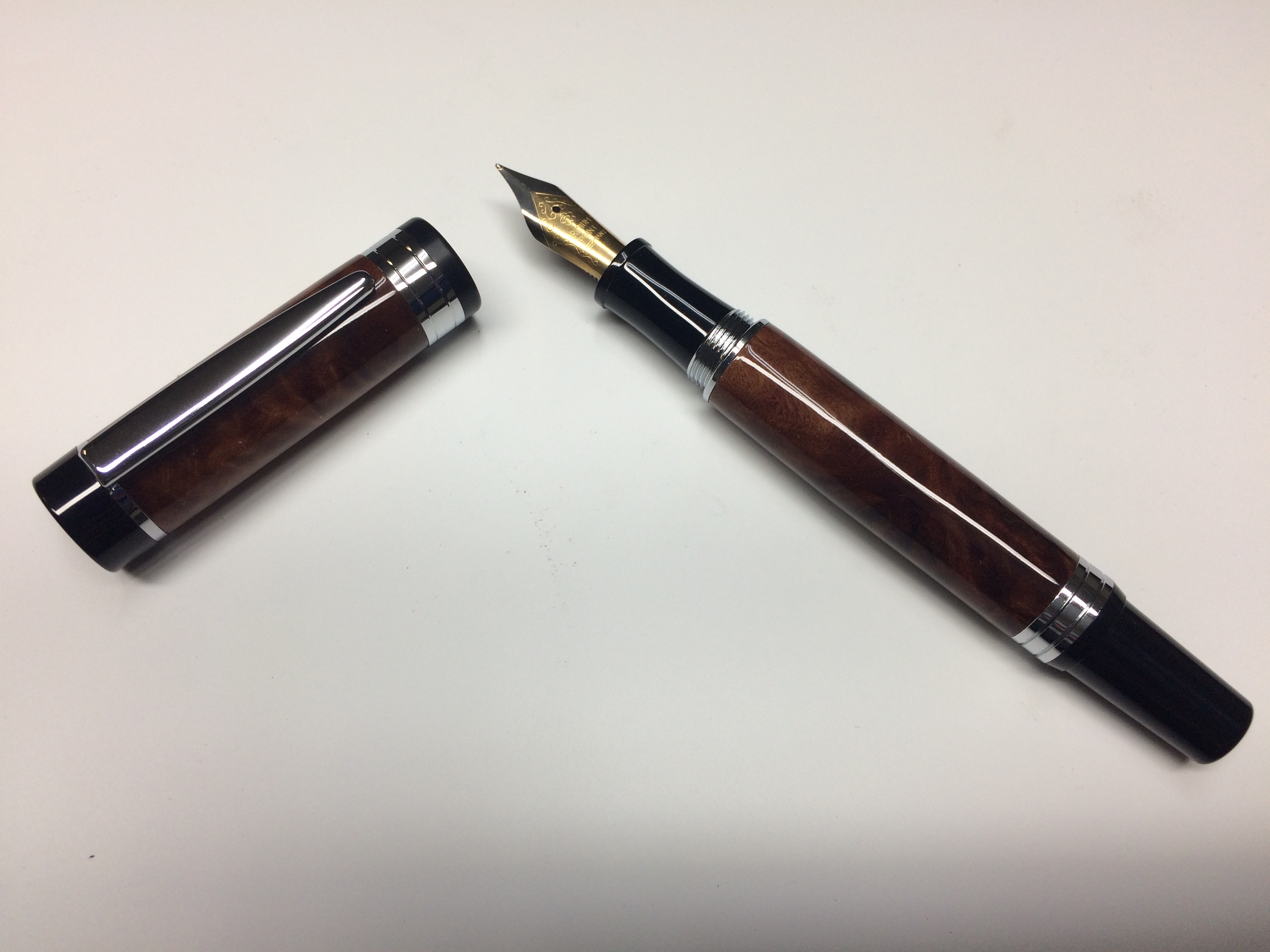

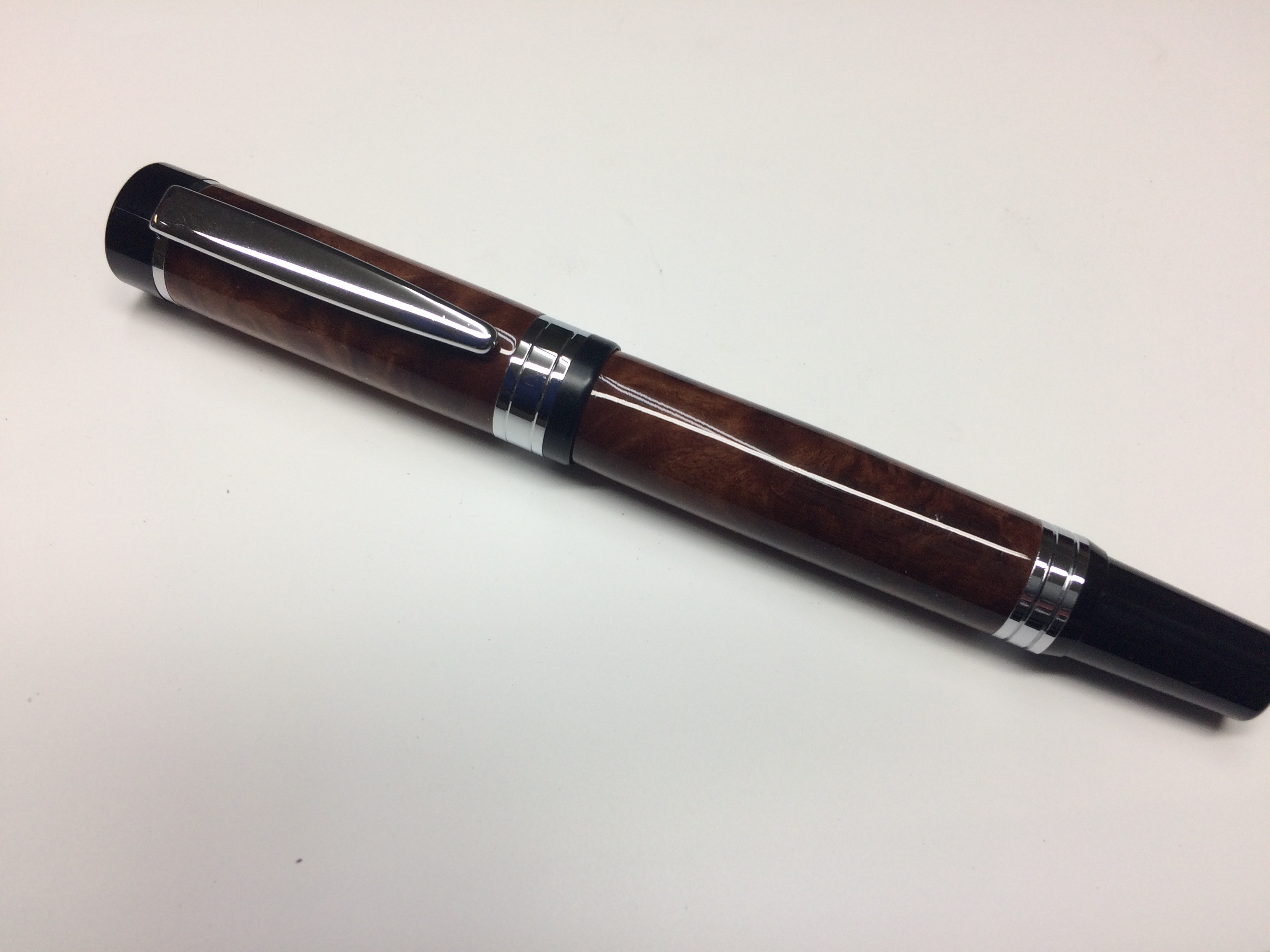

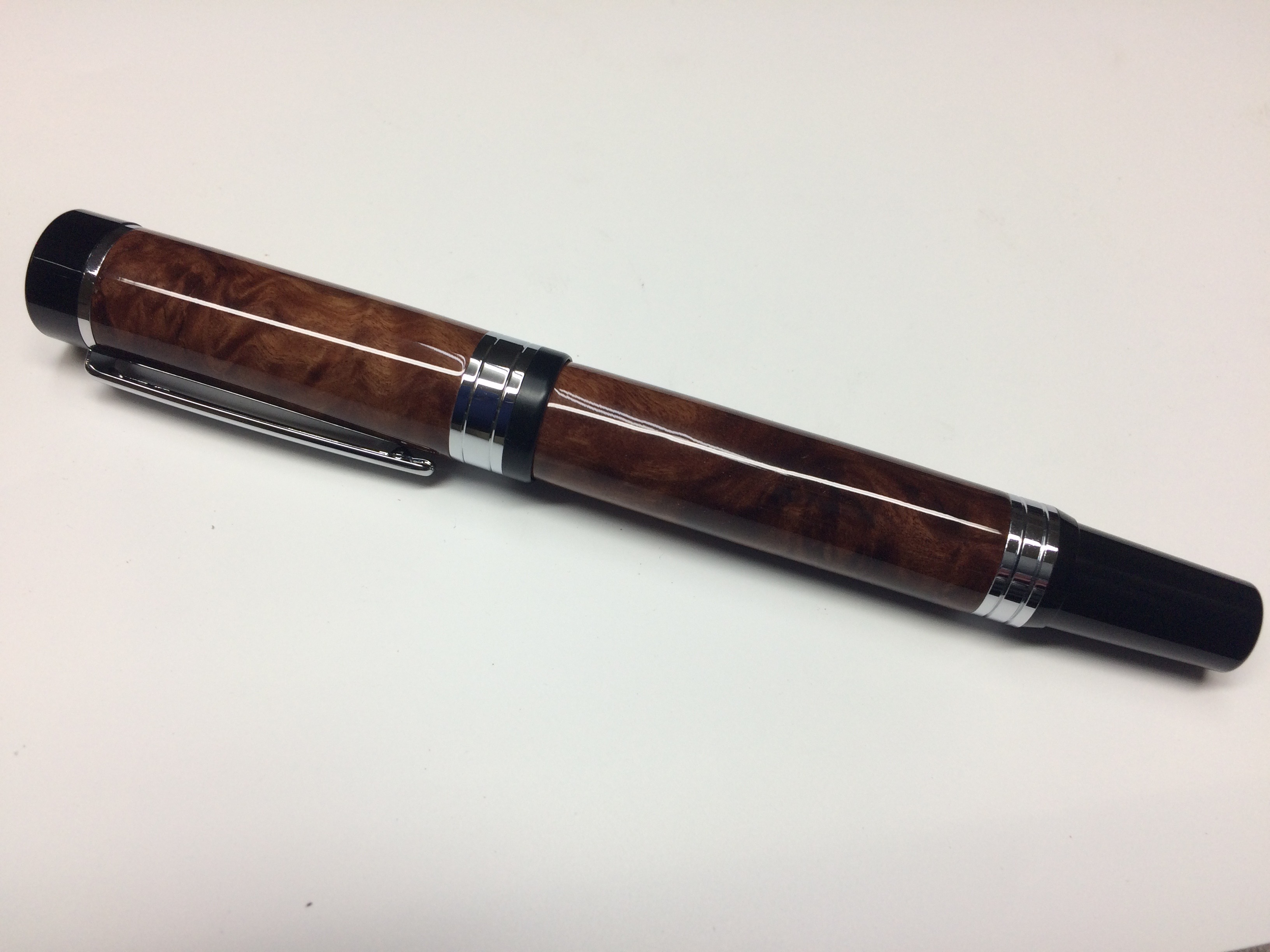

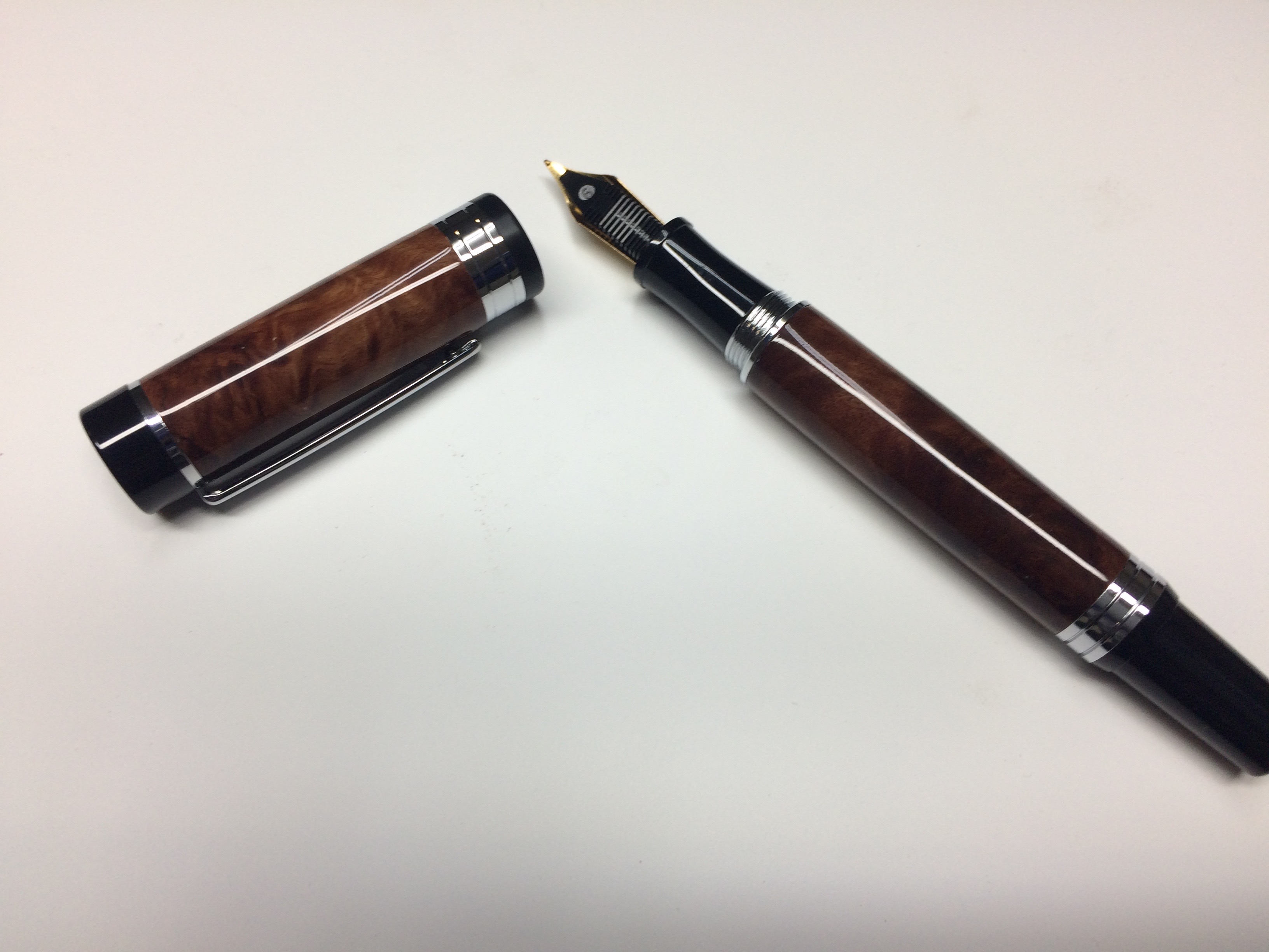

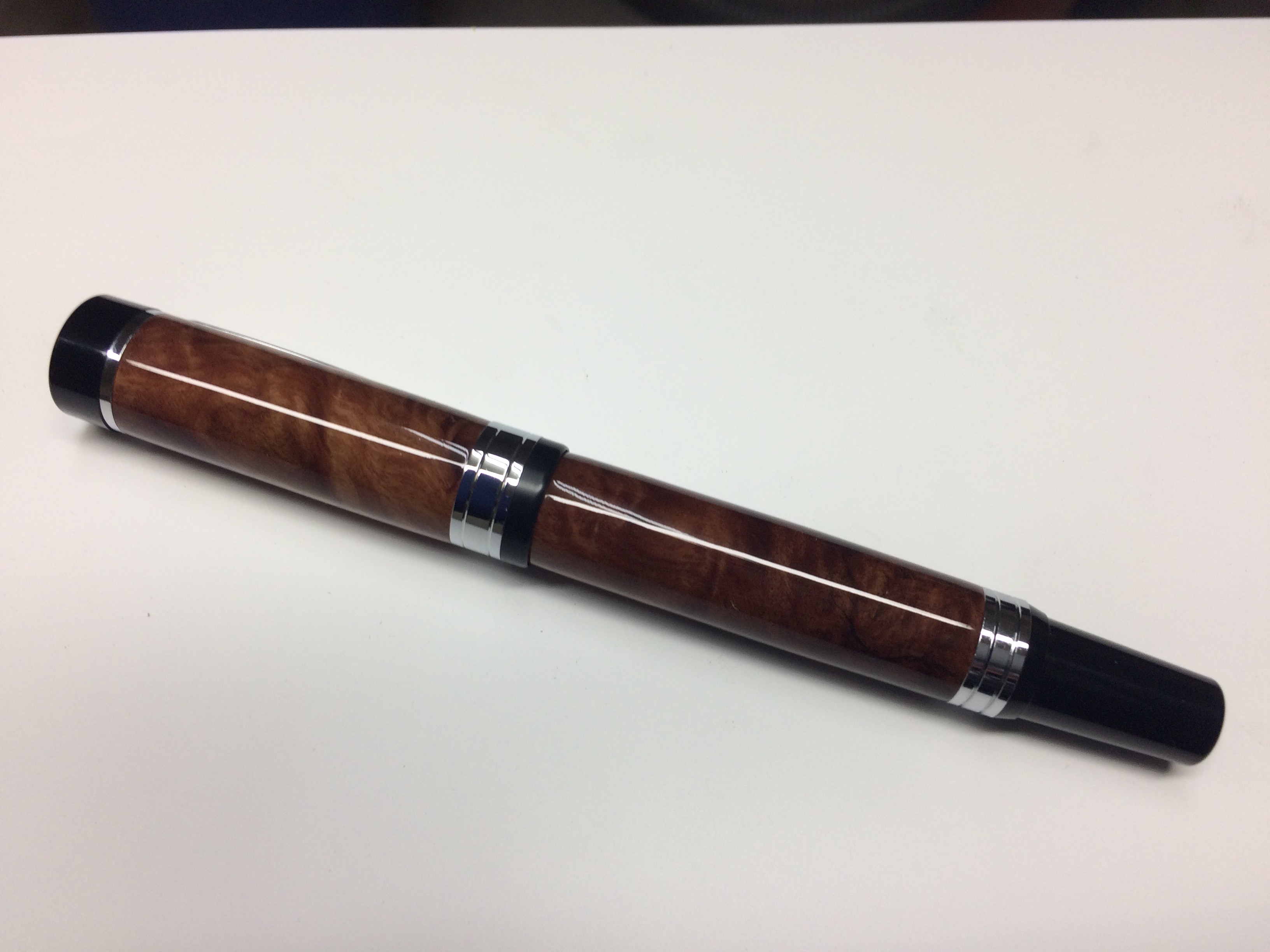

I just finished this to give away at The Nib subforum over at Badger & Blade. I've given away a lot of shaving brushes & handles but never a pen, so I figured it was time. The kit looks and feels a bit cheap, and is very light, but the mallee burl makes it look respectable. I can't complain for a sub $13 fountain pen kit, but I won't be getting another.
I made a thread awhile back regarding how close do you get the diameter of your barrels to size. I'm happy to say that after the CA finish was sanded & polished, the lower barrel has one end at +0.003" and the other +0.001". The cap is 0.000" on both ends which I'm thrilled with, and I thank everyone that replied to that thread for the help.
Sorry for the dust on the pen in the pics, I didn't notice it until it was too late.
