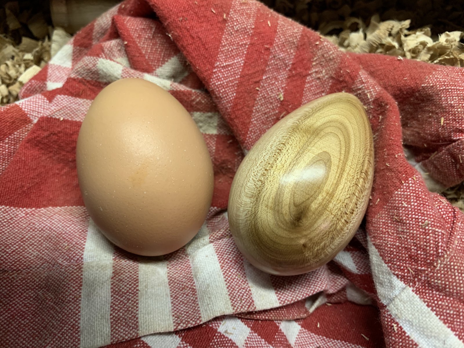

I lathed an egg.

Note: This is a chicken training device, which is why the turning/finish is a little rough. The idea is that you put a wooden egg where you want your chickens to lay (i.e., in a nesting box, rather than on the ground). They like to have communal nests. We'll see if it works.....

Yep, I've used rocks in the past, and they work fine. But I've been wanting to turn these for a while. Nothing is too good for my chickens.

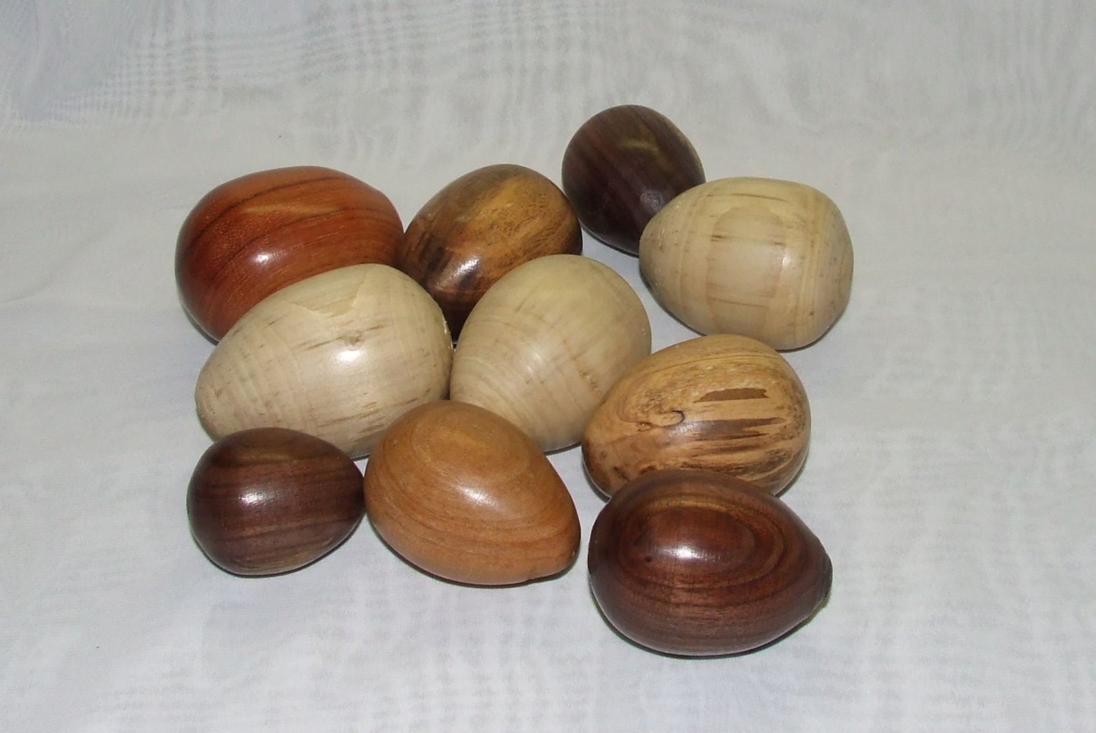

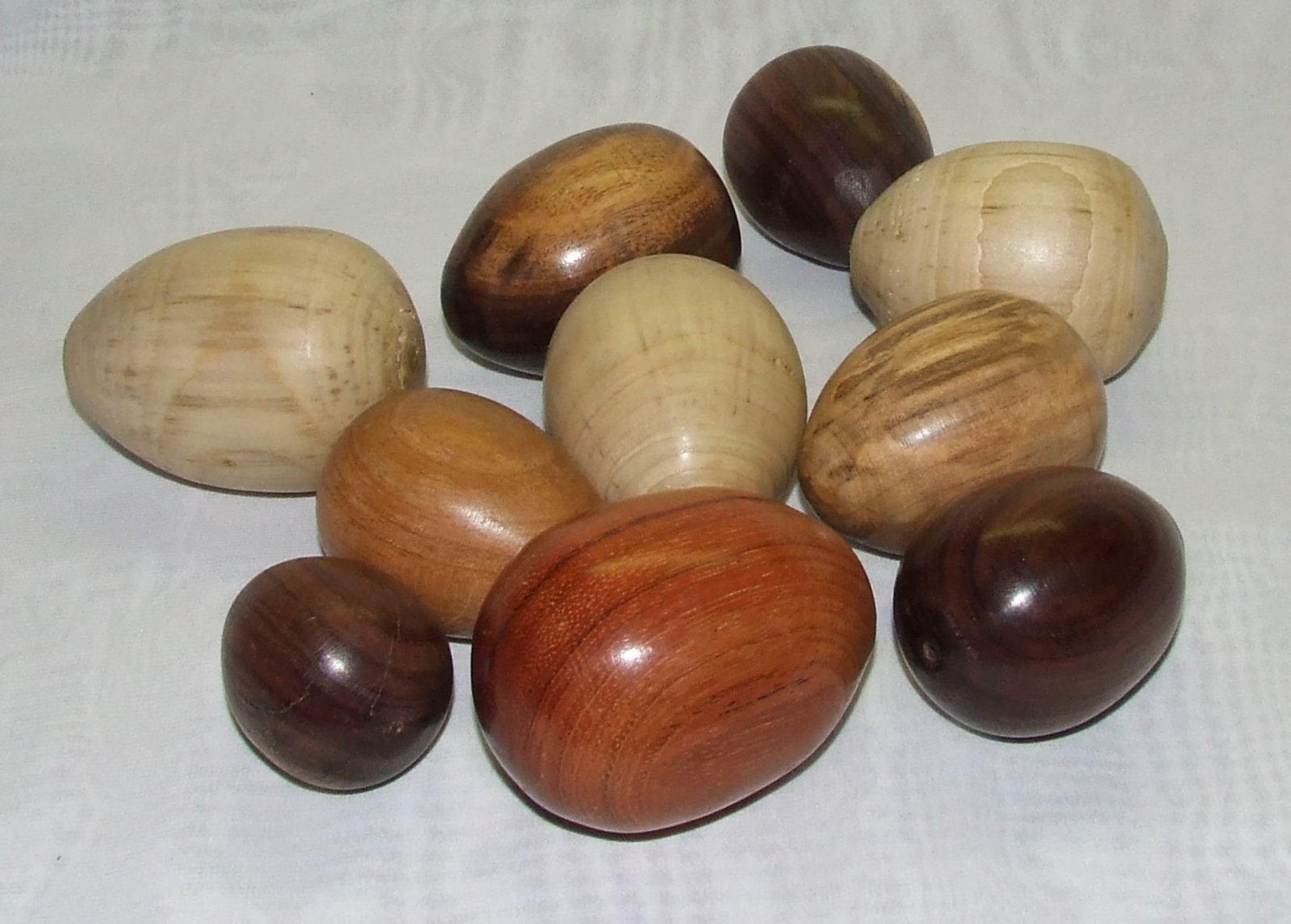

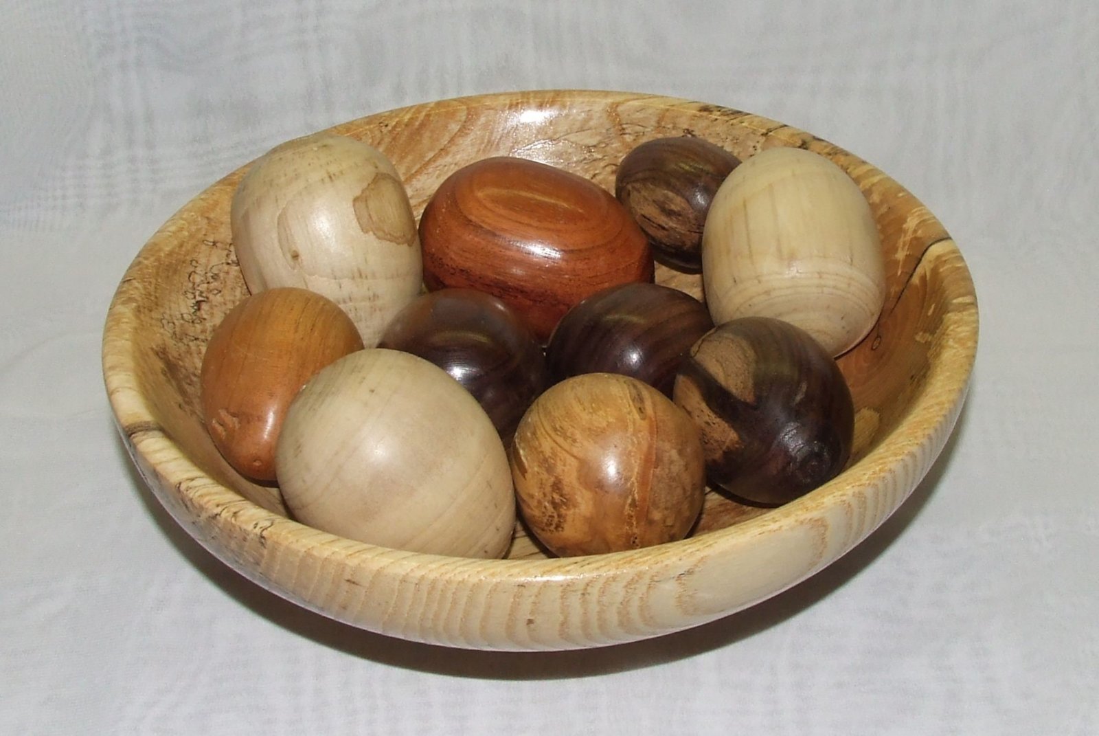

After seeing Jonathan's post of his eggs, thought would be fun to make a few... this is my version.... problem is I didn't get just hen eggs, some are goose or turkey eggs and one is a Bantam egg.

Those look great! How are you finishing them? There is a whole world of decorative egg stands, on Etsy, etc., if you are looking for another thing to spend money on, but your bowl is perfect for them. It's a good thing that there are all different kinds of birds! Certainly, you can find a bird for whatever egg happens to come about.

I just sanded them up as high as I could, think up to 600, then coated them with my homemade version of Yorkshire Grit, a mixture of mineral oil, beeswax and diatomaceous earth, then buffed with Carnuba wax. They are really fun to do, but need to rig up a jig to finish the ends better. I've seen one made from PVC pipe ... don't have the pipe right now and not traveling to shop either.
