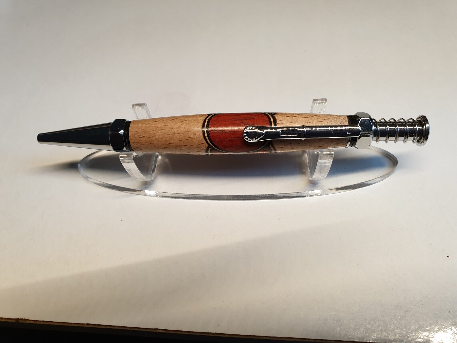

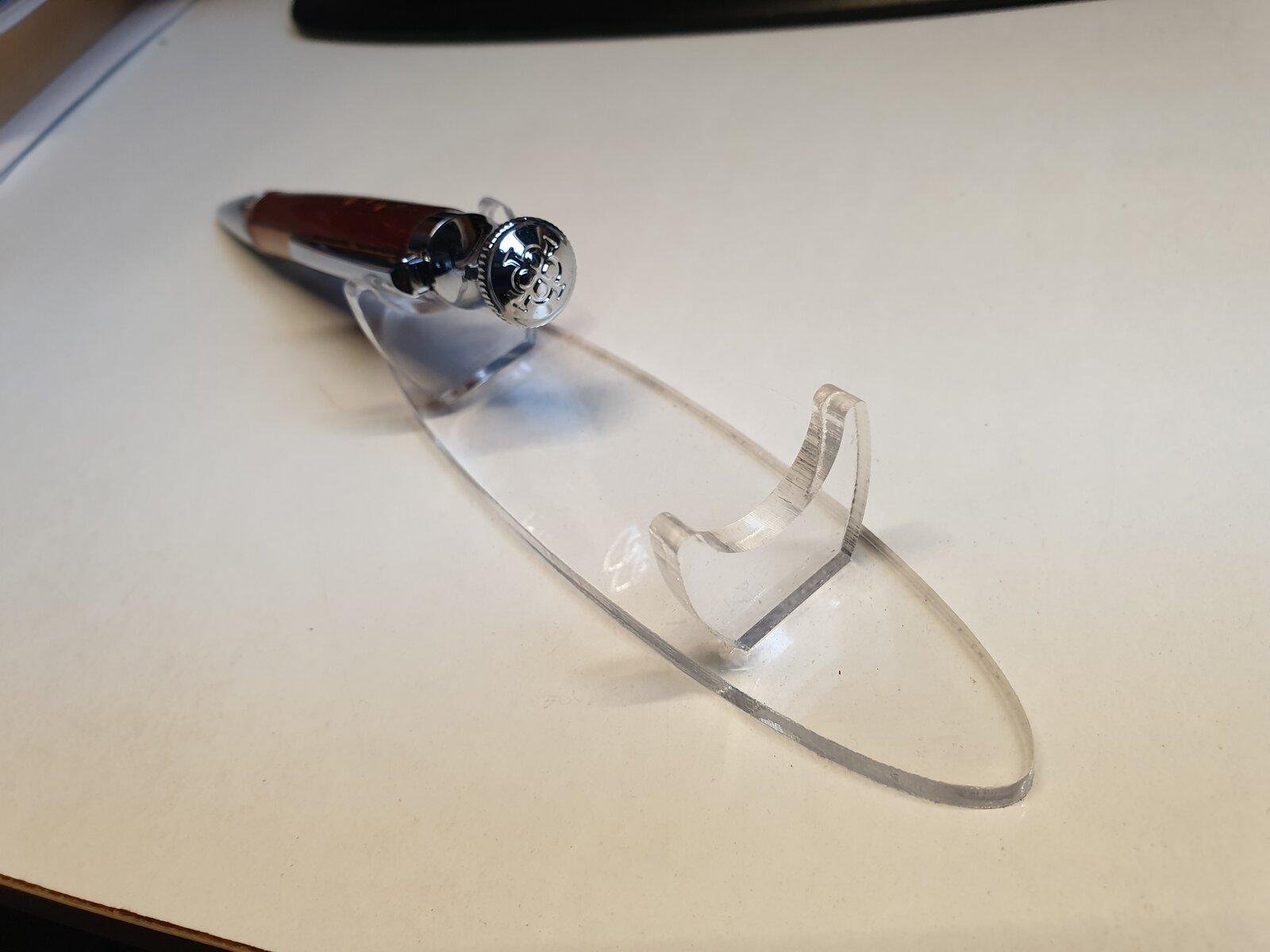

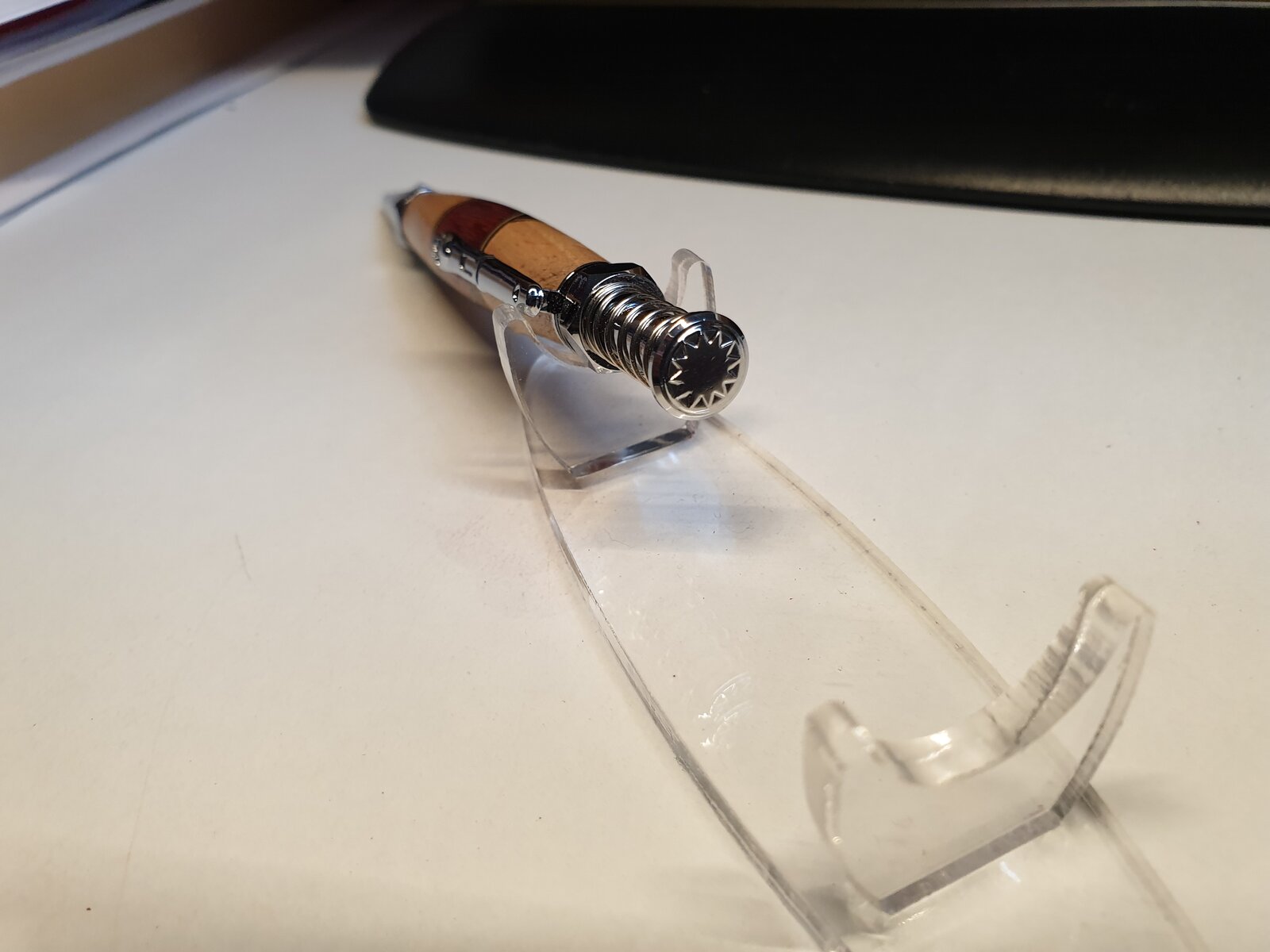

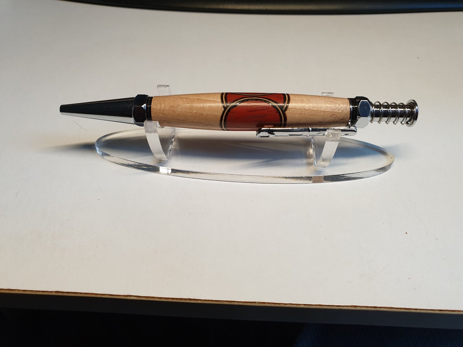

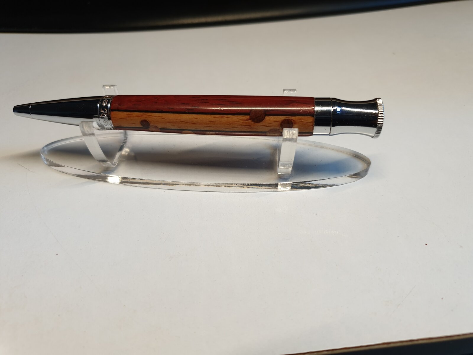

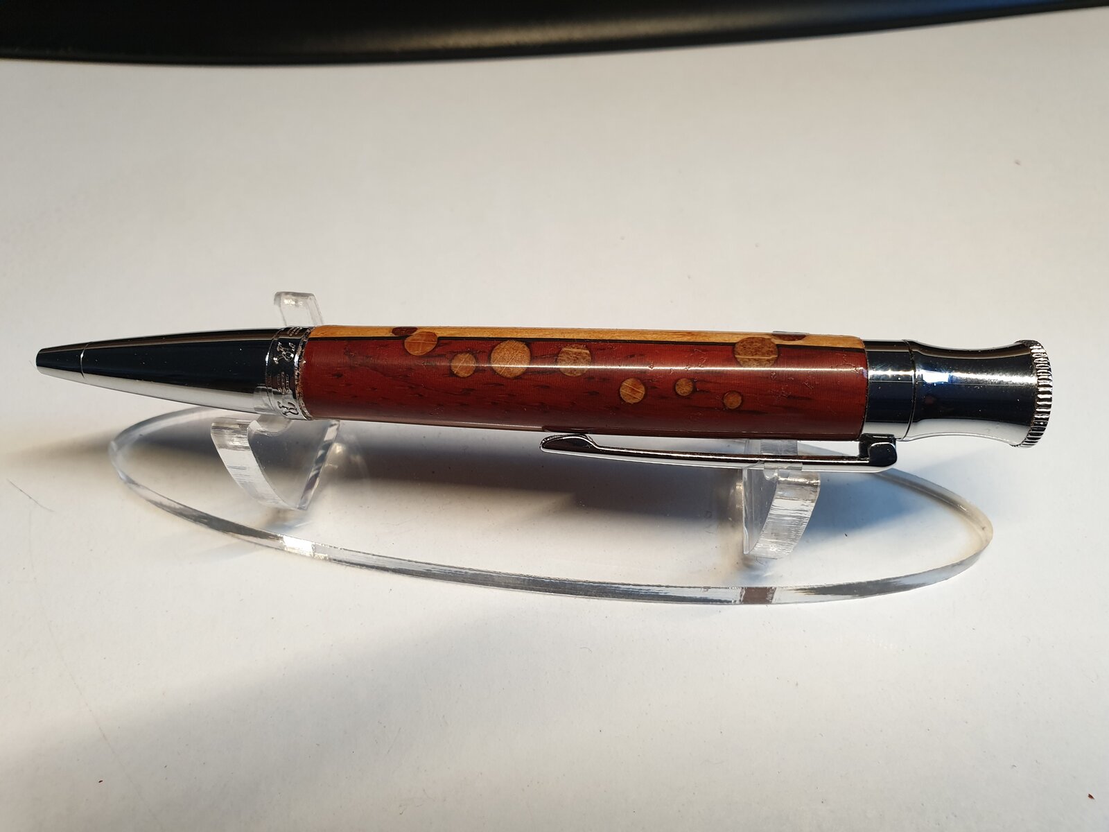

Made some pens with CA finish and EEE wax. I ordered all i need for shine juice and try that also.
I sanded to 600 grit dry, also with the grain, finish with CA, 3 coats thin 4 coats medium, sanded from 1000 to 12000.
The other pen also to 600 grit dry then EEE a few times to sand all scratches. then a kind of white wax, 2 coats and polished.

What is the kit name, please ..... the first pen ..... first 3 pictures ? . . Seems to have a "wrench" or "hand tool" theme.
And where did you buy that kit. . I kinda like it. . It is different.

Hello Sir,
Penkitsmall spanner click RZ-BPCL264 is the official name, $ 2.80
