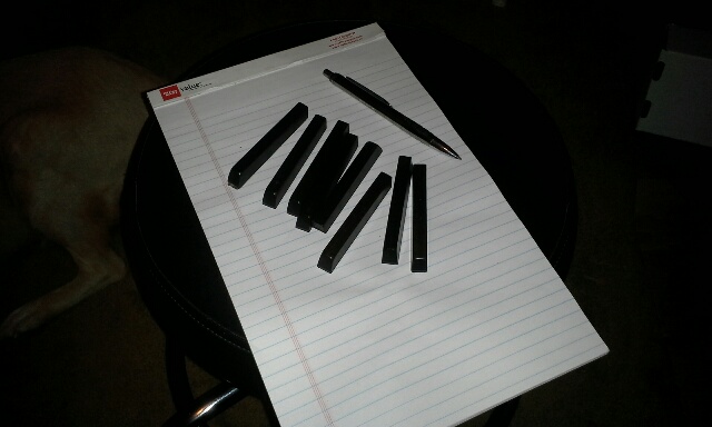

A piano repairman stopped by my shop and gave me some very old ebony piano keys.
I wonder how they could be used in pen making?
Thanks
If you're thinking of making a pen from them, I've tried it--they are VERY brittle and have very little meat on them. Out of seven or eight, I finally got two drilled (on the lathe) w/7mm holes. Made a pen. A week later, both blanks had cracks. I have given up on making pens with them. Perhaps one could cut some laminations or something, and use them that way.
